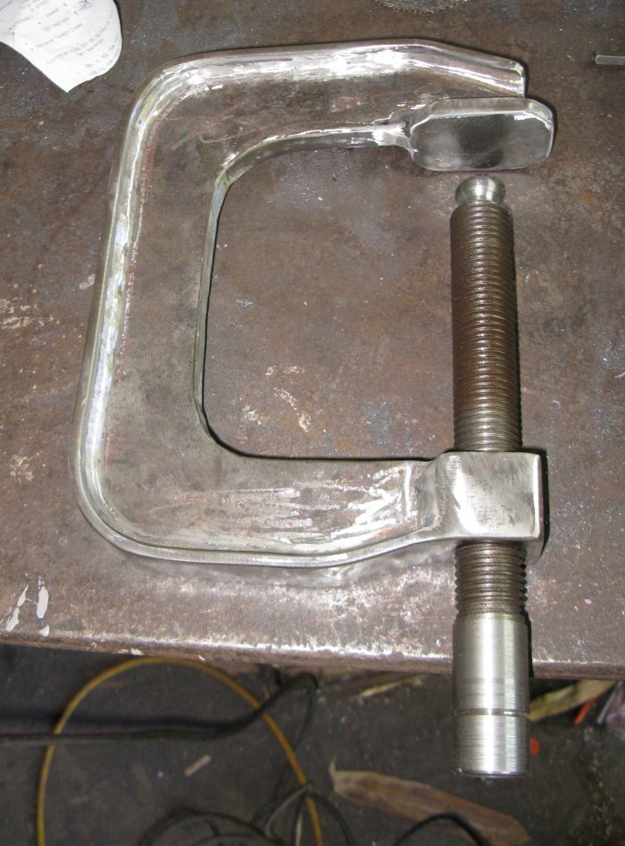

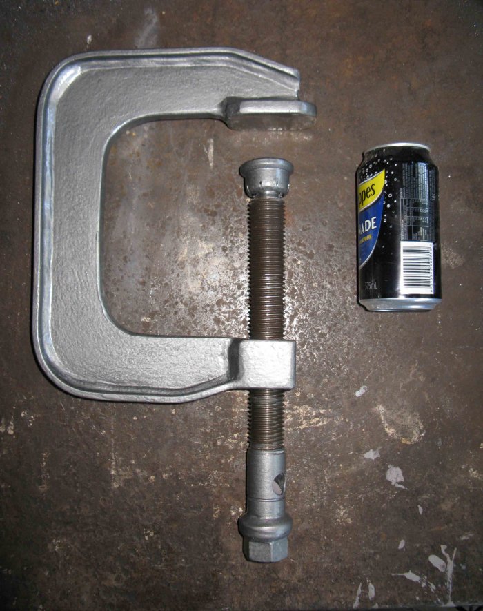

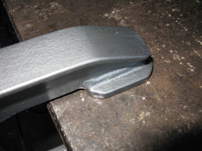

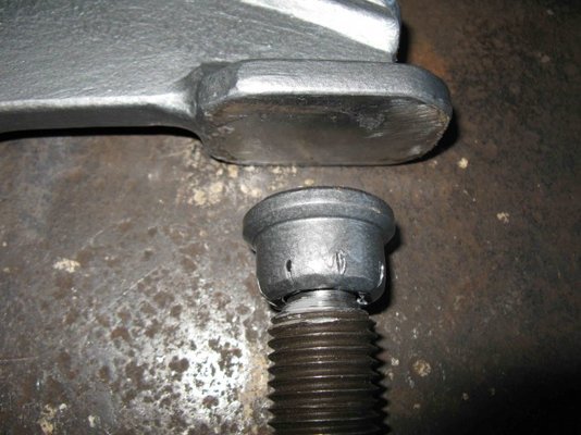

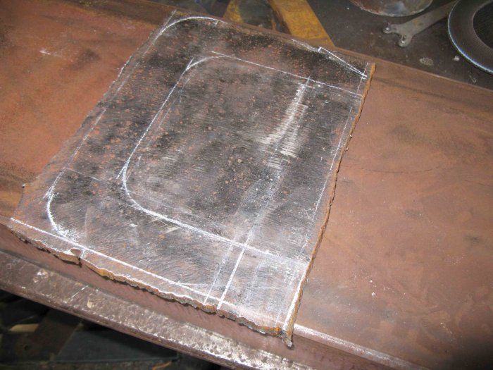

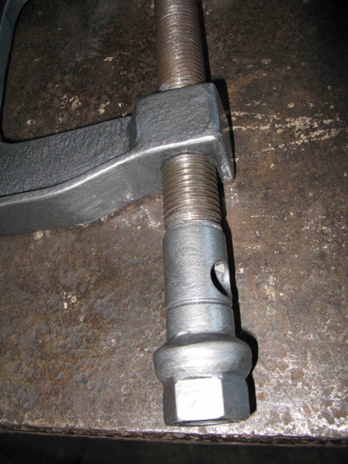

Hi everyone, been meaning to do one of these for ages, I got tired of the flimsy commercial G clamps that are available, there have been many times that I wanted to clamp something to the bench with a bit of force so that the work piece won't move when I need to hit it with a hammer, and if you tighten up the commercial ones up too much they start to twist or self destruct.

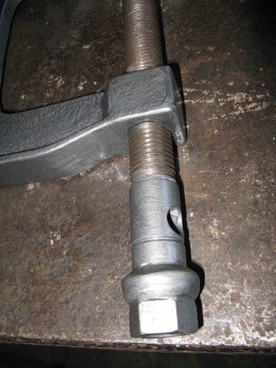

This one should last me forever. Might make another one when I have some more time. Drilled a 16mm hole for the handle, but didn't have a piece of round steel lying around so that will be added later, however I welded up a large nut on the bottom of the screw so I can tighten up the clamp using a shifting spanner.
Unfortunately some of my pics disappeared so only have ones from the raw plate to the welded clamp. Sorry, but it appears that my camera has Gremlins.
Cheers
