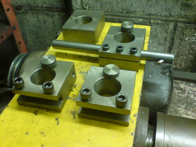

its been one of those jobs that I've been meaning to do for years, but now I've finally got round to making a new tool post for my Hobbymat MD65 lathe. Here are a few pictures taken along the way. I was originally going to make one which has the tool holder clamp about a circular post, but after I started changed my mind and use an eccentric driven plunger, after having a closer look at how normal qick change tool posts work.

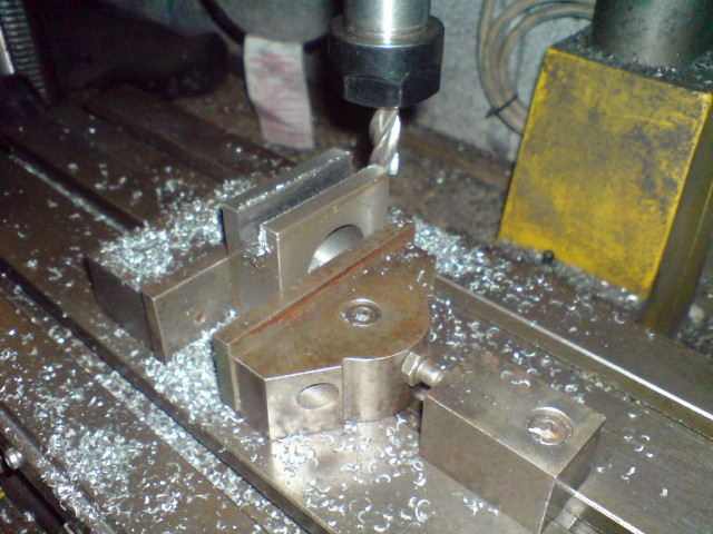

then I started making tool holders from black bar, faced up using a flycutter, in my milling machine using a vice which has jaws which bolt into the T slots, so the vice can be as long as the milling machine table

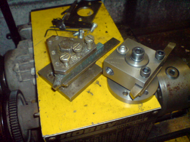

then milling the slot for the lathe tools in the tool holder

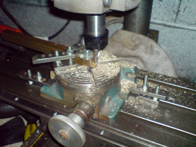

I ended up milling the end of some square brass on a rotary table to match the radius of the tool post, and lucky for me the post is 25mm diameter which is the same diameter as a 5mm penny washer, so one was used as a template. this hole was later bored out so the eccentric would work in it, and then turned in a 4 jaw chuck so that it would fit into a hole in the toolpost

and the assembled tool post

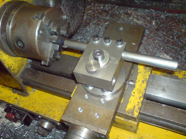

and with a tool holder, the height is adjusted using a flange head cap screw and the tool holder is locked/ released buy using the cap head bolt on the end of the tool post.the tool holder is just under 50mm x 50mmx 25mm
