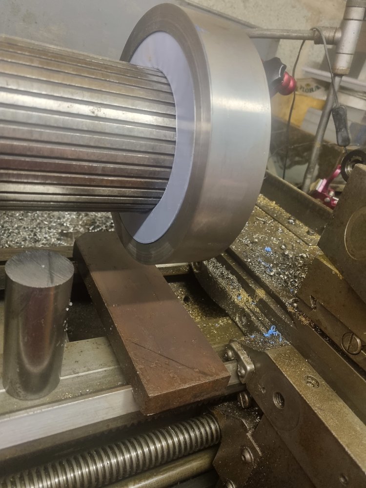

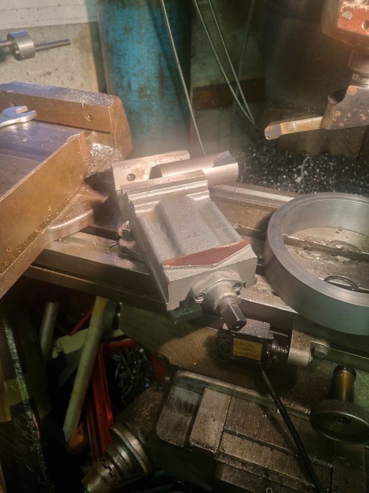

Well I was like the Hoky coky today. In out and shake it all about.

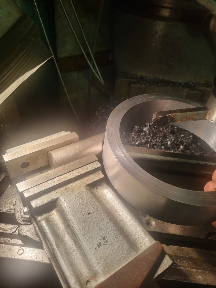

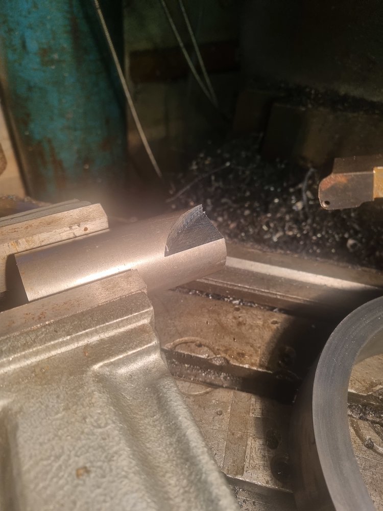

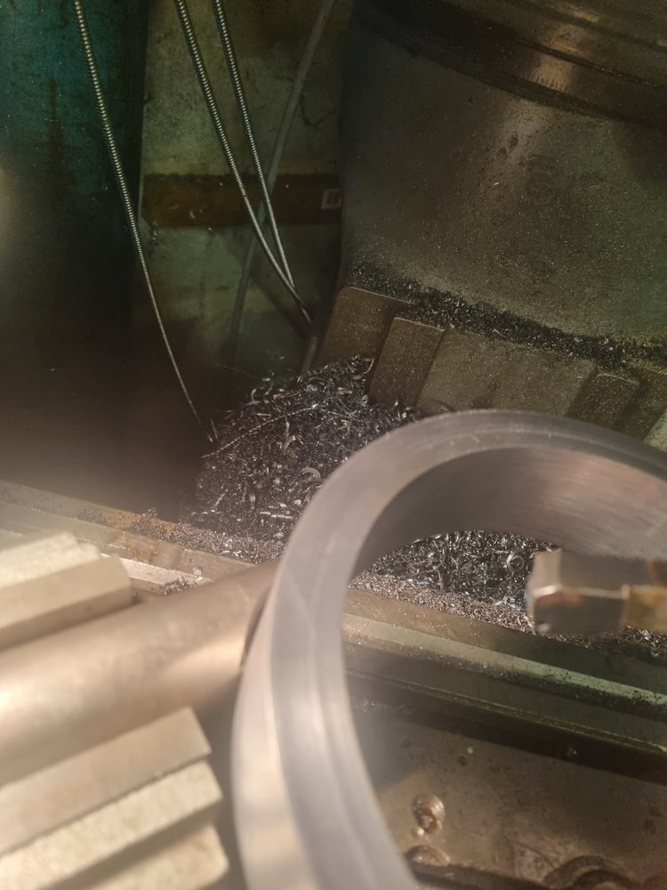

I tried various methods but the quickest was shell mill vertical down 0.5mm cut. (Lots of them).
Then a reground flycutter as it was hitting the work piece before the tip. (Or it would of) lol

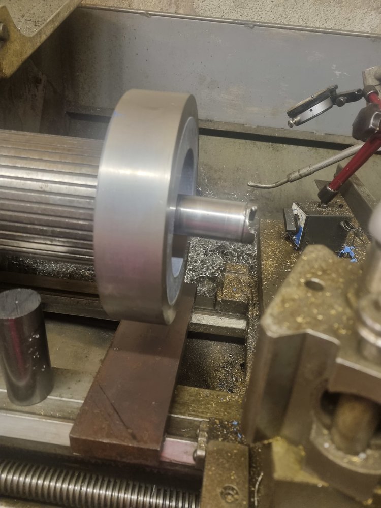

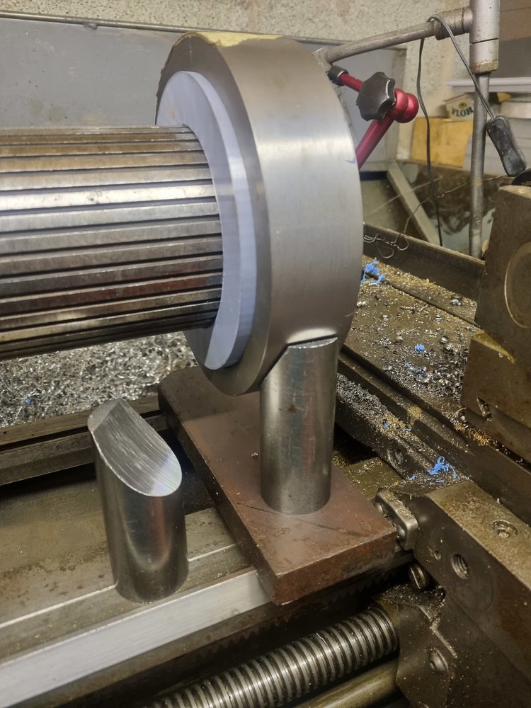

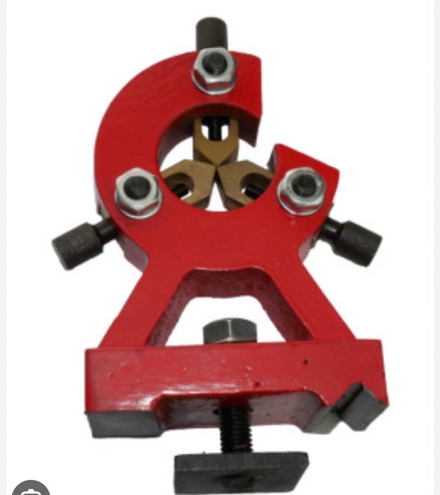

Come out quite well. But if I was doing it again I would have shorter legs with the bottom of the leg angled and the concave part closer to the top of the leg. I say this as the pins need to go through the legs to be equal distance between all three points.
Anyway I have to collect some top kits for my fishing pole tomorrow so something for myself at last...lol
