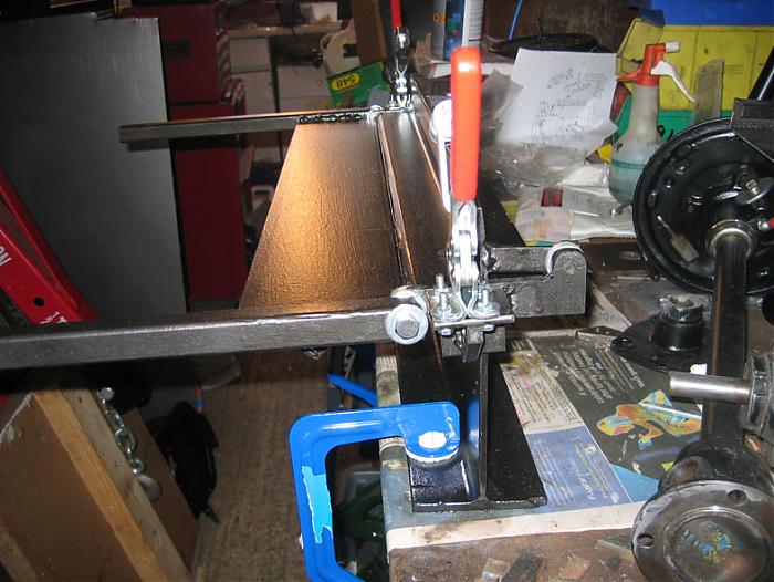

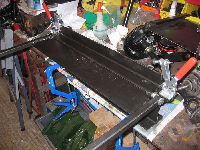

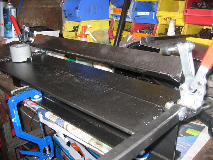

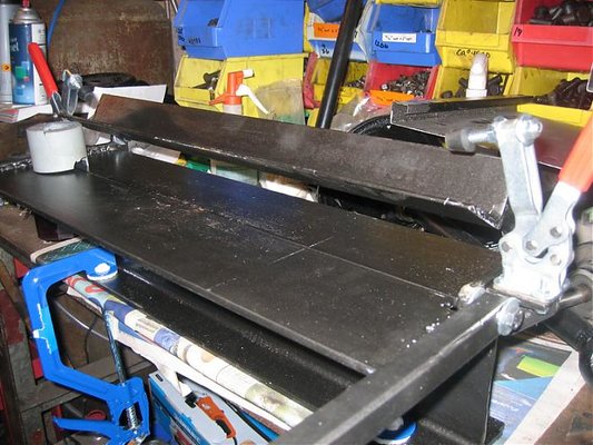

Hi all
Just finished my second project, a sheet metal folder. It's based on the Dave Gingery plans but using odds and ends I had knocking around the garage. Because I didn't stick exactly to the stock suggested in the design I ballsed up with the clamping mechanism and didn't have enough room to fit it in, so have used a couple of toggle clamps which seem to work well. Only really going to be used for car bodywork etc so the clamp pressure should be OK.

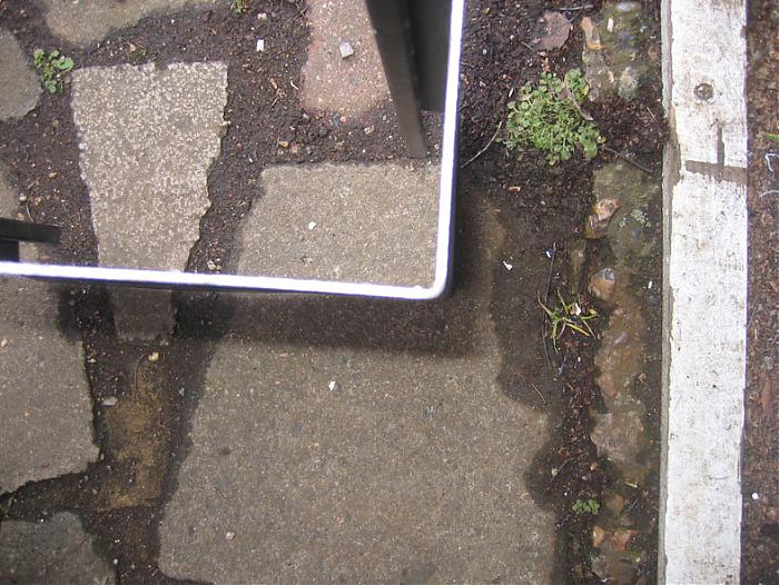

The radius on the bends isn't as tight as it probably could be but it will do for my needs. (The sheet in the last pic is only about 1.2mm thick)
Overall I'm pretty pleased with it although you'll notice I haven't taken any close ups of the welds as they're none too pretty
