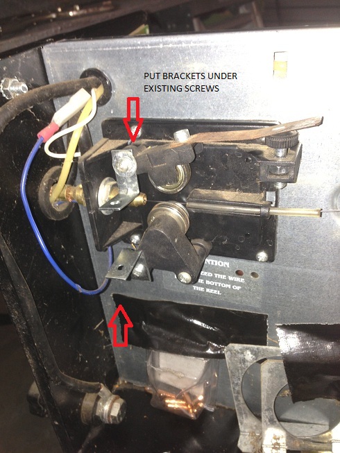

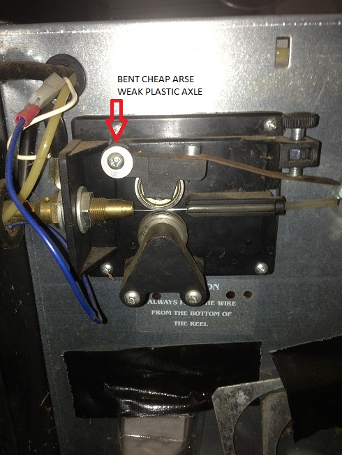

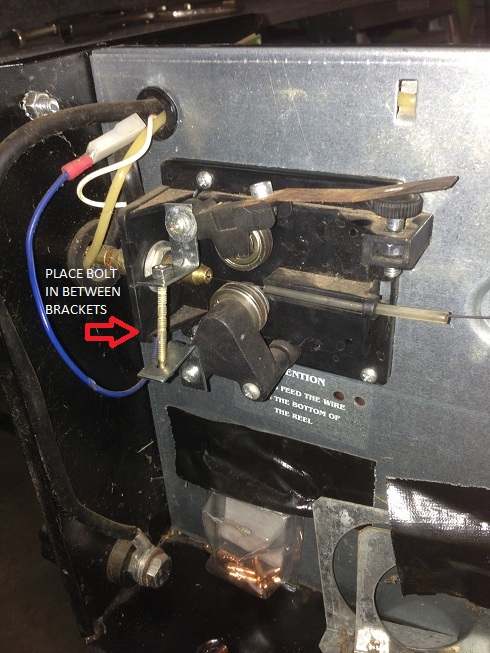

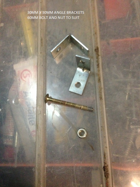

Hi fellas, I'm a first time poster. I bought a second hand SIP t150p with the usual wire feed problem, and was about to solve the problem by throwing the welder into the ocean. I should have known that something was wrong by how fast the guy who sold it to me drove away - it's the first time I've seen someone do a wheelie in a 4 wheel drive.
Anyway, I found this forum, and darrencambs solution to the problem, as per this thread:
http://www.mig-welding.co.uk/forum/threads/sip-cosmo-wire-feed-solution.3993/
I was a bit dubious about doing it Darren's way because I couldn't be bothered working with enough precision to make it work, so I hunted around until I found something that would work, that wouldn't require cutting/drilling/measuring.
The way I went about it isn't as pretty, but seems to work just as well. Plus it took about 2 minutes, which is always nice, and required no special skills apart from turning a screwdriver.
In short, the difference between my way and Darrencambs way is that Darren uses a flap of metal as a brace, while I use a bolt, which thus allows you to adjust the tension of your impromptu brace by turning the nut until your problem goes away. Both work, so it's a matter of preference and how much time/skill you have.
Much respect to Darren, thanks mate, I was going mad
