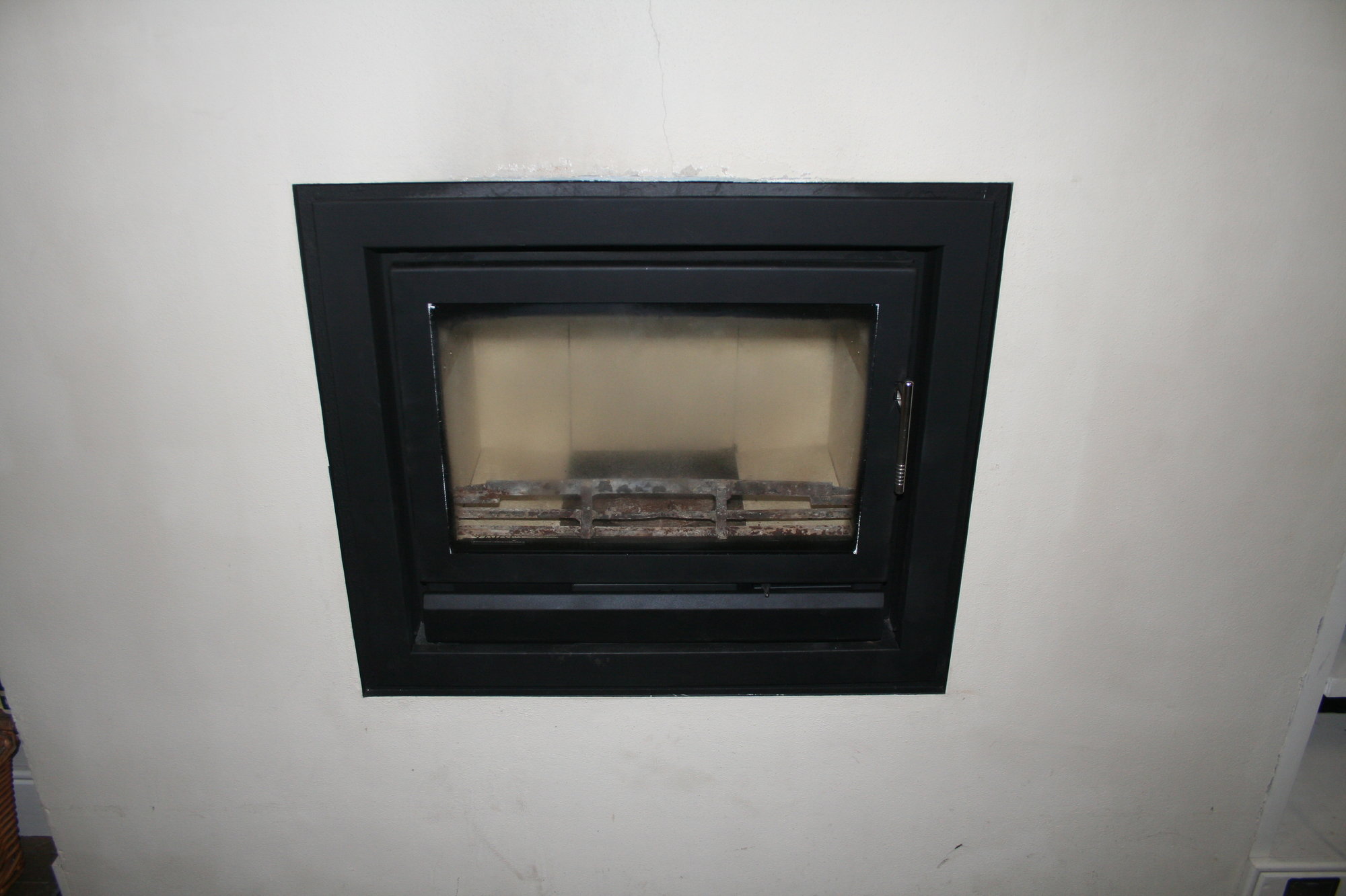

I've a Stovax Riva cassette stove that's built in to a wall.
It's in a room that doesn't get used all the time so hasn't had a huge amount of burning but it must be over 10years old.
It's been great and gives little trouble, I get the chimney cleaned once a year and the only maintenance it has had is a couple of sets of home made baffles.
Towards the end of last winter I knew it needed baffles but I didn't get around to changing them, we just kept using it.
I had been meaning to sort this all year and with the winter really starting to hit and after seeing a post by @Shox Dr on the same stove, I decided I couldn't put it off any longer. Also SWMBO was rightly getting a bit fed up with not having a working stove in the room.

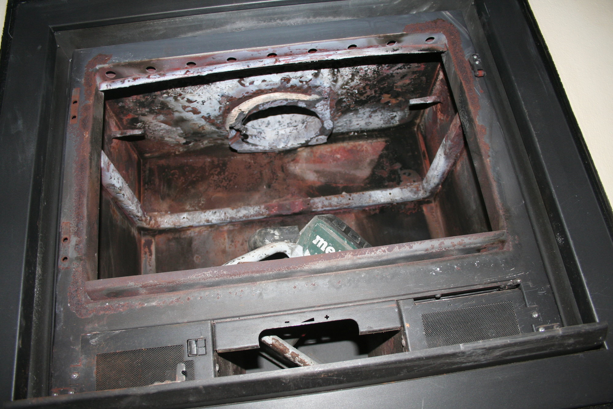

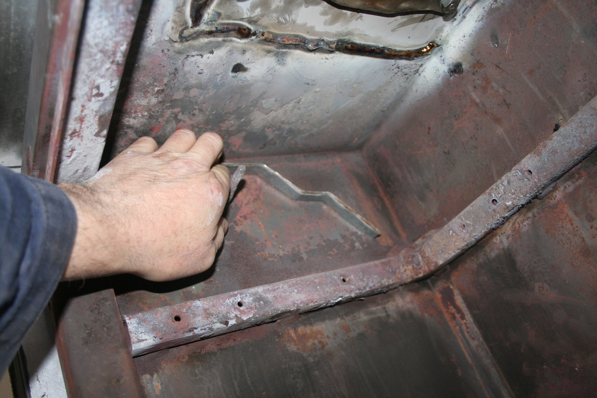

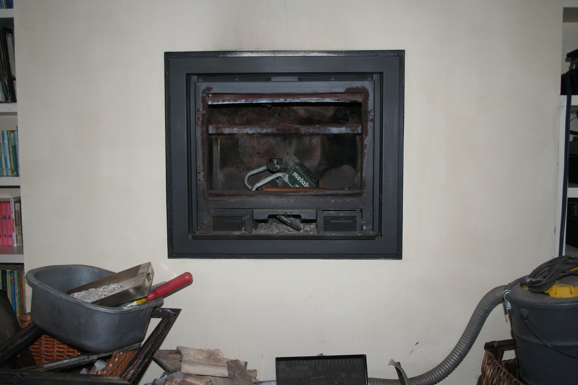

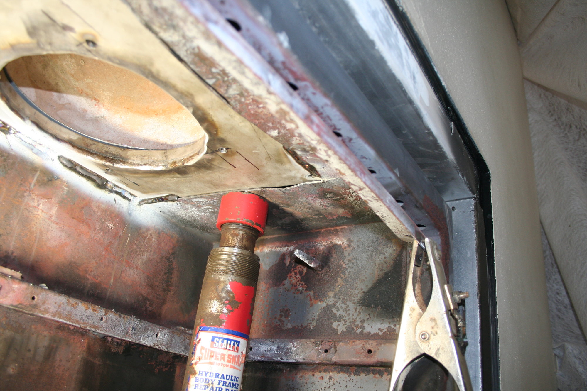

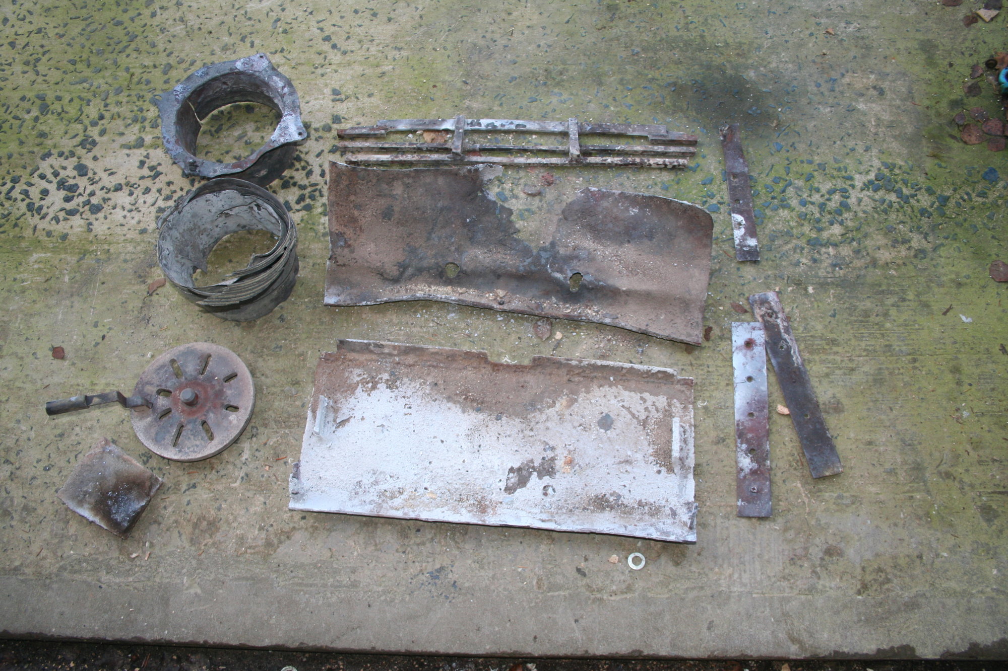

I didn't think this would be so involved so I didn't take any photos before I started, but this is the sad state of it after I started to take it apart.

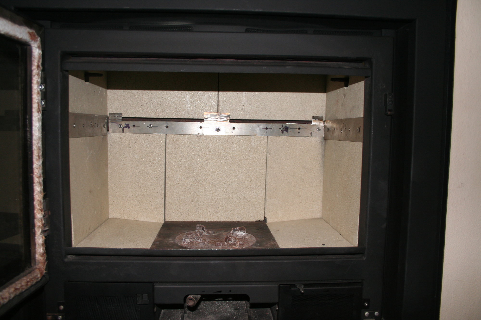

Door off and fire bricks out.

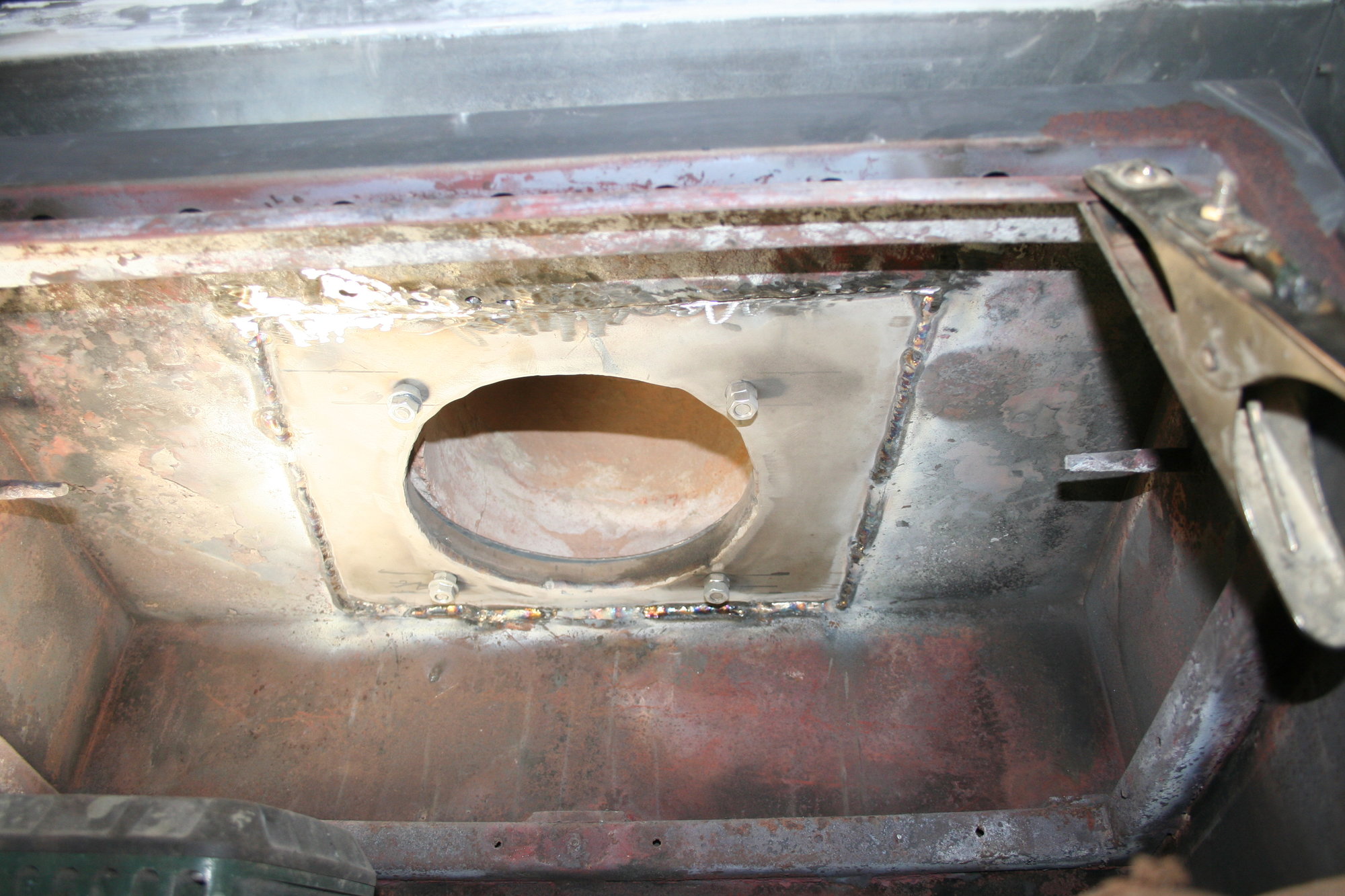

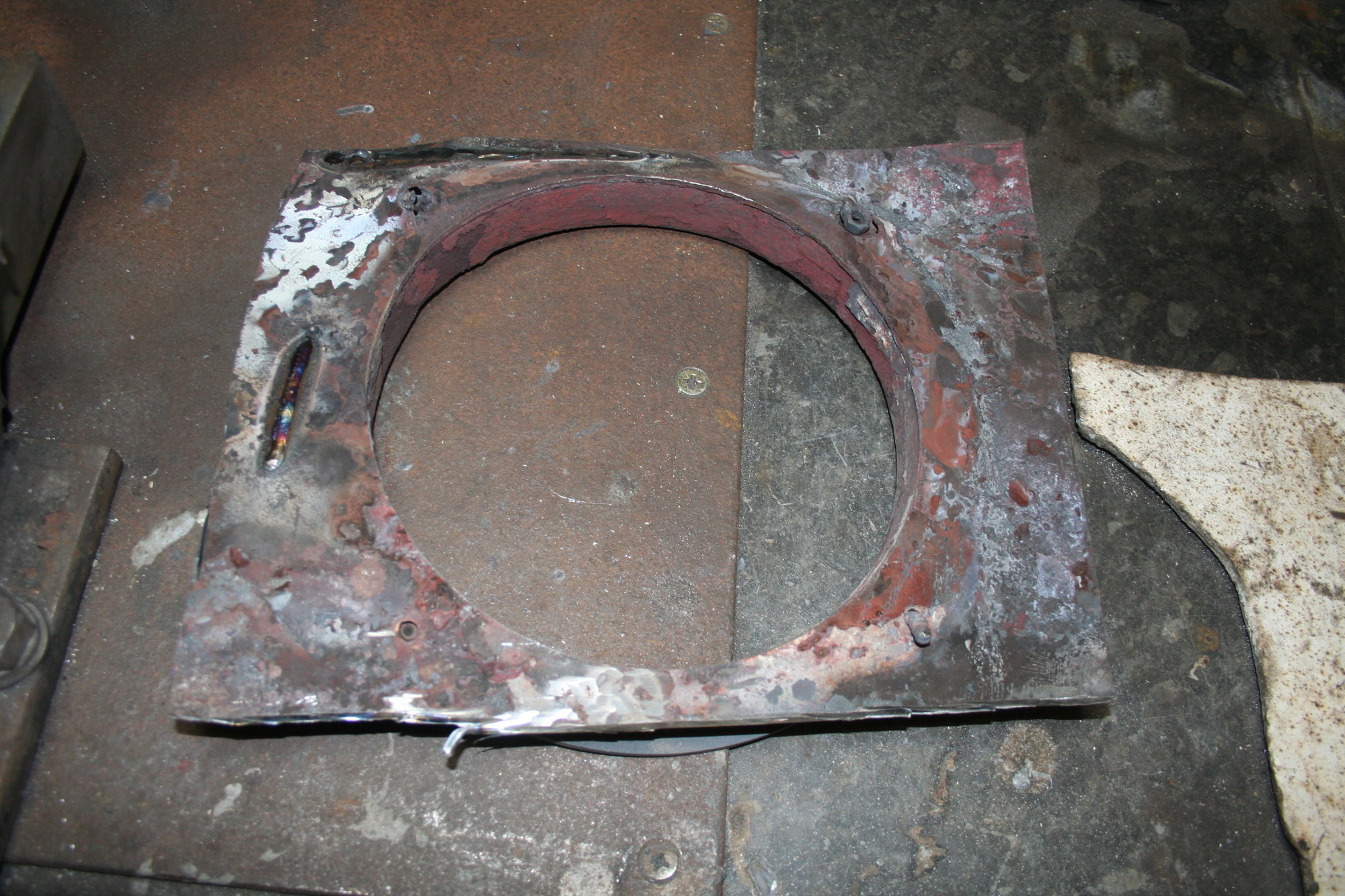

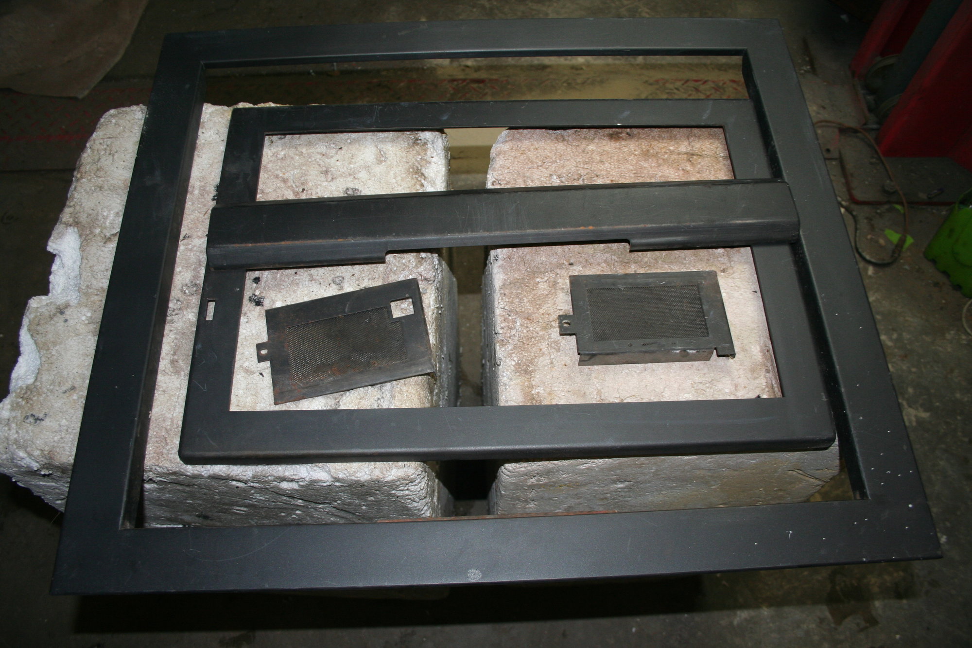

Baffles had certainly seen better days but the top of the stove where the flue enters the chimney was also totally burnt out, as was the start of the flue liner.

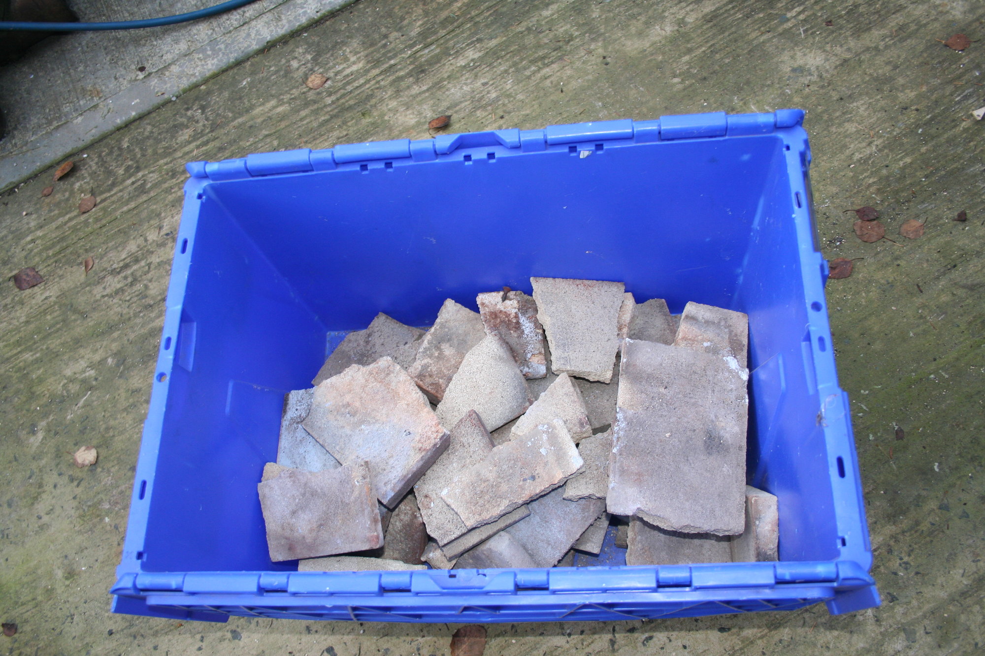

Whats left of the fire brick

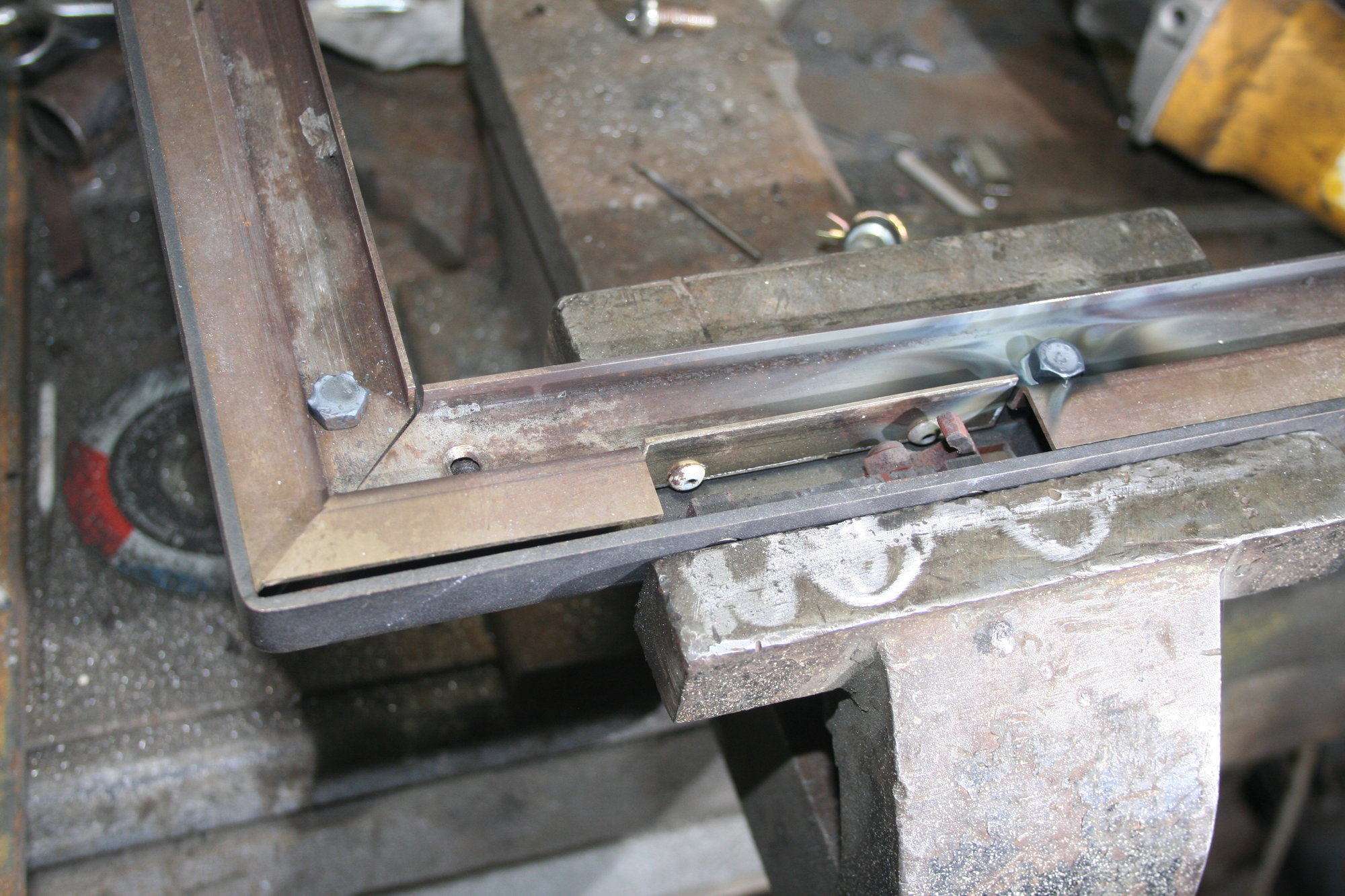

I thought about removing it to replace (or repair) it but decided to see if I could fix it in place.

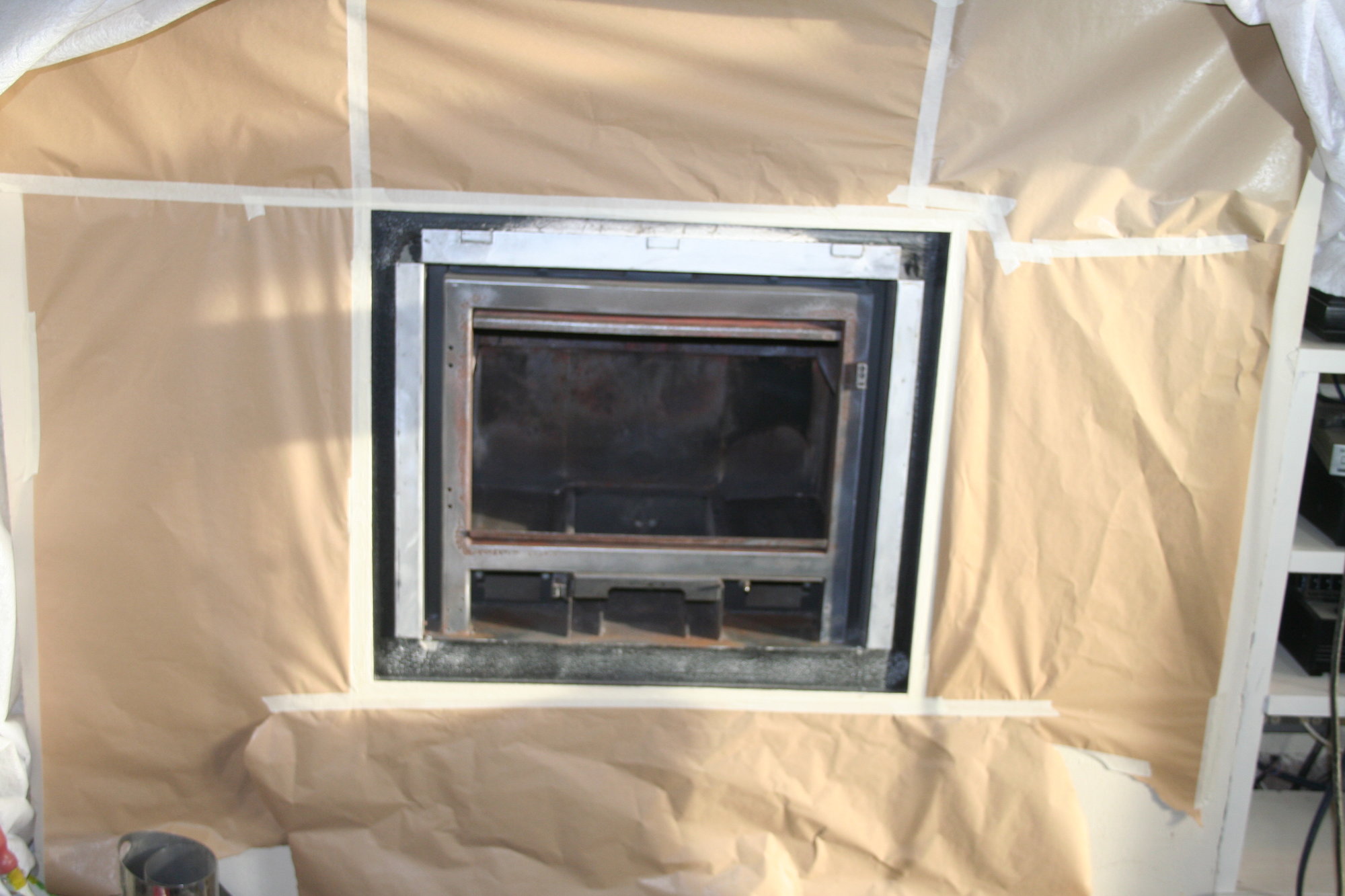

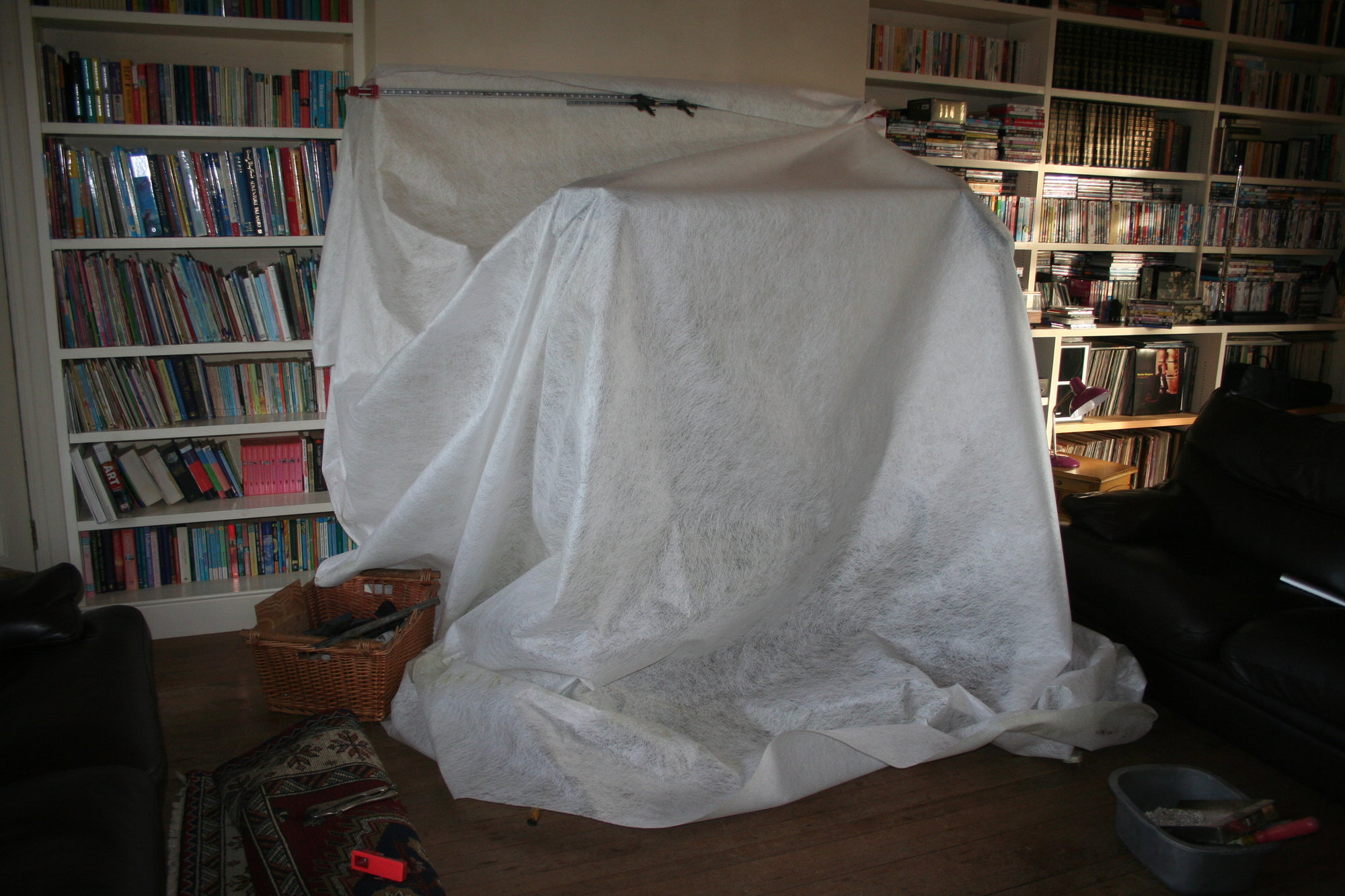

To try and reduce the amount of dirt and dust escaping I fixed some Terram geofabric to the chimney breast with sash clamps.

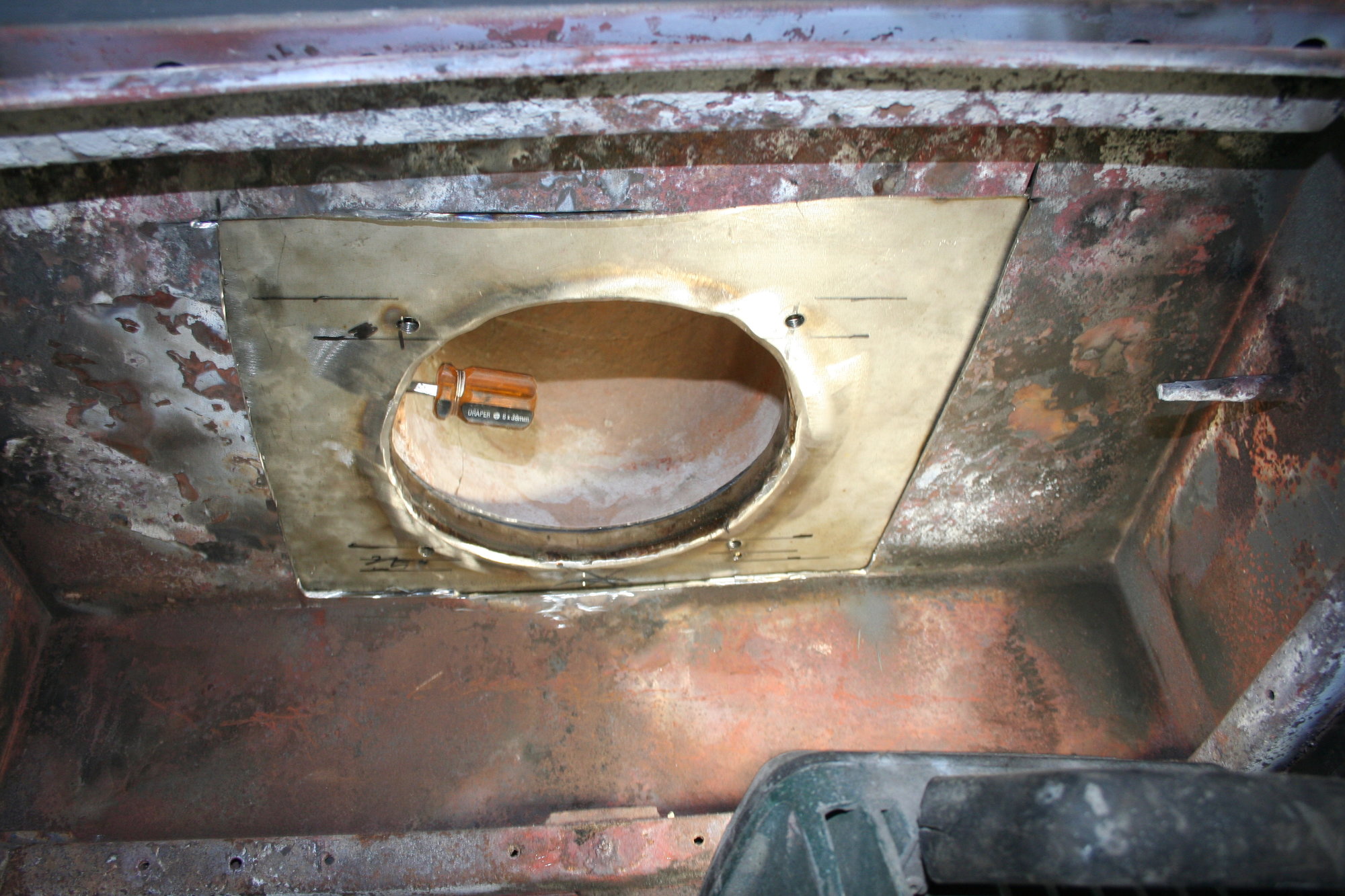

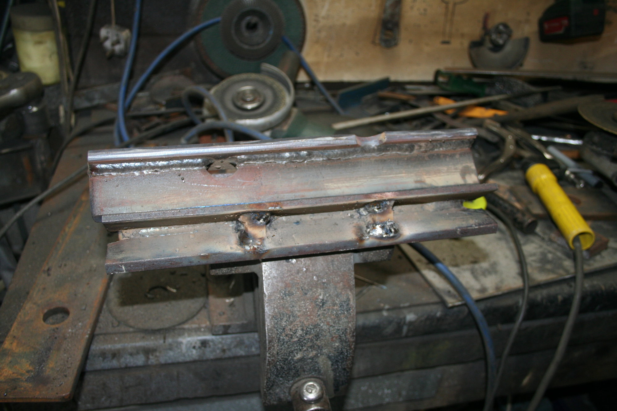

I was then able to remove the flue pipe and cut out the top of the stove that had been burnt out with a 4 inch grinder.

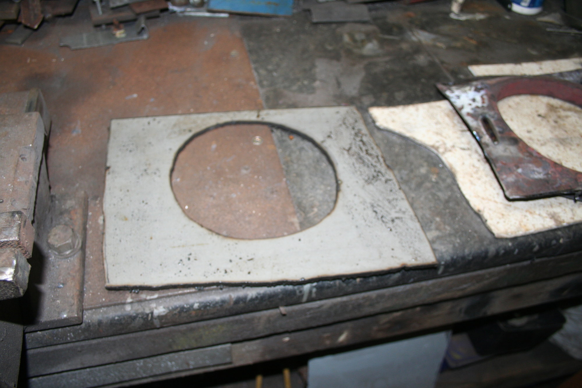

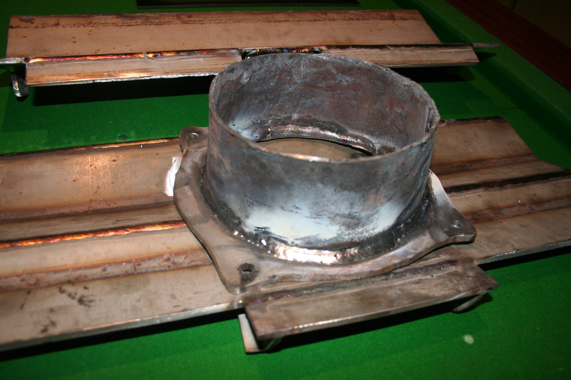

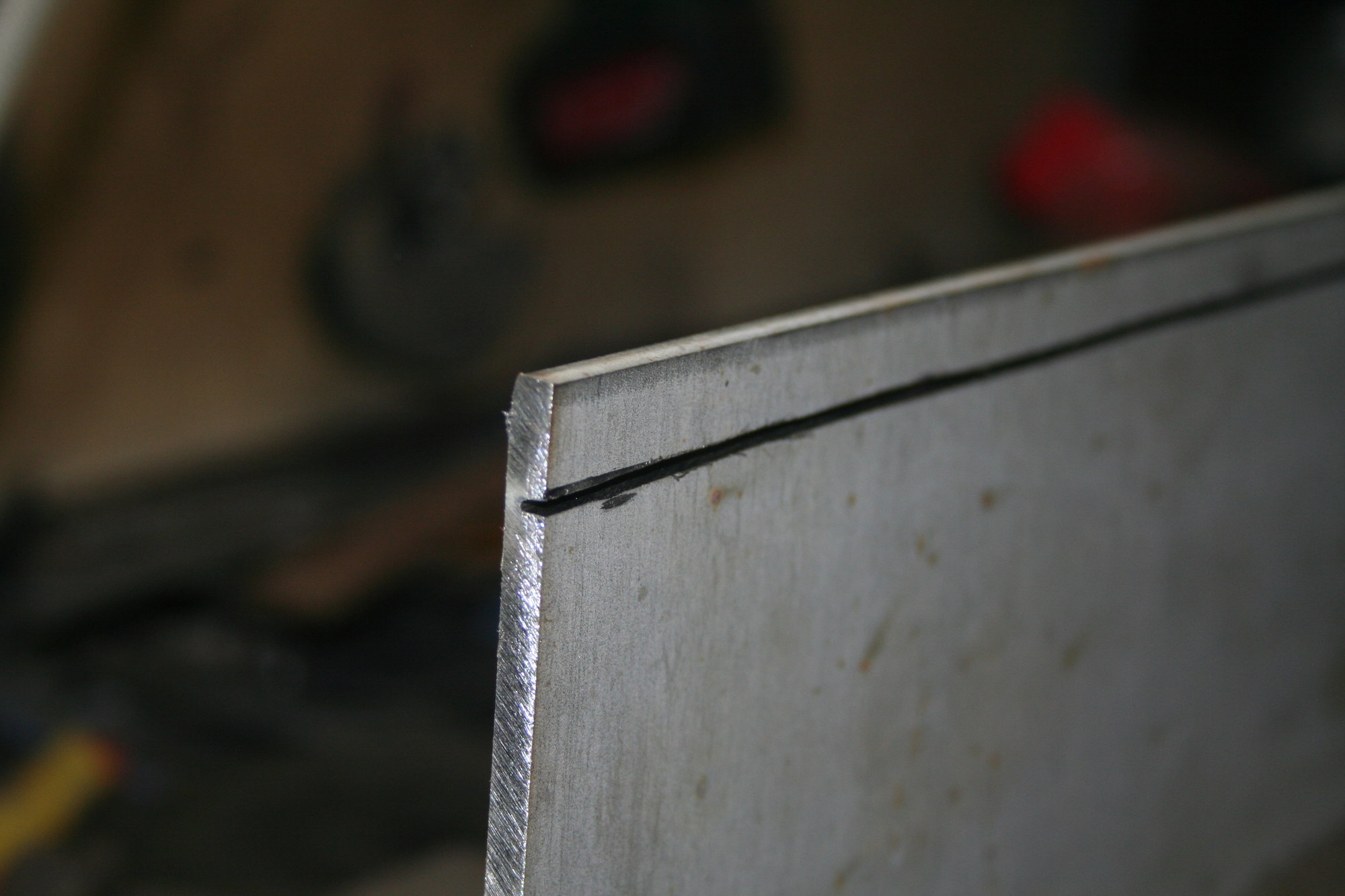

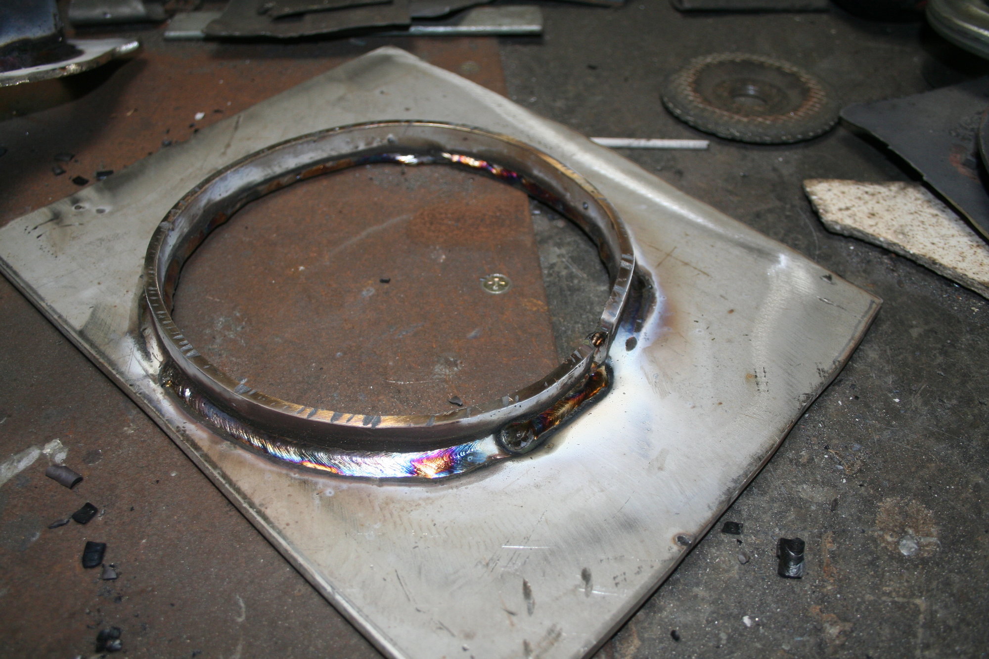

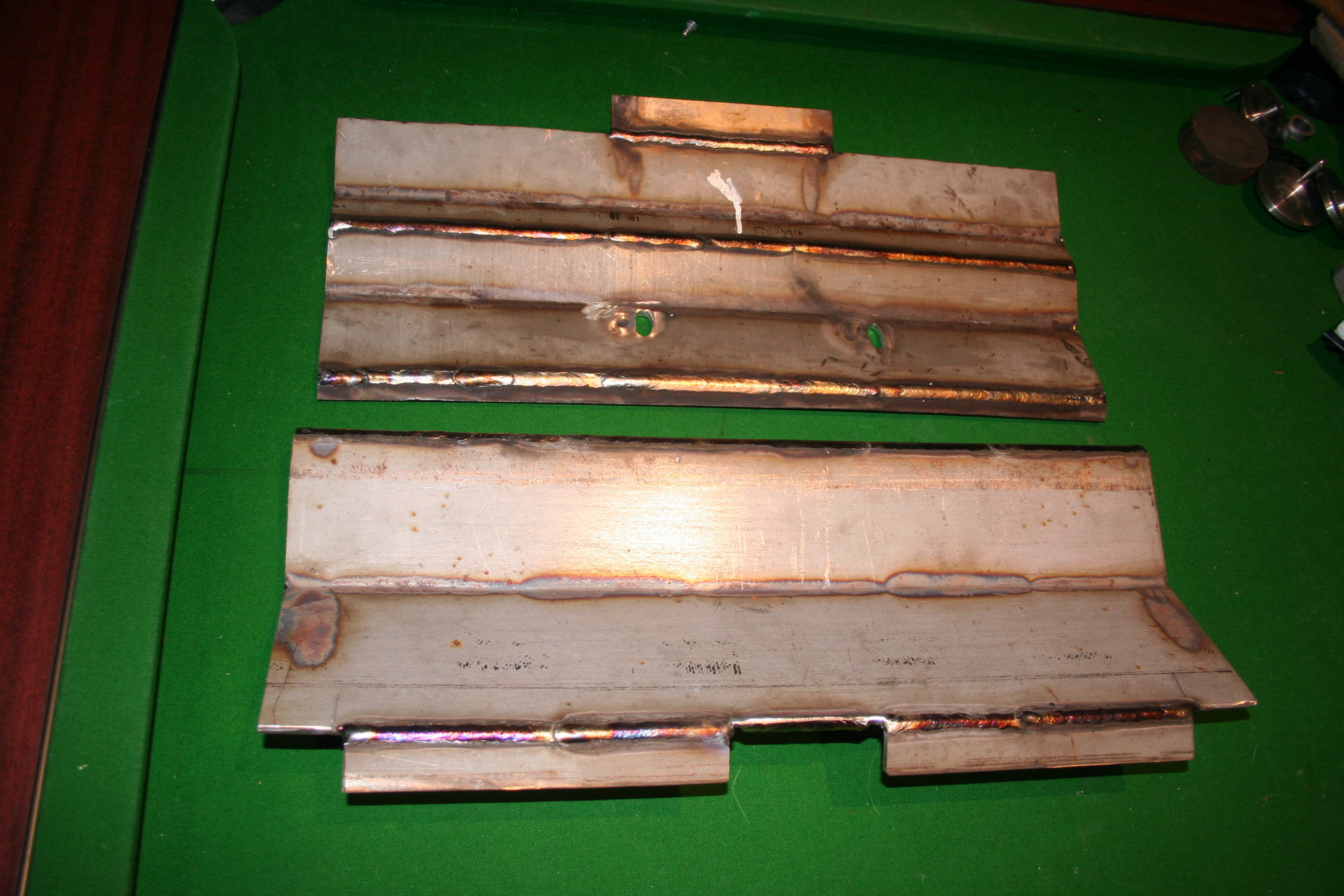

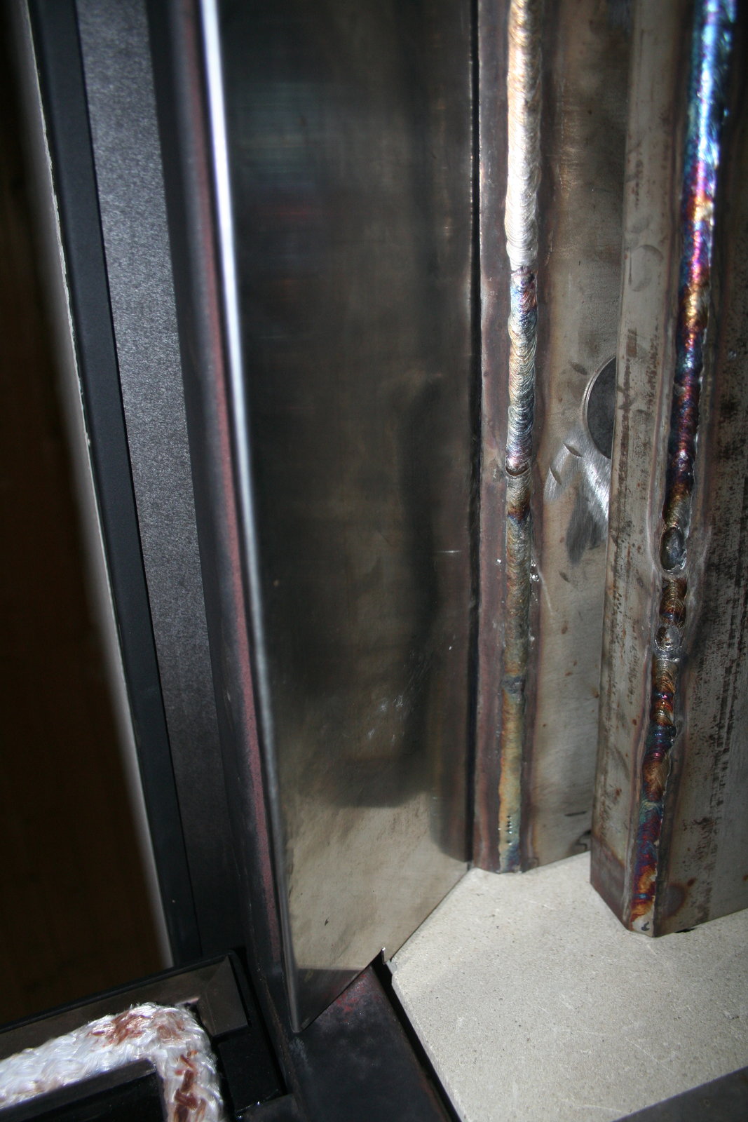

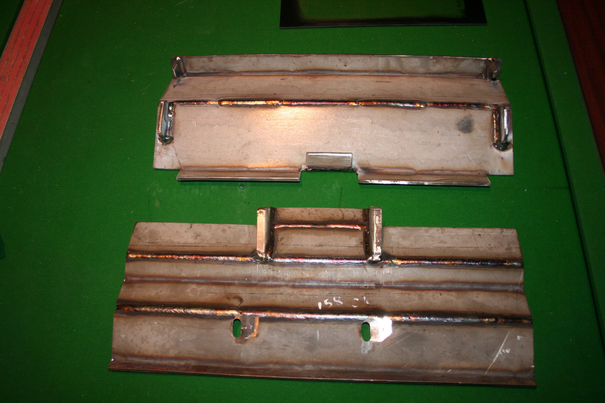

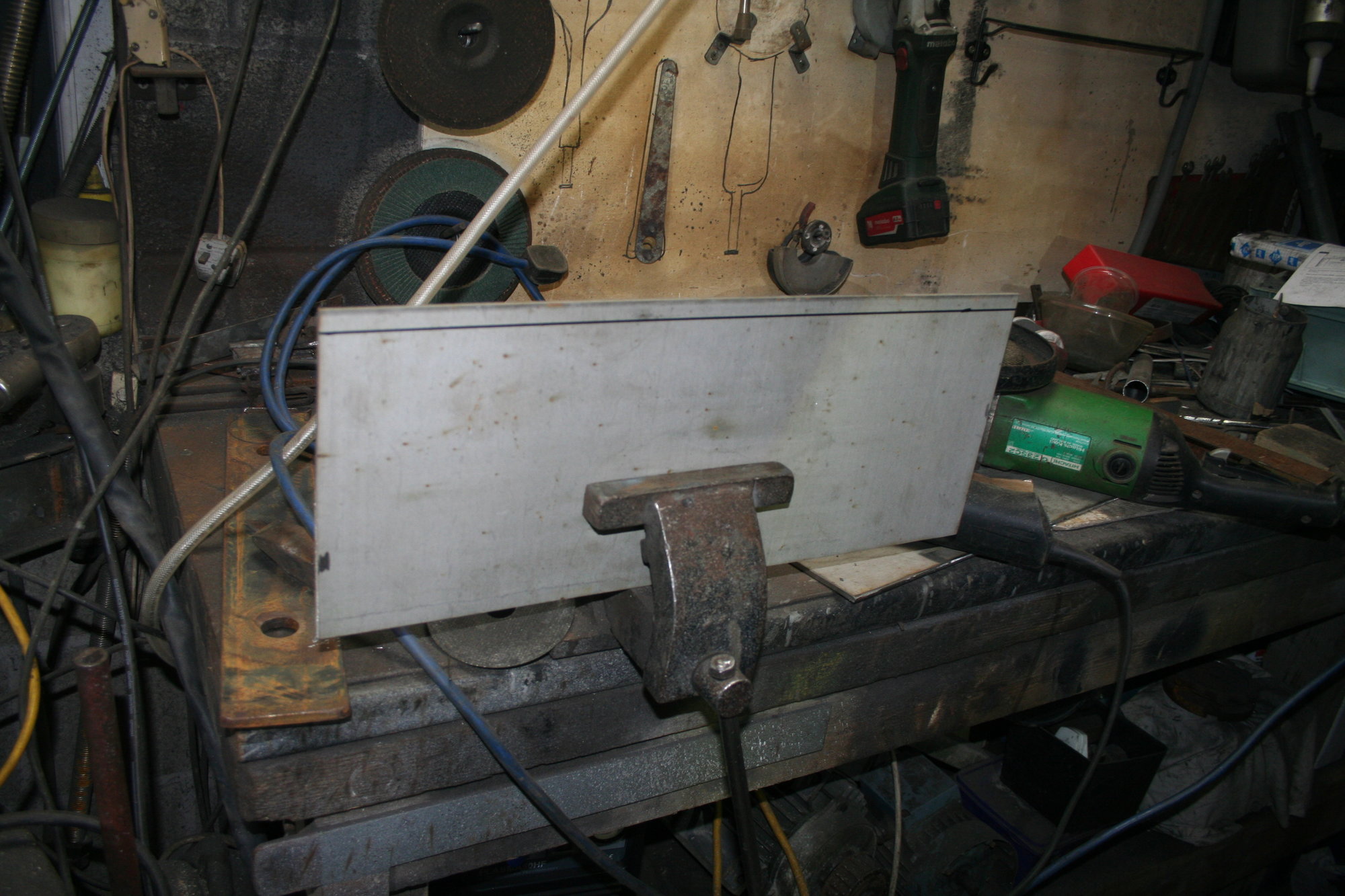

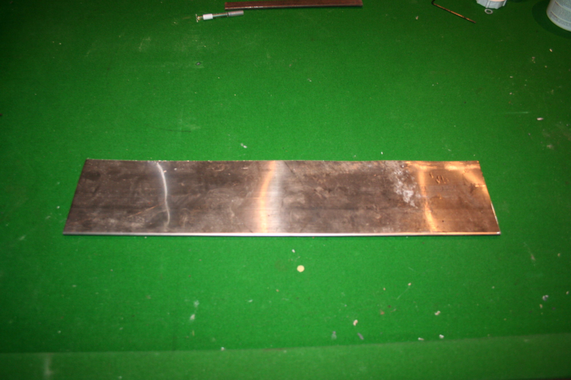

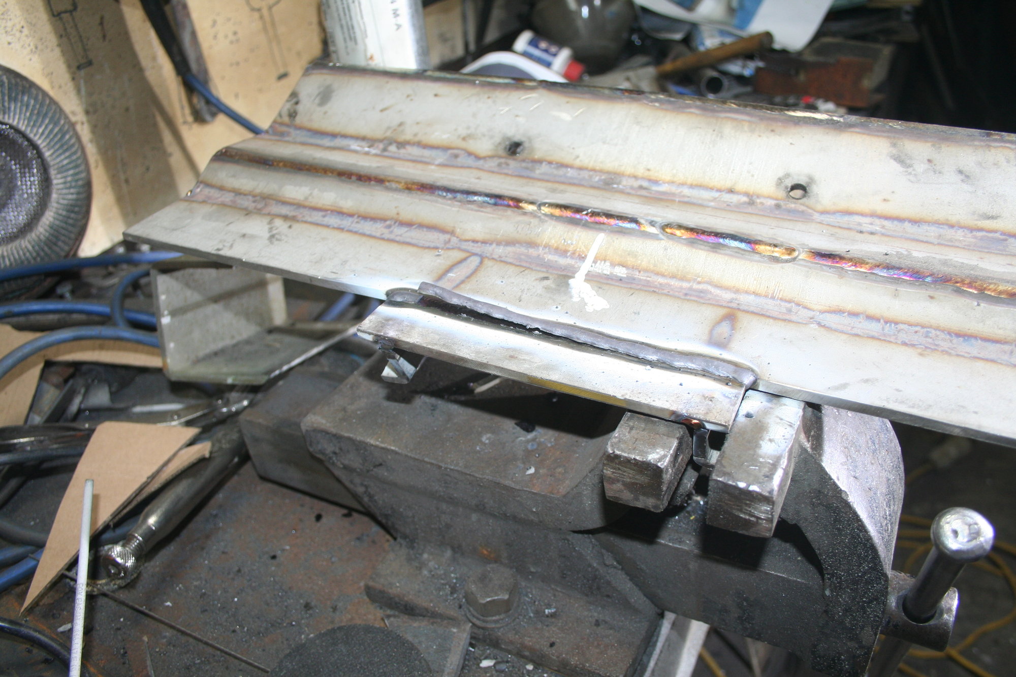

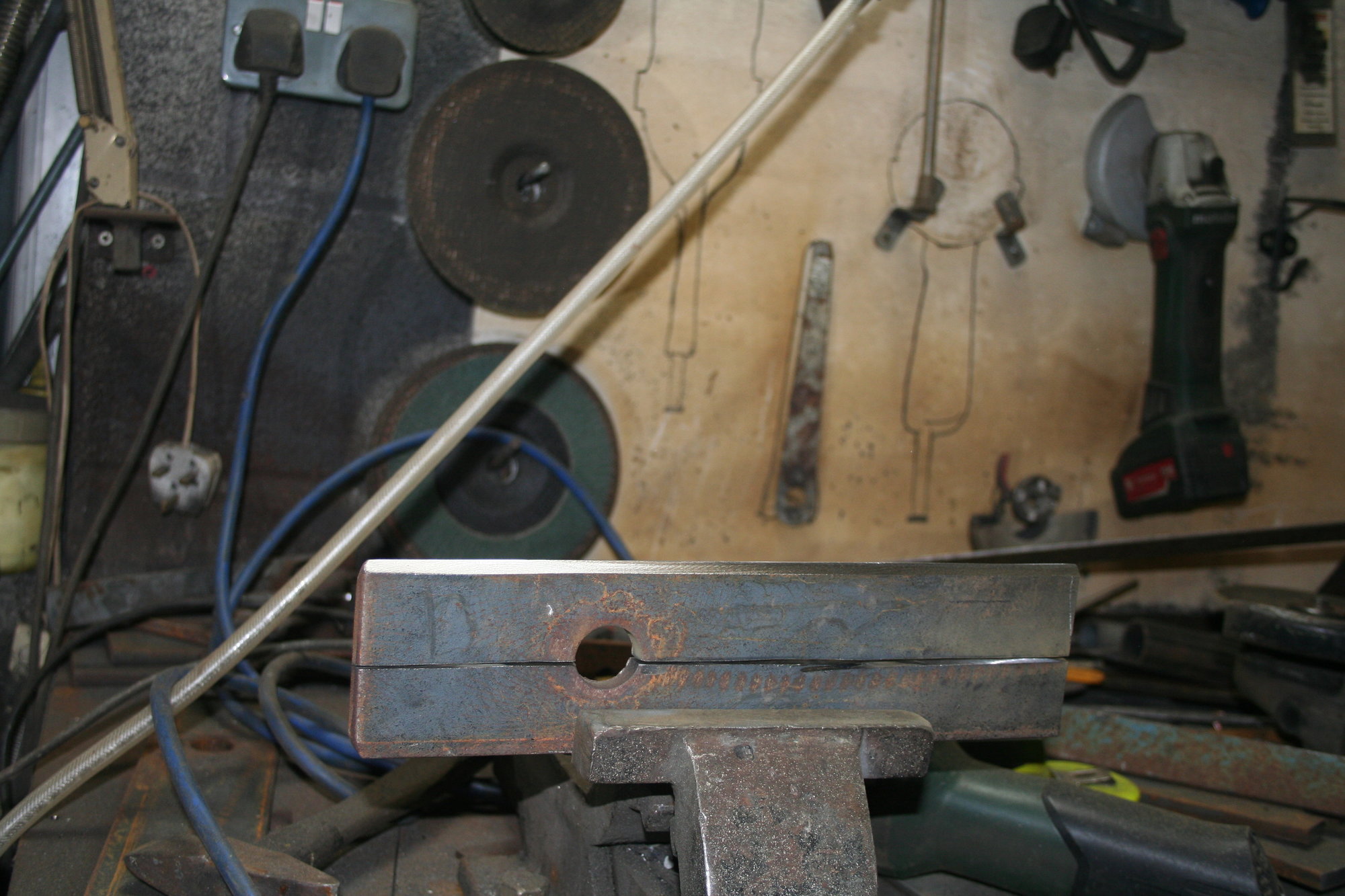

I have an off cut of 5mm thick 316L stainless so decided to use this for the repair, as stainless lasts far longer than mild steel in contact with flames.

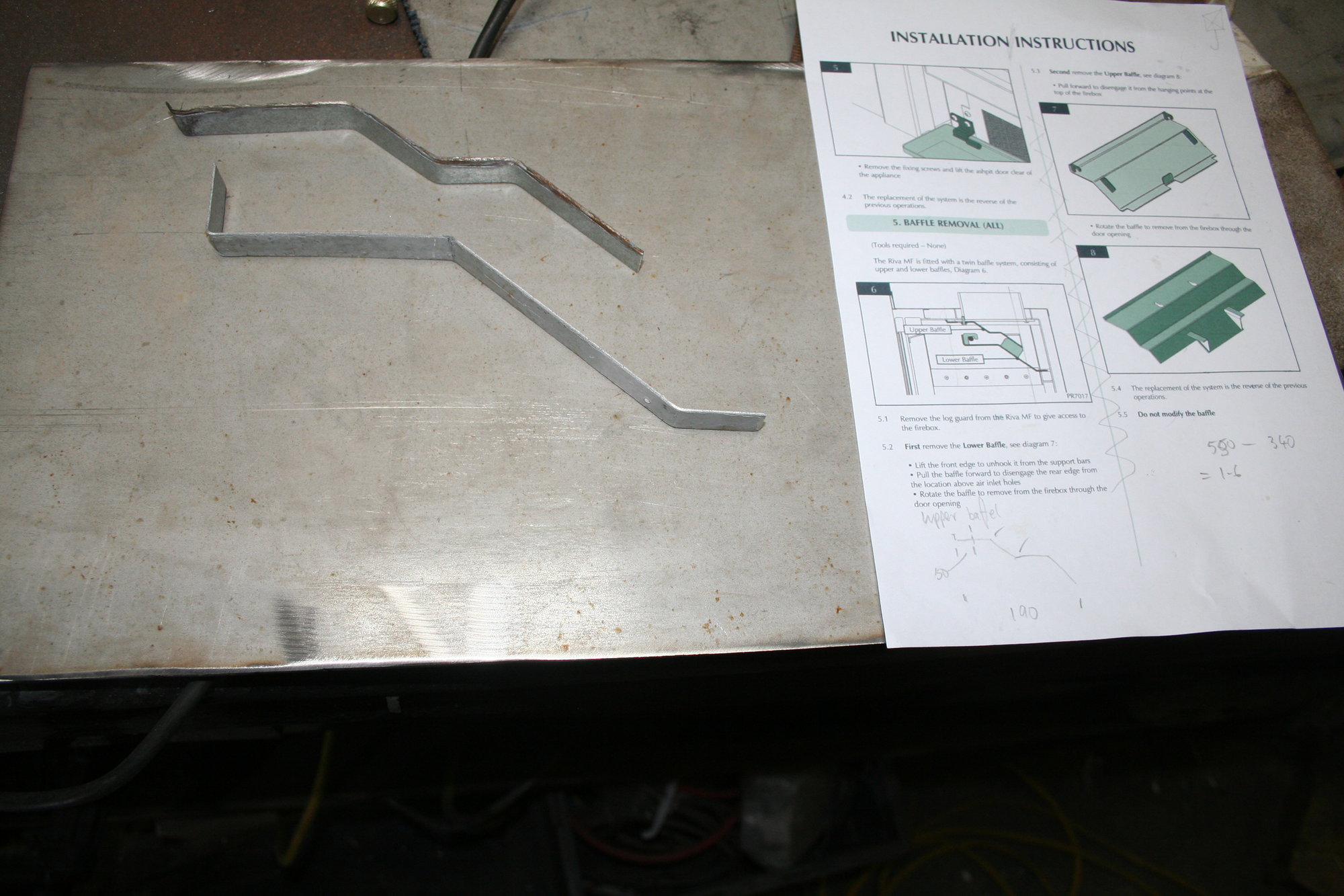

I used my Rtec plasma to rough out the replacement parts.

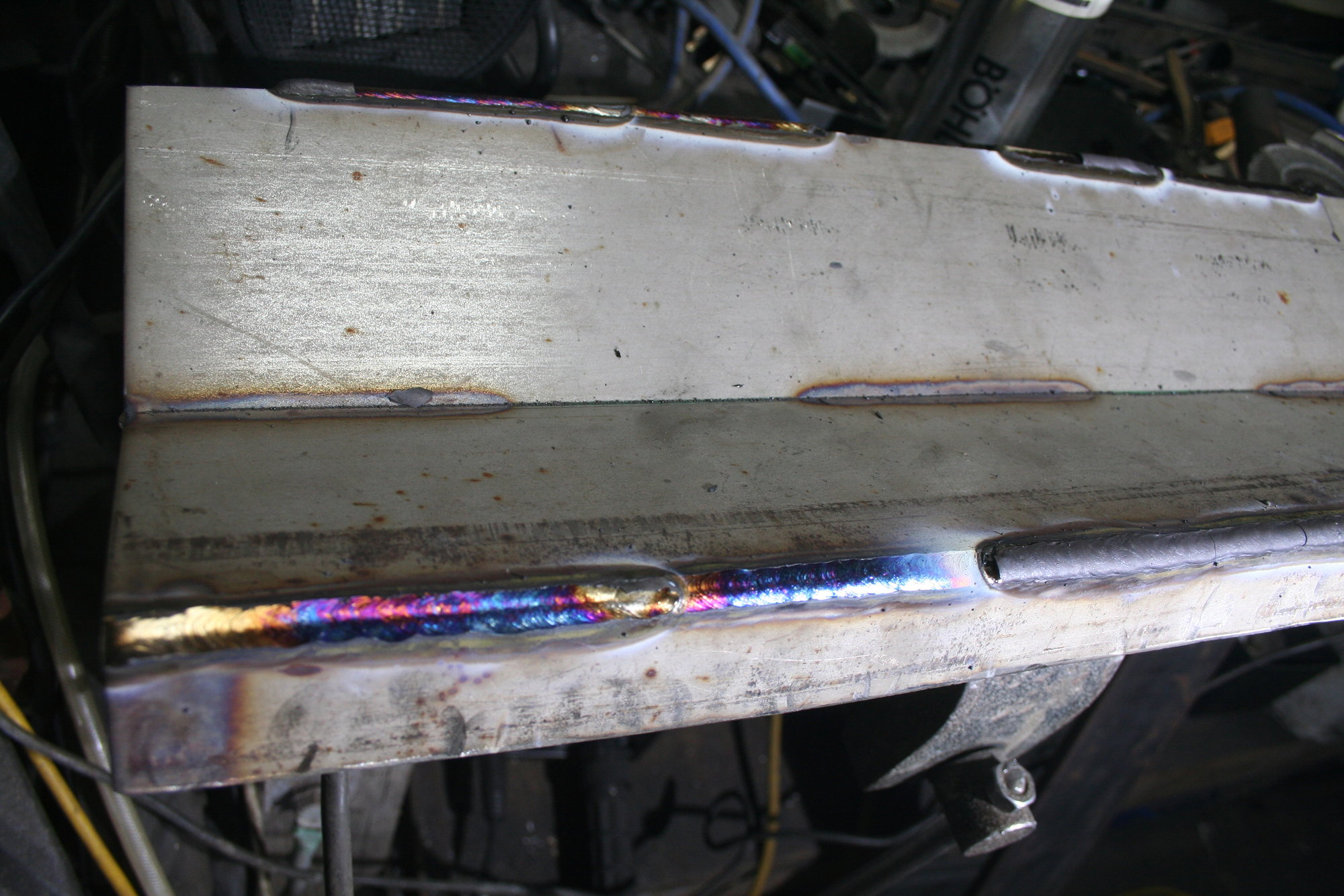

And welded them together with 2.5mm Bohler 316L arc welding rods.
