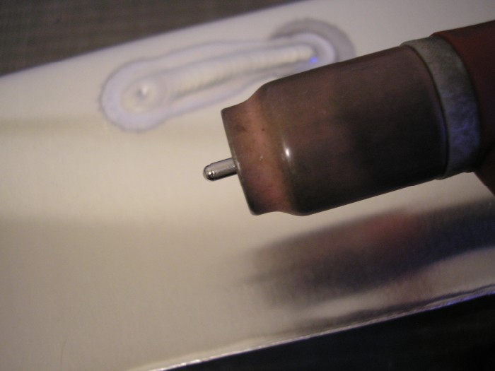

Post some pics of used tungstens and a weld or two. Fullstop and shift keys not required for that (sorry couldn't resist thanks to Shox ) but if someone's nicked the macro button (flower icon) off your camera you'll struggle to get a good close up that's in focus.
A selection of contaminated tungstens courtesy of the TIG tutorials (4th from top is what they should look like)...
They've all been contaminated with stainless by the looks of things, mild steel tends to be greyer/mankier colourwise. Don't always get a big blob like in the pic
This is what the tip looks like when it melts back without being contaminated from loss of gas shield/blobs of metal on it. Clean and shiney...
Pretty much the only time you'll see that is when welding ally with AC or the torch has been plugged in to the wrong socket. If it's a grey/manky colour without a blob of weld metal on the end it'll be from shielding problems.
