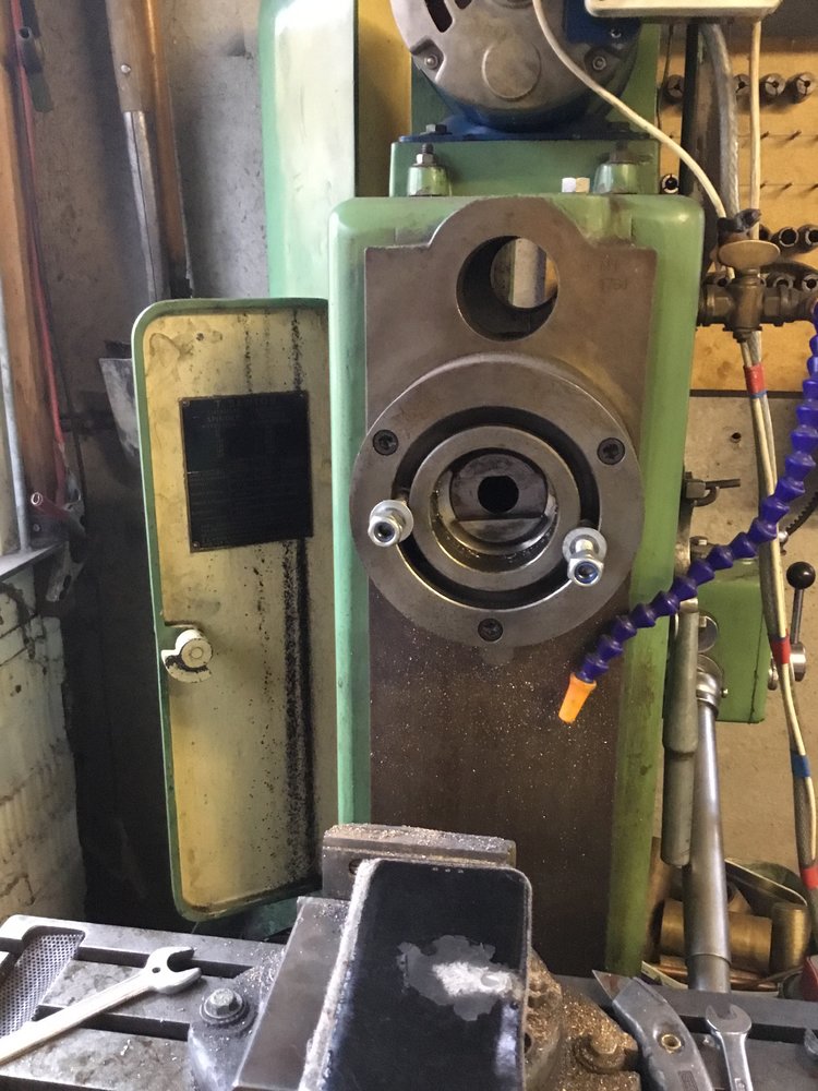

M Mr happy New Member Messages 27 Location Yorkshire Mar 2, 2024 #1 Hi need some advice off fellow members how do I remove this Clarkson auto Lock chuck from Tom senior m1 milling machine as I won’t to replace with normal chuck if possible Any advice much appreciated
Shox Dr Chief Engineer to Carlos Fandango Messages 17,987 Location East Yorkshire Mar 2, 2024 #2 Usually held in with the drawbar. To release you give it a tap with a mallet
N not done it yet Member Messages 2,288 Location Lincs/cambs/Rutland/Northants Mar 2, 2024 #3 Wedges|. Every time, if a tap with a (non-steel) mallet doesn’t work.
M Mr happy New Member Messages 27 Location Yorkshire Mar 5, 2024 #5 Thank you all successful with wedges
N not done it yet Member Messages 2,288 Location Lincs/cambs/Rutland/Northants Mar 5, 2024 #6 100% for me, over the years. Be sure to equalise temperatures before changing morse tapers. Expansion/contraction, by only a few degrees, can induce an effective shrink fit.
