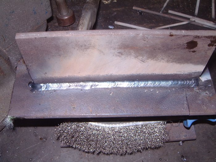

Fillet weld - two pieces at right angles, weld into the vee
Outside corner weld -again, two pieces at right angles but edge to edge so a small vee is formed between the two ends, fill that in with weld (very nice, easy, neat welds )
That looks like very clean work... Got a question tho, In situations like that (where you cant physically see the underside) how do you know that you have good penetration???

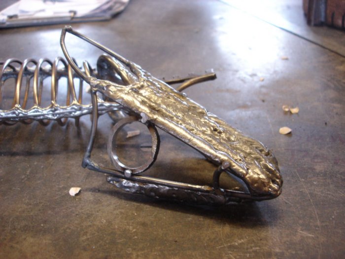

Here is a piece I am currently working on.
The whole thing is basically a hole filled in like this.
I made a structure of 3m welding rods with 3mm or slightly smaller gaps between them then welded over the top in a series of straight runs with the welder turned up fairly high as I like the surface to melt into itself.
Tis the head of a chameleon skeleton, this lot took a whole afternoon.

I've been practicing vertical-up-push fillets today on 3mm plate in preparation for replacing the rear cross member on my landy (see the first picture of the fillet from Wozzaaah, and just do that going vertical ). I'm getting a bit better at that. You need to be going from one side to the other, hesitating slightly on one side, then following the pool over to the other side, hesitating, then back etc etc. If you just run a bead straight up, you find it builds up too much as gravity pulls on the pool.
