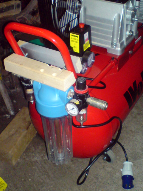

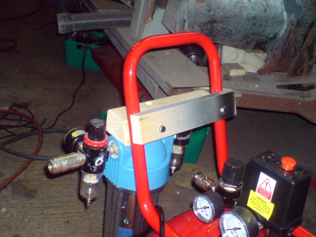

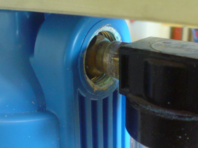

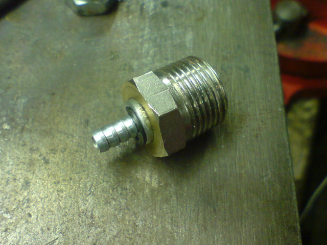

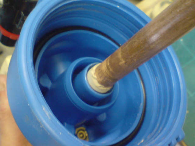

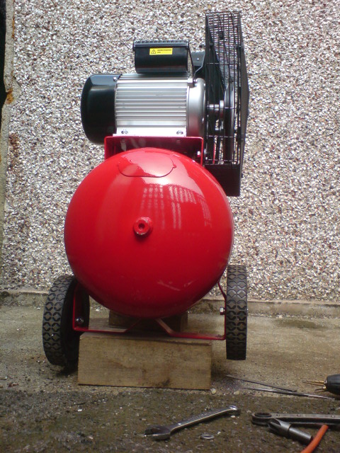

So overall I like my new compressor. The Factory setting was only 8 Bar, so i've upped that to nearer 10. It comes with the short euro style connectors, so I cnaged them to CPL ones. I was the front exit one was ok, but the pot metal hiusing on the regulator cracked. So that went in the bit and fitted a better one from the old compressor, with oil and water trap. The Welding trolly is going to be more of a mobile workstation and will have power and air attached. So I'm planning two regulated supplies with and without oil and one direct into the plasma cutter. I'll update on the welding trolly in a seperate post.
and don't just lower it - add hydraulic lifts so you can make it dance
