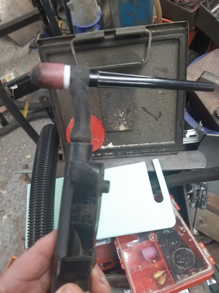

Anguz Forum Supporter Messages 1,632 Location Northamptonshire Dec 24, 2023 #1 how do i know what torch i have ? i know the consumables dont fit each other, so hence the question is there a way to tell ?
A Agroshield Member Messages 4,797 Dec 24, 2023 #2 Take a look at these two pages (click on the 'parts' tab). The thread size on the two torches would be a good indicator. CK9 5/16"-24 (https://www.ckworldwide.com/products/ck9-gas-cooled-torch). Confirmed by measuring my CK9. CK17 3/8"-32 (https://www.ckworldwide.com/products/ck17-gas-cooled-torch). Don't have one of these. These pages also confirm same: Parweld Long Back Cap for WP17/WP18/WP26 TIG Torch (57Y02) Replacement Long Back Cap for WP17/WP18 and WP26 tig torches.Sold in singles weldingsuperstore.co.uk Parweld Long Back Cap for WP9/WP20 TIG Torch (41V24) Replacement Long Back Cap for WP9 /WP20 TIG TorchesSold as singles. weldingsuperstore.co.uk
Maker Most folk just call me; Orange Joe Messages 10,367 Location Don't ask questions Dec 24, 2023 #3 Upload a picture, someone will probably tell you straight away.

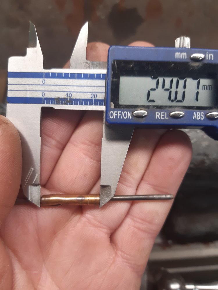

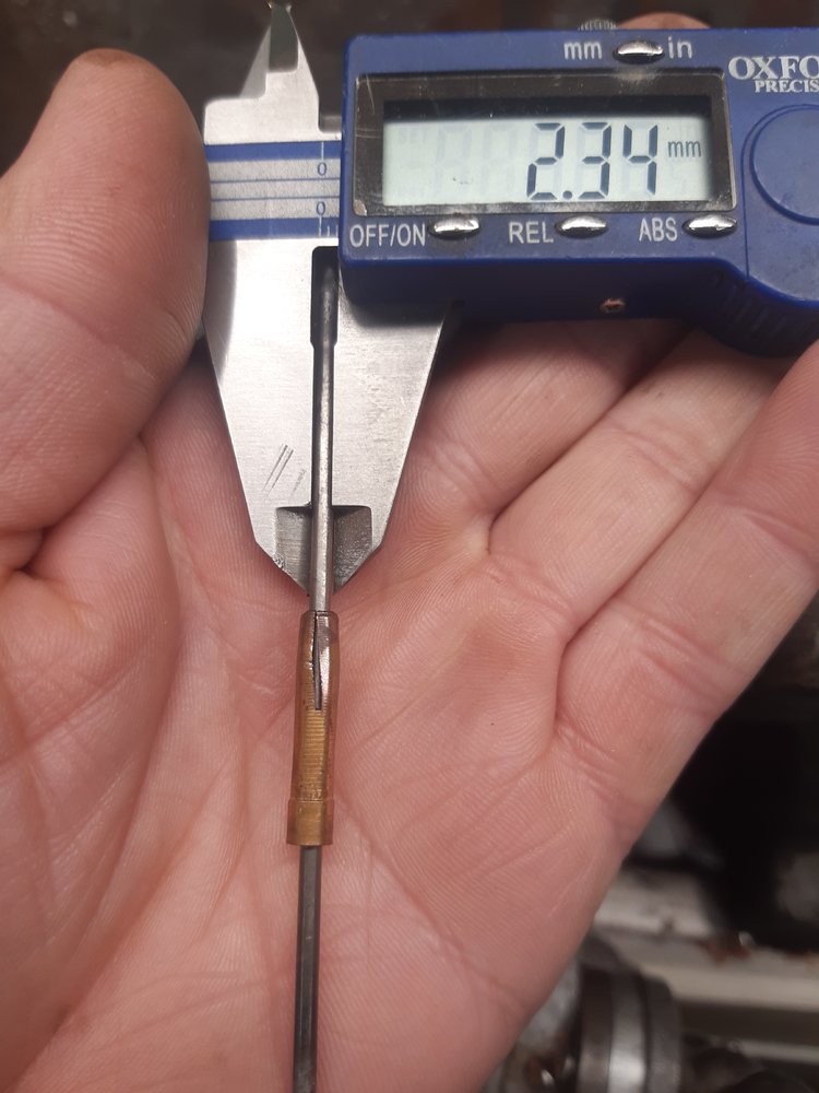

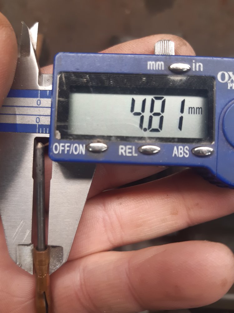

Anguz Forum Supporter Messages 1,632 Location Northamptonshire Dec 25, 2023 #6 Just been out... no need for a mug for scale as it actually says wp9 on it Rekon it was an ebay cheapie.. plenty good enough for the use it gets... but I jave bent one of the collets. Think I may have put it in backwards.. are these standard?
Kram Member Messages 6,255 Location Sussex Dec 25, 2023 #8 Collets deform after a lot of use from being hot, as copper is quite soft. Yes looks like a standard one.
