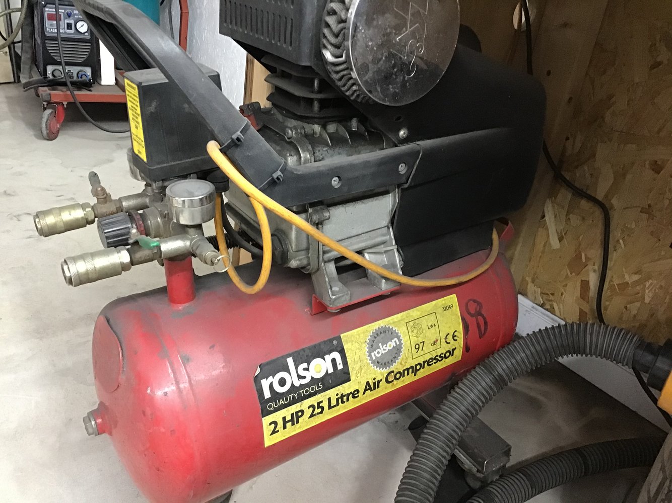

A bit of an under-statement there. It will go well over 13A, at start up, even if the pump is off-load. Normally the surge is for milliseconds before it reduces as the motor gains speed. On top of the normal ‘run’ windings there may well be start windings taking power, too, until the centripetal switch isolates the start winding.There is a big current surge when it starts, and it will go well over 13a if the motor tries to start the compressor with the backpressure still there! Mine is a Clarke, but they are all very much the same, the more you pay, the better you get (generally) Clarke/machine mart are good for spares, should you ever need them, keep the oil topped up to the red dot on the sight glass, and beware because it holds oil against the perspex, so when it looks slightly low, it is probably nearly empty
Thanks for the welcome, was looking to get one to use at home to run my 30 Rtech Plasma cutter, have a industrial one at work so should be okay their. Looking for plug and play rather than having to get a heavier supply fitted at the house. Have never got into Electrical work hence my request for advice.
I just drain my compressors tank regularly, or just before using the plasma if its been while since I used it...I don't have any filtration or dryer...Bought a Nuair 100lTech from importer and a Rtech 30 plasma cutter. Looking at in line filtration from compressor now any recommendations. Thanks.
