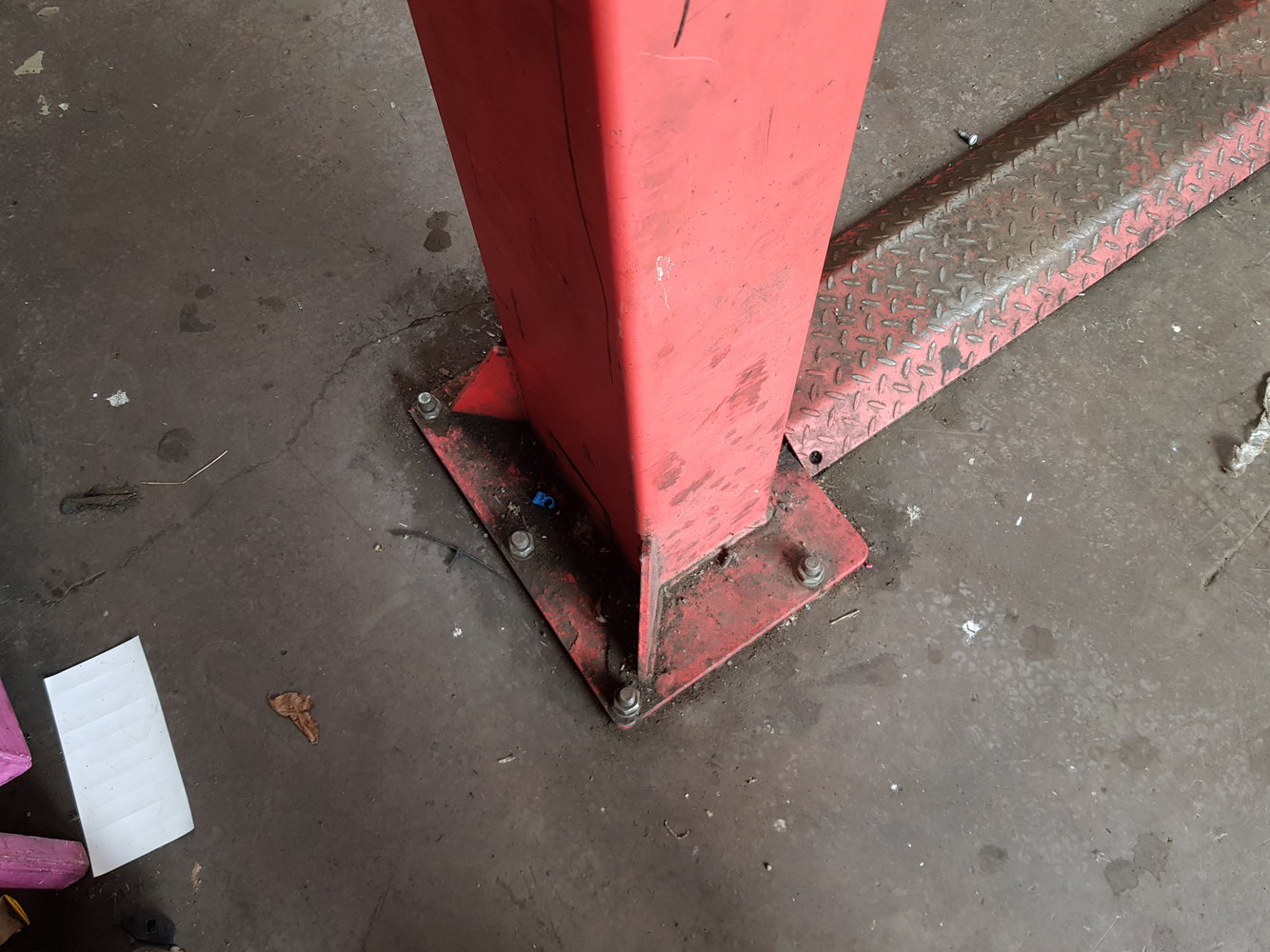

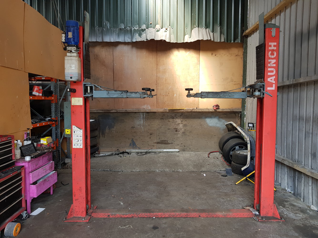

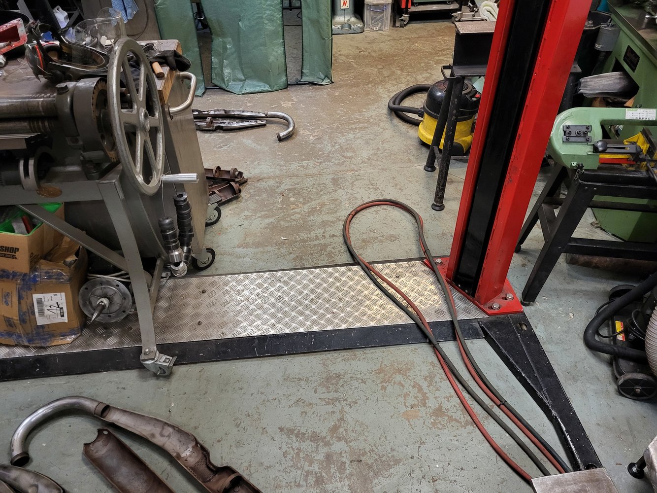

This is my Christmas project. To finally install a good used Launch 2 post car lift into my front garage. I did intend to build a garage extension but it's still far away for now this lift will be great to have in the front garage and it will stay there for good.
Question-
The floor in this garage is sloping and too thin. So I'll need to cast in new pads below where I want to install the lift.

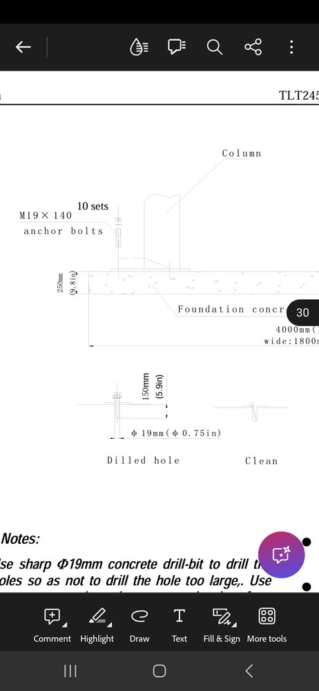

The base plate holes are 21mm dia. The manual says 19mm bolts.
(Pic of my used lift baseplate before it was taken down. It is a Launch lift)
Should I make my own welded bolt cage and concrete that in? Difficulty being having to lift over and set the posts onto the studs. Ideally I'd use 16mm High tensile studs to allow some fitting tolerance with this method.
Or washers and cones with 19mm bolts? Using a plywood template to hold them during concreting.
Or finally cast the pads with a good strong concrete mix and leave a month to harden before post drilling the holes and using say 300mm deep chemical anchors? This would be the most "friendly" fitting method.
