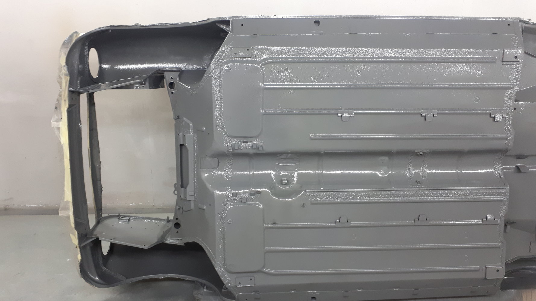

As the title says really! I've got my old mini floors in 4 coats of epoxy and its time for gravitex then colour... do I bother using a 2k primer between? And how long should I be leaving the 1 thick coat of stonechip to go off before putting the 2k colour on? Its a road car so maybe i should double up on the stonechip or will that cause me a mare as I know it doesn't like to go off very quickly!!
