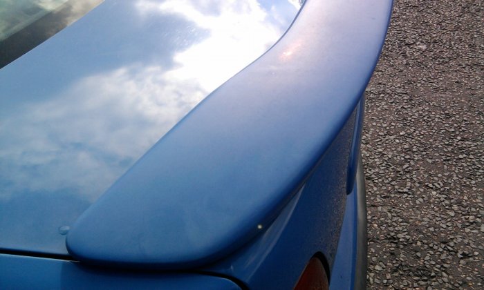

solid 2k THE disadvantage is it fades ,unless you keep on top and keep polishing it its OK .Base and clear is the best way to go .All new cars are base and clear.This spoiler on my car was done in a solid color .look how it has faded ,to the boot lid.it will polish up .But who wants to do that every time.
