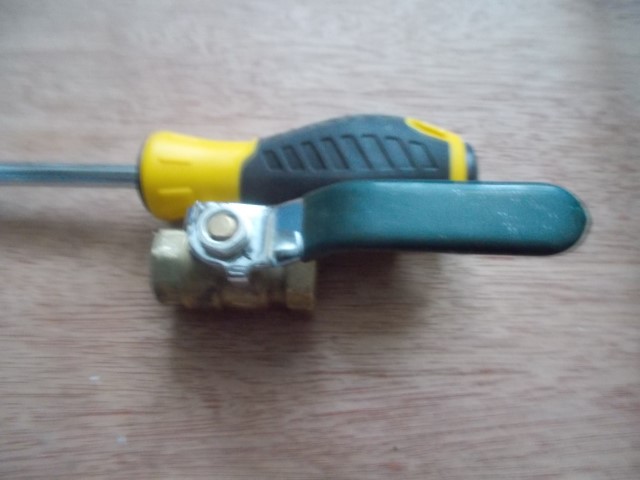

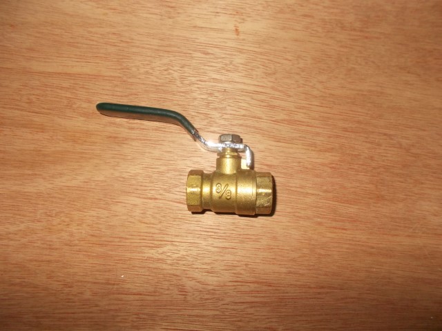

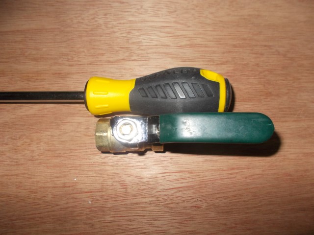

Is one of this type.it has a rubber washer dont it and nylon slider?
Are these likely to have been damaged by using butane torch to get them offOften PTFE seals internally.
Do you they make actual PTFE internal seals, is this what you mean? Not PTFE gas tape?Often PTFE seals internally.
Yes, the ball often sits in a machined PTFE part to seal its not a metal to metal design.Are these likely to have been damaged by using butane torch to get them off
Ah, ok, so even if the valve appears to open and shut correctly. The heat could, would have damaged the seal and wouldn't find that out until I run air through them? If so will do as armalites suggests and buy replacements.Yes, the ball often sits in a machined PTFE part to seal its not a metal to metal design.
Not a lot for full flow, bought several to cover my needs.Some you can buy kits for but I suspect a new valve wont be much
okprobably just pass air when closed
Thanks.The ones I have taken apart have a pair of O rings sealing the ball.
