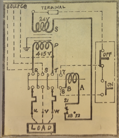

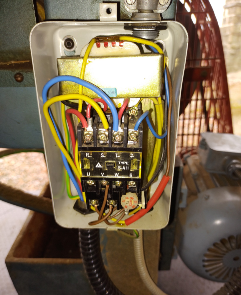

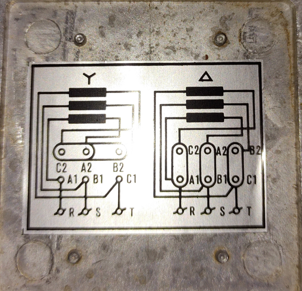

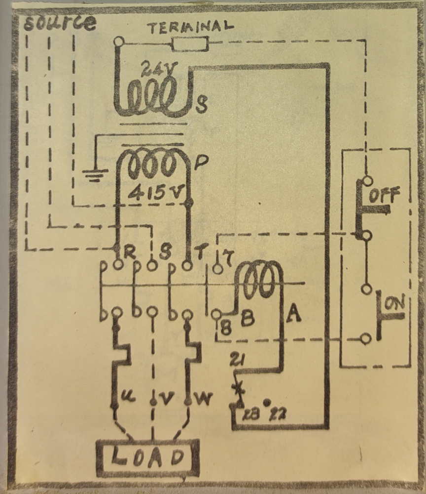

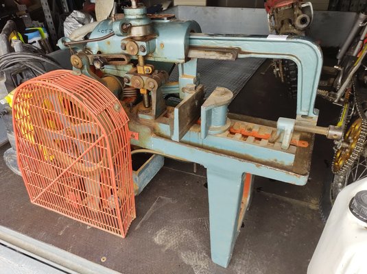

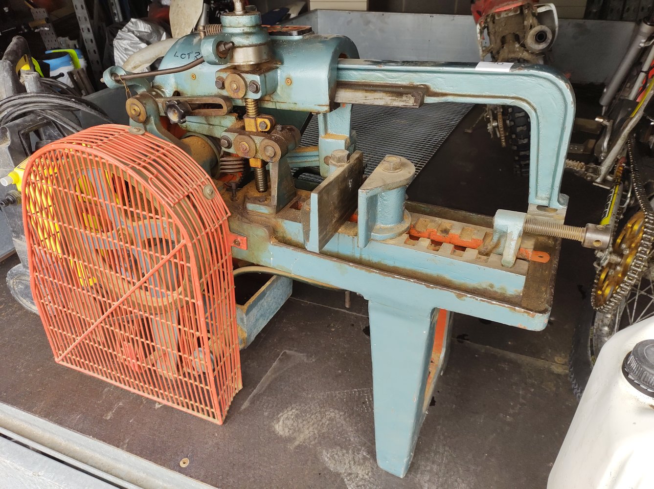

I have a rudimentary understanding of 3ph and star/delta wiring, gleaned from a few YouTube videos, but I have a few questions relating to an Ajax power hacksaw I've just bought and would be grateful for some answers!

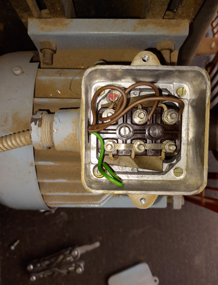

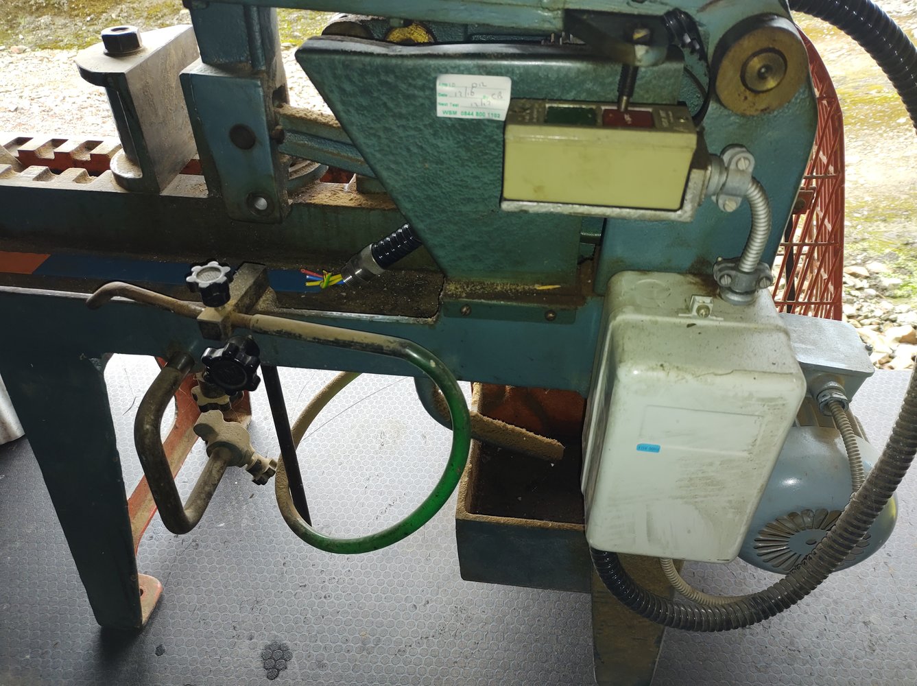

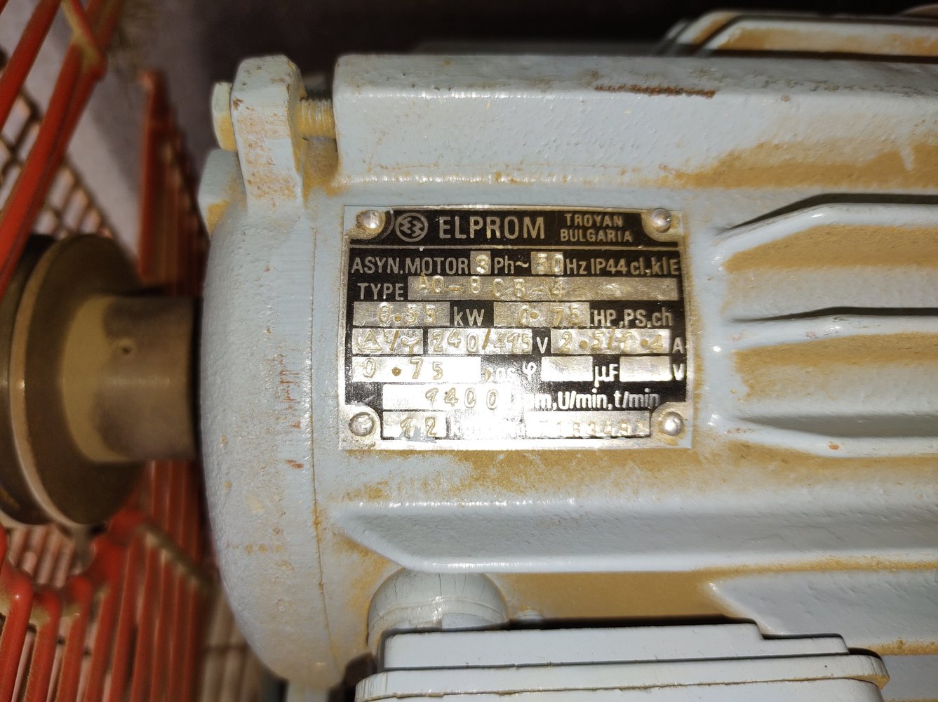

Why does the motor plate list 240/415 volts? And why are there two junction boxes when it appears the one feeding the motor is permanently 'star' wired? What's the first one for? And finally I only have single phase 240 supply so would I be best getting a vfd or swapping the motor?
Cheers!
