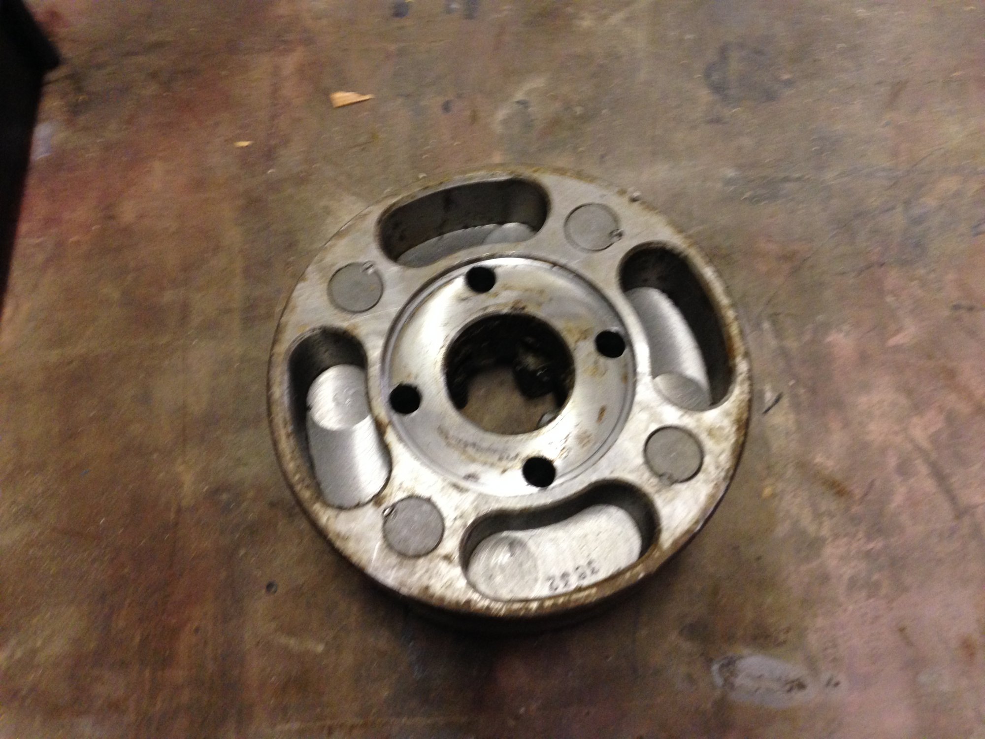

have a back plate already fitted to the lathe.
just need the 3 jaw chuck to match it

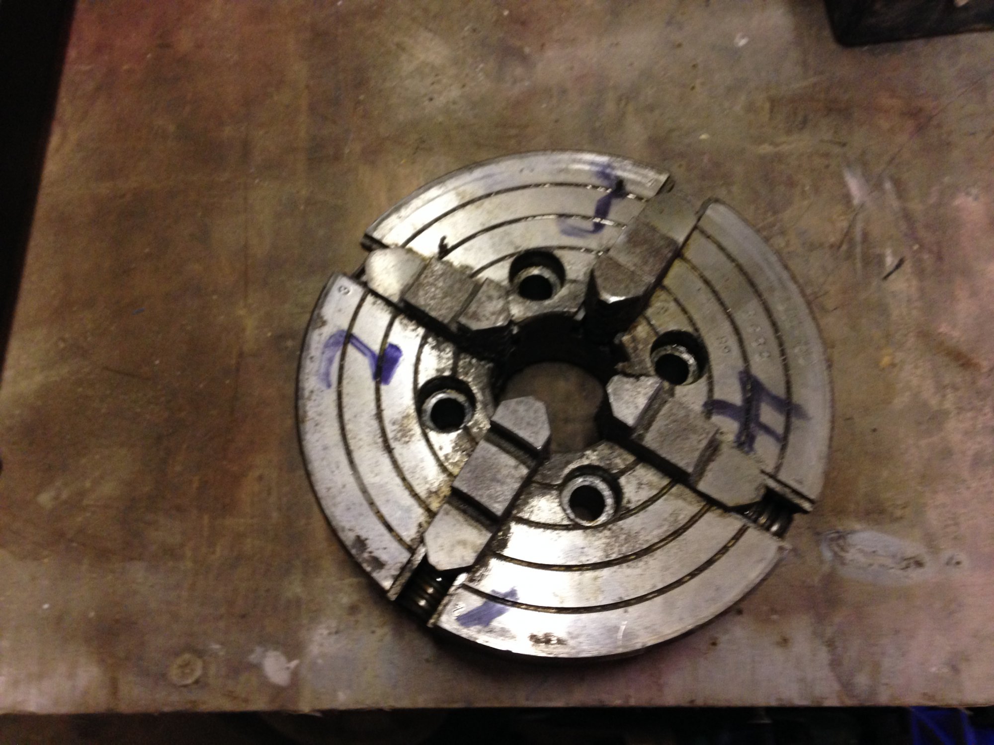

and once u take a cut it will be 100 percent accurate 4 jaw only needed if original diameter wont need cuttingAnd as a extra, you really want a 4 jaw AND a 3 jaw. The 4 jaw will always be more concentric and repeatable once you get the hang of bumping things in using a clock. 3 jaws are just for general chuck something in and have it spin roughly where it should be jobs when concentricity isnt extremely important.

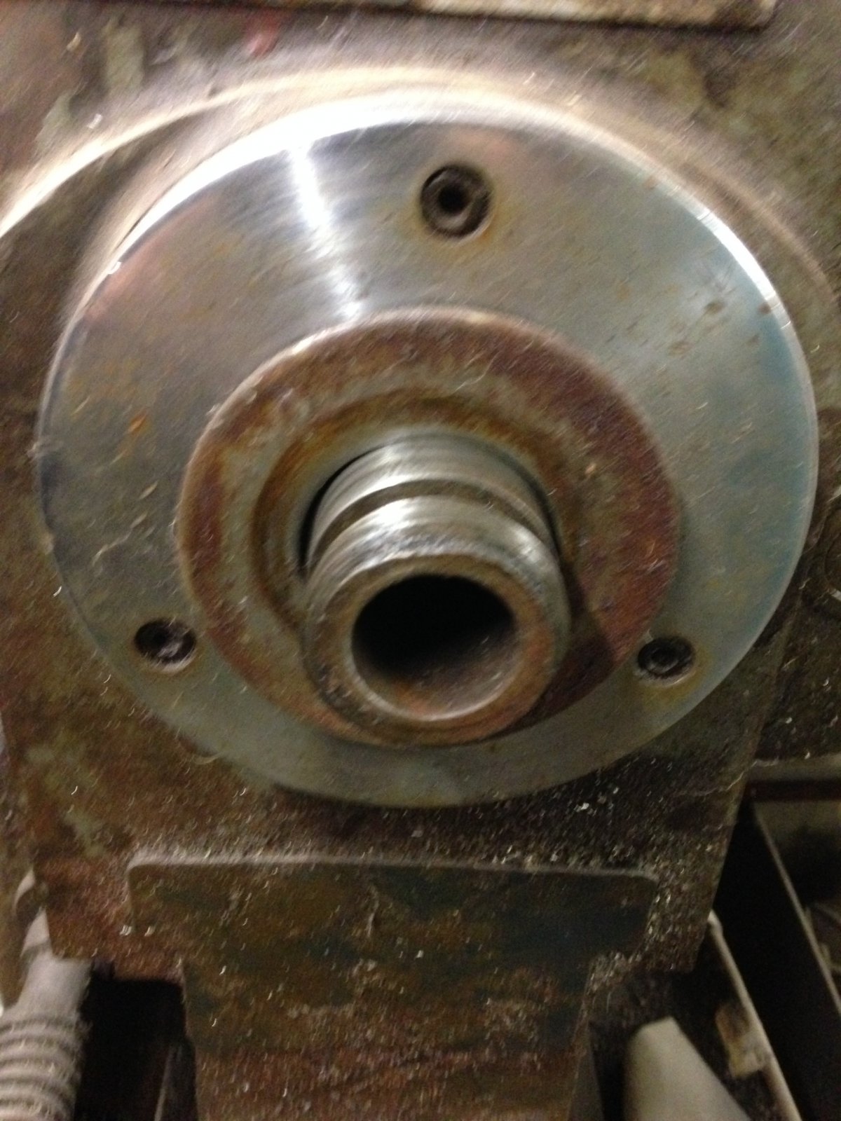

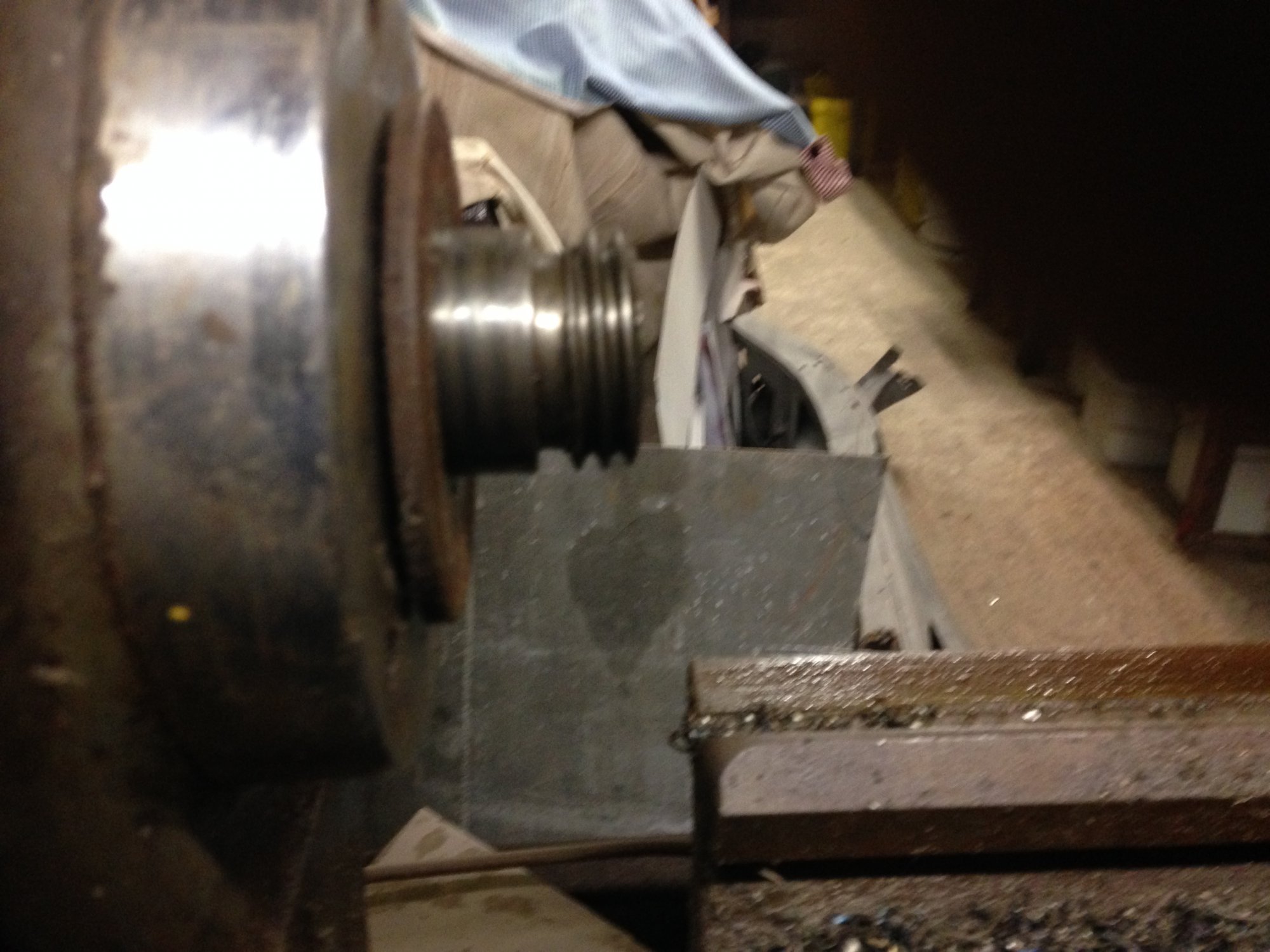

what is the diameter of the plain bit before the thread starts proper in inches? it should be either 2.25" or 1.75.This is a photo of the thread fitting on my lathe.i am a beginner
and finding it difficulty to get workpiece true in the 4 jaw chuck.
