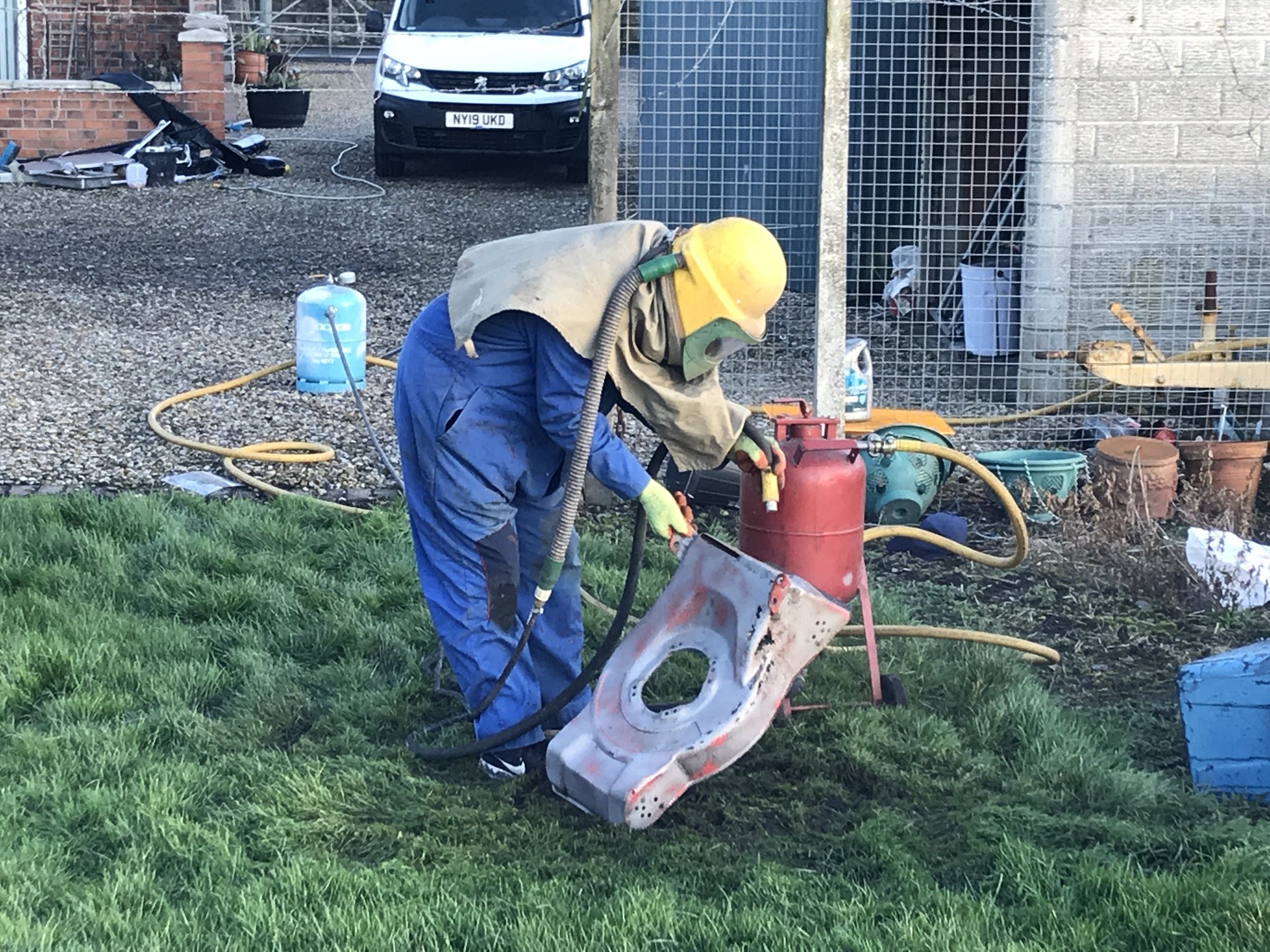

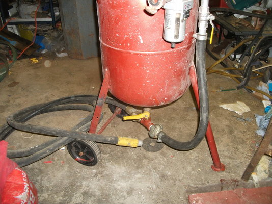

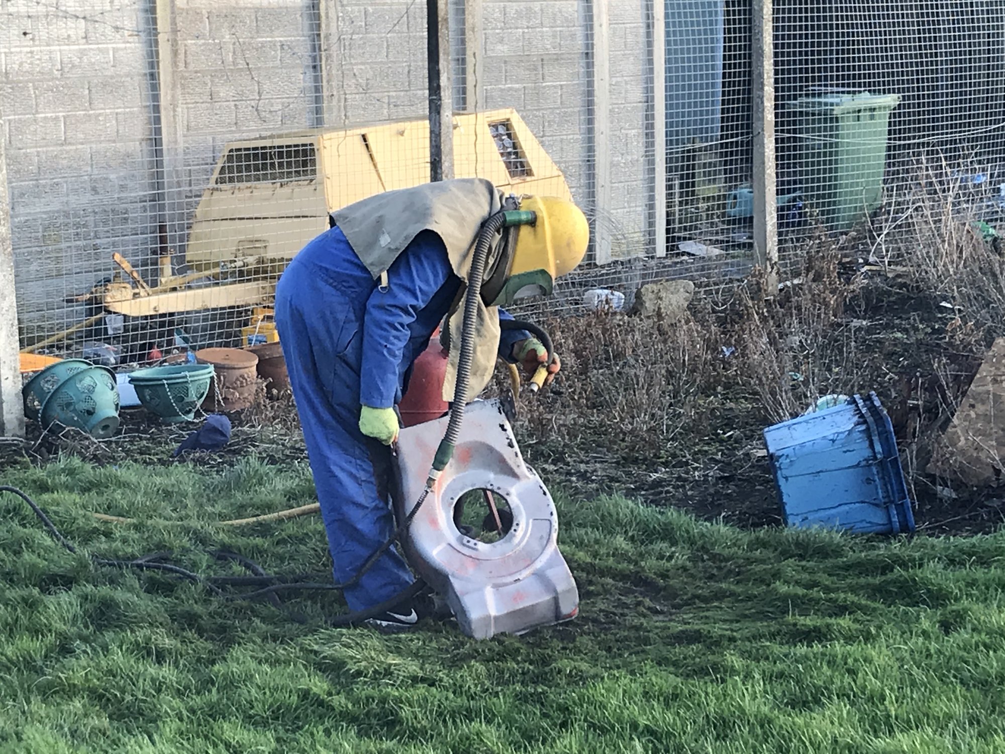

haven't run comp in 6 month so my mate wanted his lawnmower frame blasting . just did it in the open as haven't a shed to do it in . comp started instantly warmed it up and started . the grit I got was a bit large 1.0mm to 1.5mm it certainly cleaned it up fast but would be better suited for cleaning oil rigs up I wouldn't do motorbike parts or wheels with it just use my smaller pot with sand for finer work
