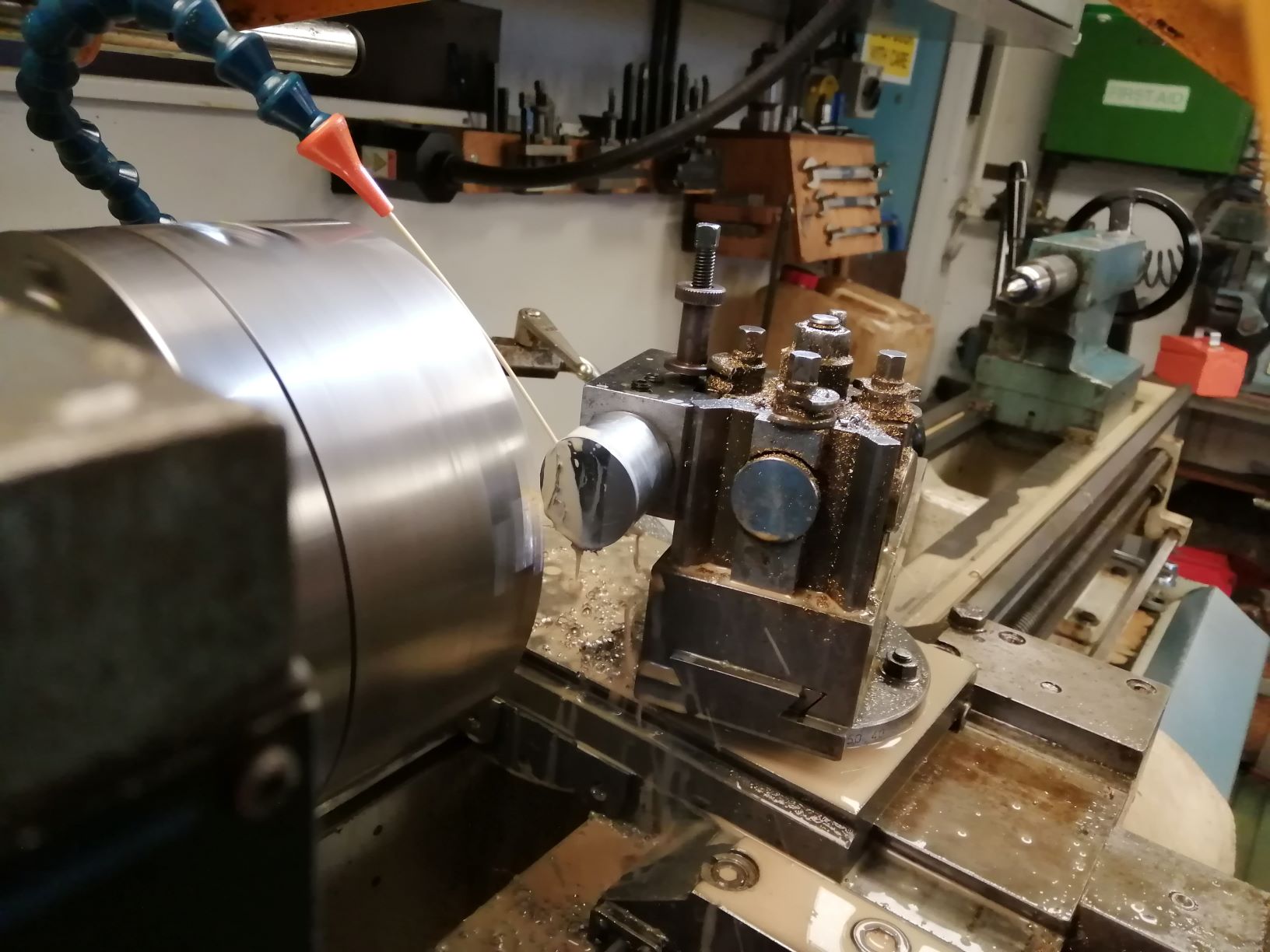

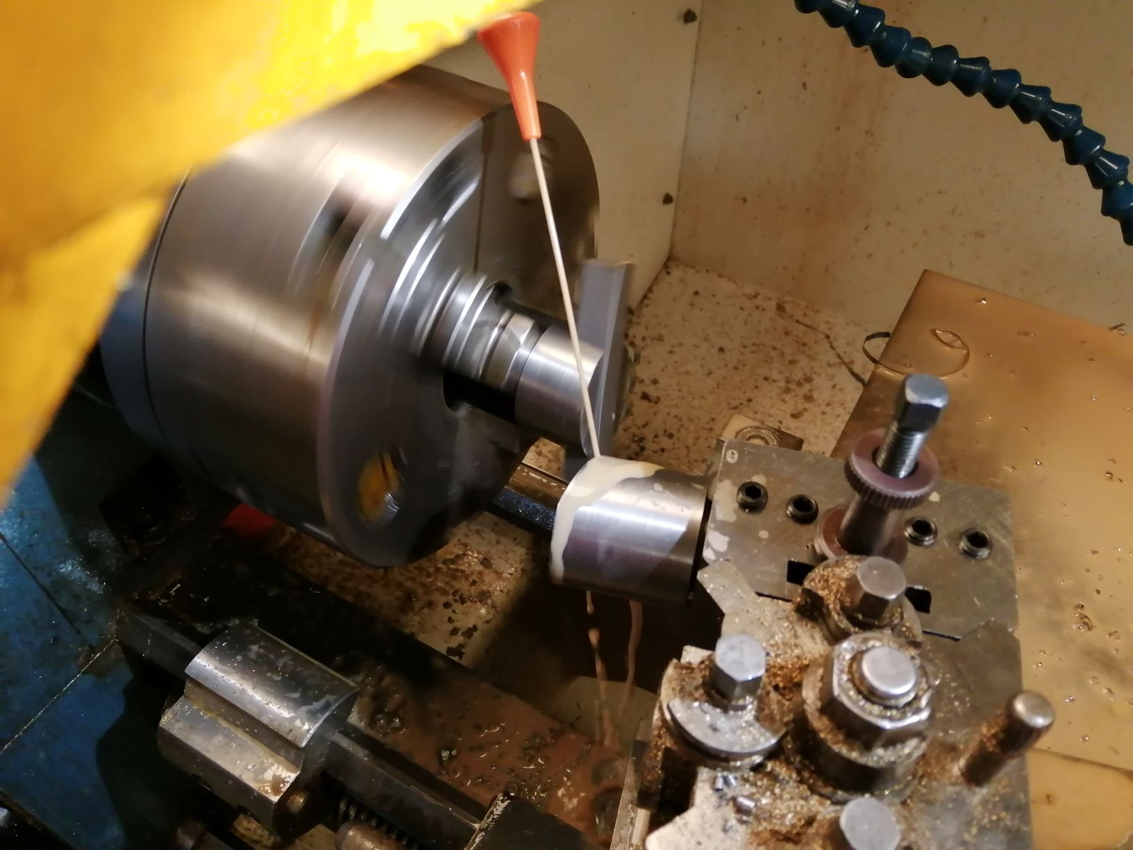

So while having access to a lathe and milling machine at work and needing something to occupy myself in the evening I found some inspiration and made a small fly cutter, sized for a 6mm tool:
Not quite as good a finish as I'd like but I still learned a bit which is the main thing.
I'm no good at sharpening drill bits so thus far have shyed away from HSS tools, assuming that I'll be terrible at sharpening them too! And also being a bit lazy.
I fianlly tried using one though and got a much better finish than the tipped insert tools were giving me, admittedly I didn't sharpen it from scratch but some light tickling with a stone a couple of times seemed to go ok and helped take a much finer cut than the tipped tool.
Next mojor goal will be HSS tool sharpening I think to sort out a tool to complete this.
Unfortunately I already have thoughts for mkII - a bigger version with a morse taper and a smoother finish
