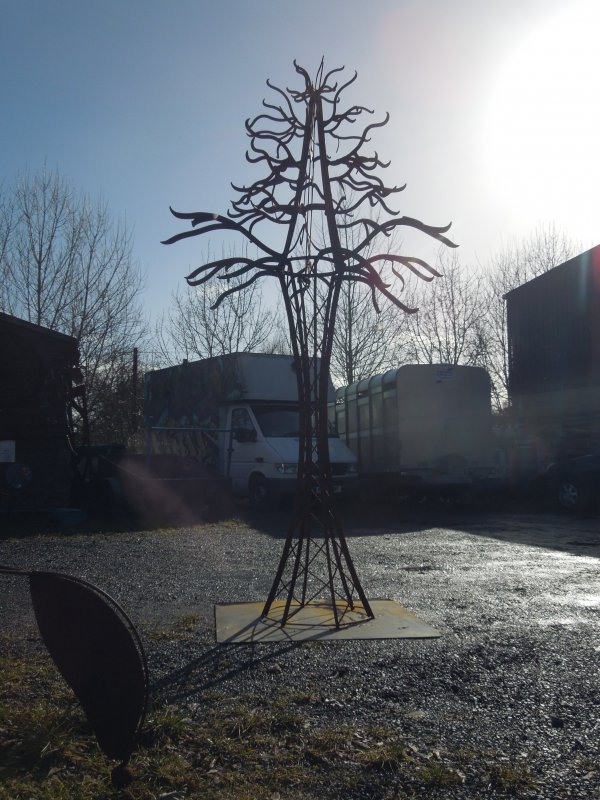

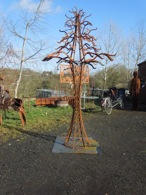

I have been mad busy for ages on a big project that I cant go public on.
But was asked to make a wintery windblown tree. Just the ticket, for ages I have been doing accurate fiddly repetitive work.
So four frenzied days later I ended up with this. it stands 3m tall and the crown unbolts for transit and storage.
The bottom is a simple tapered spiral shape and the crown is all made up of edge bent 5mm strip, 15mm at the top and 30mm at the bottom. All bent using the metalcraft powerbender.
I was very pleased to manage to get a chaotic shape as I am trying to get over my hopeless fixation on repetition and symetry. Thanks to Normspanners for the music.
He sent me a copy of an unobtainable album by a band called Pleasure Beach, perfect an unholy blend of prog riffs, hammond Organ with a bit of New york punk spirit mixed in.
Life here is getting very hectic, house to sell, house to buy, workshop to find 'other people' to 'deal with' doing this was great therapy.
