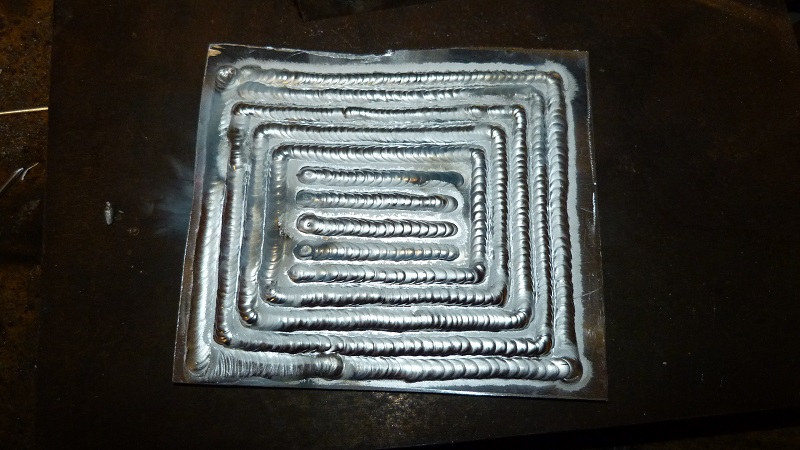

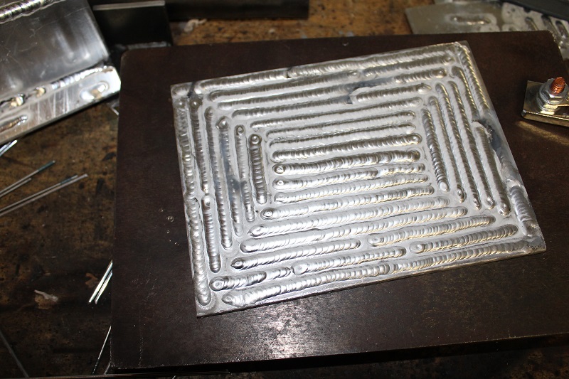

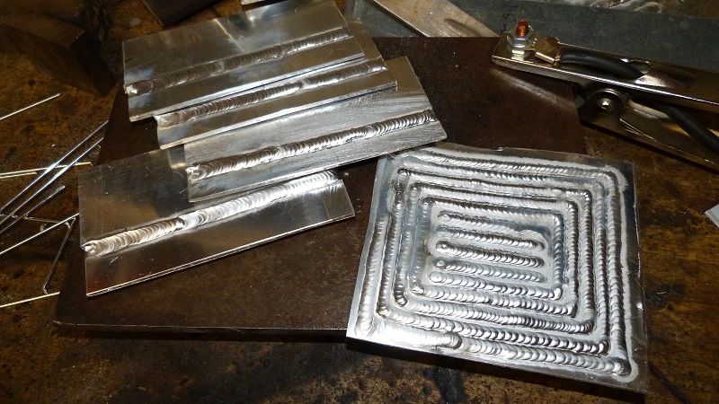

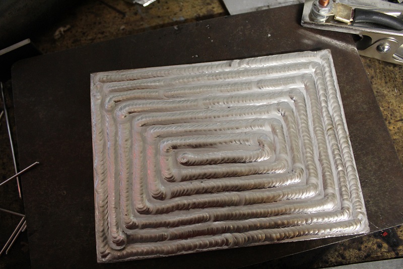

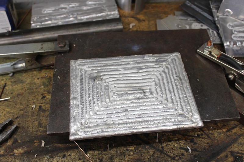

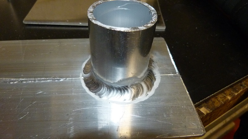

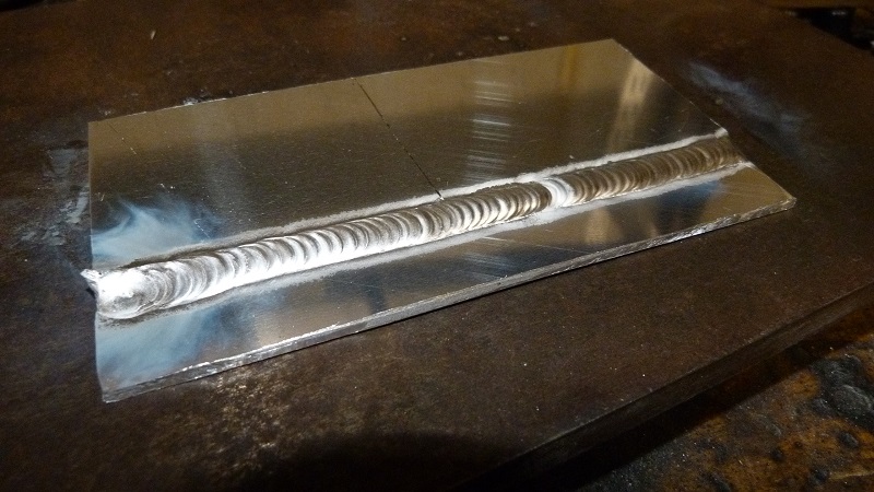

I saw an interesting old video from welding tricks and tips about doing a pad for alloy TIG.
I found that doing a pad for stick welding was very helpful to me so I thought I'd have a go.
The 1050 plate is 6mm thick roughly 150mm by 200m. It's a cheap and efficient way to get a lot of beads down. I still have the other side to weld too and there's another half to go as well. £7.76 bought me a 300mm by 200mm sheet on ebay which I cut in half.
I started at about 150amps at the edges and then increased the power to about 165amps. 2.4mm blue tungsten and 2.4mm wire, 180hz. Managed to touch down about 8 tungstens, usually at the ends of the weld run when my right arm was running out of easy travel. Welder is a AC/DC Stealth. My craters are getting a little better with a 1.5 second downslope plus a backstep and late fill but I am wondering if the thick material is helping and masking problems. On 3mm coupons the crater sometimes went nearly all the way through but the ones made here are well above the parent material. It has helped me get a bit more familiar through watching the weld and understanding how it behaves. The ac buzz gave me a stinking headache by the end of it. It was a good test for the welder and torch.
Still can't feed the wire even if my life depended on it.
