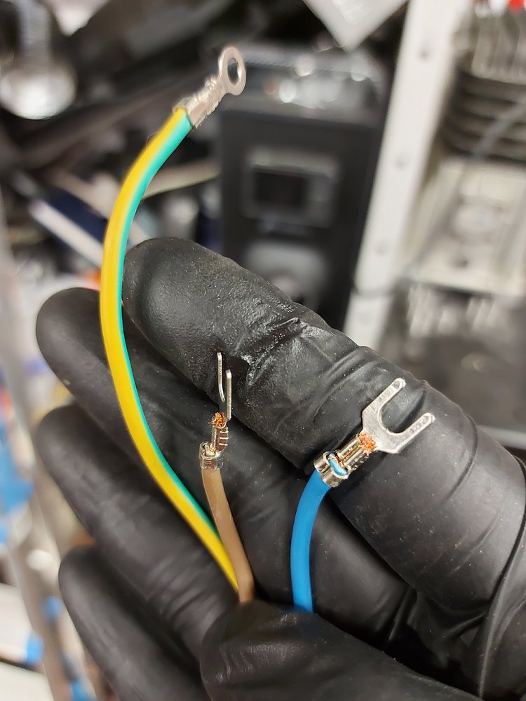

You're getting anal, why attach to the insulation and wearing gloves doing electrical fittings.Is it possible to purchase a kit to allow a mere mortal to achieve crimps like this
These are crimped very tight onto both the cable strands and the sheathing.

Those aren't actually perfectIs it possible to purchase a kit to allow a mere mortal to achieve crimps like this
The portion that crimps the insulation isn't particularly tight. I'd say that's not the right terminal for the wire diameter.

Beat me to it - looks pretty damn good.It's deformed the sheath without tearing it,
Too tight you cut the sheath and it slides off
Guide from te
Those are as they should be
You need the correct crimp tool and connector and fit to the right size cable
You can't do these with the wrong tool or pliers ...
but not if you want a reliable connection..It's amazing what you can do with pliers as a poor apprentice crimping connectors on your motorbike to keep it on the road
