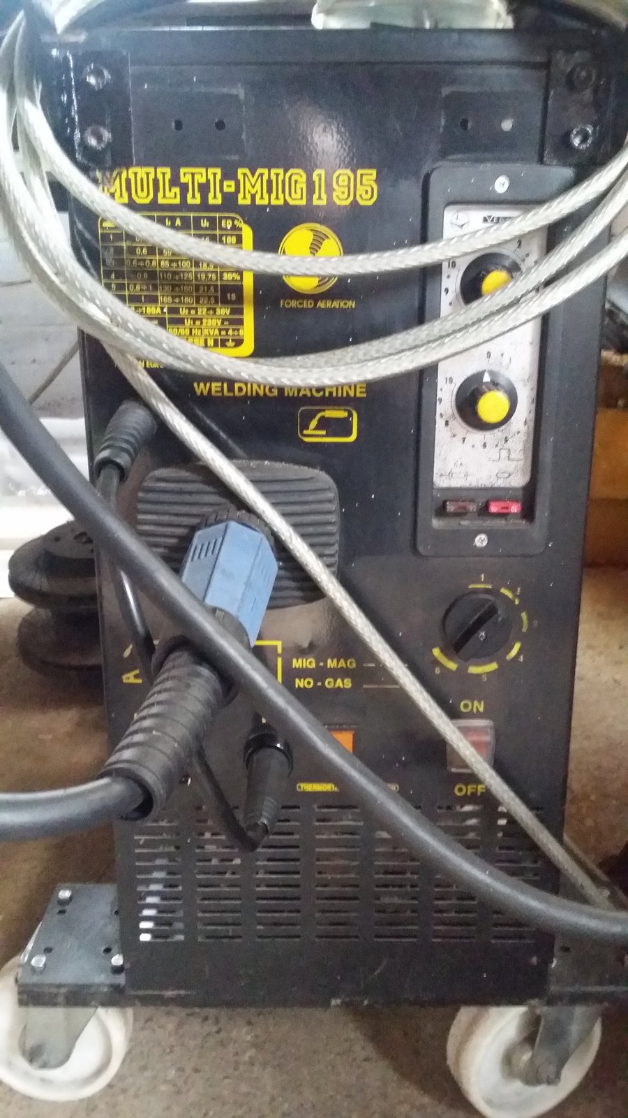

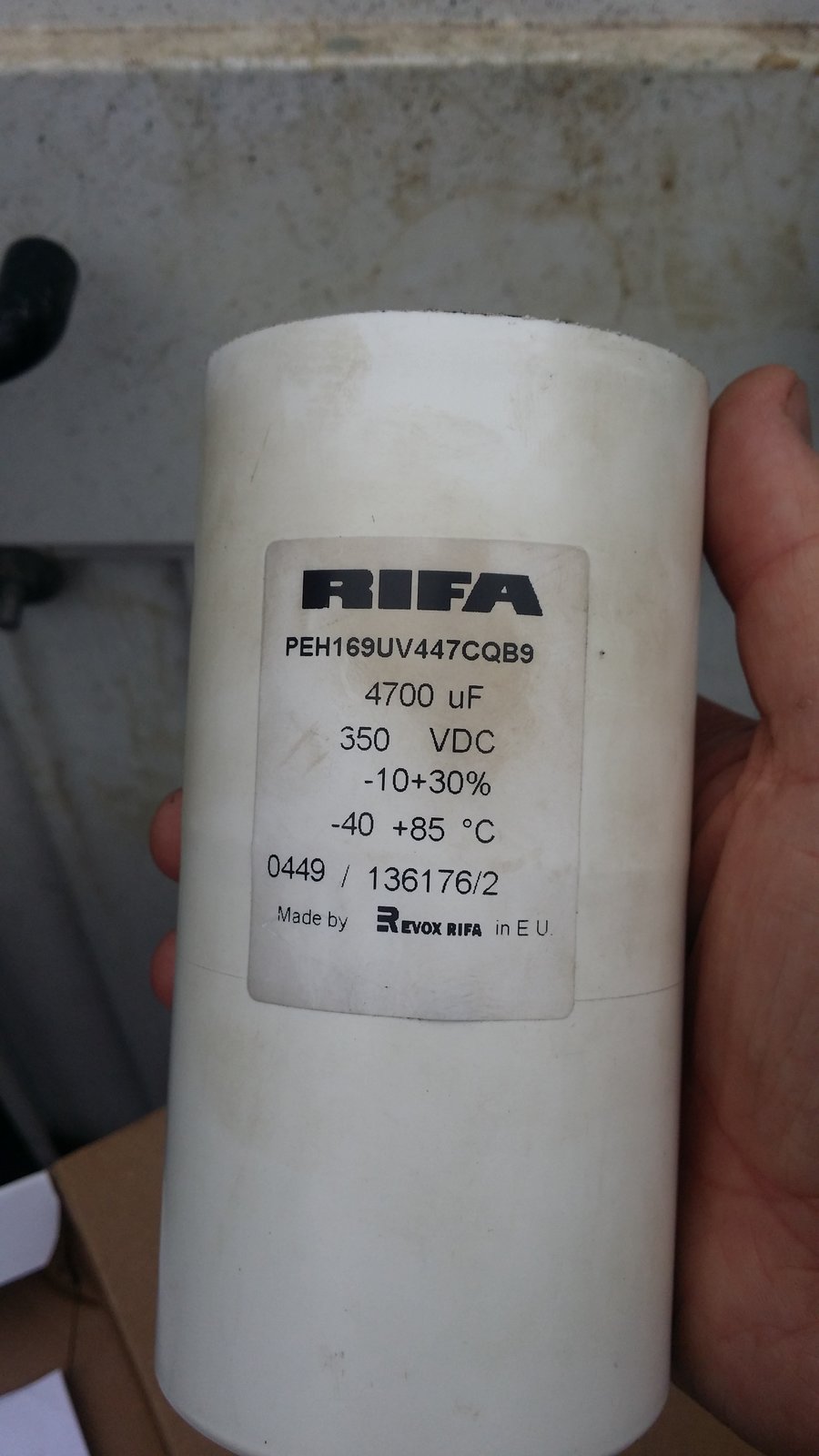

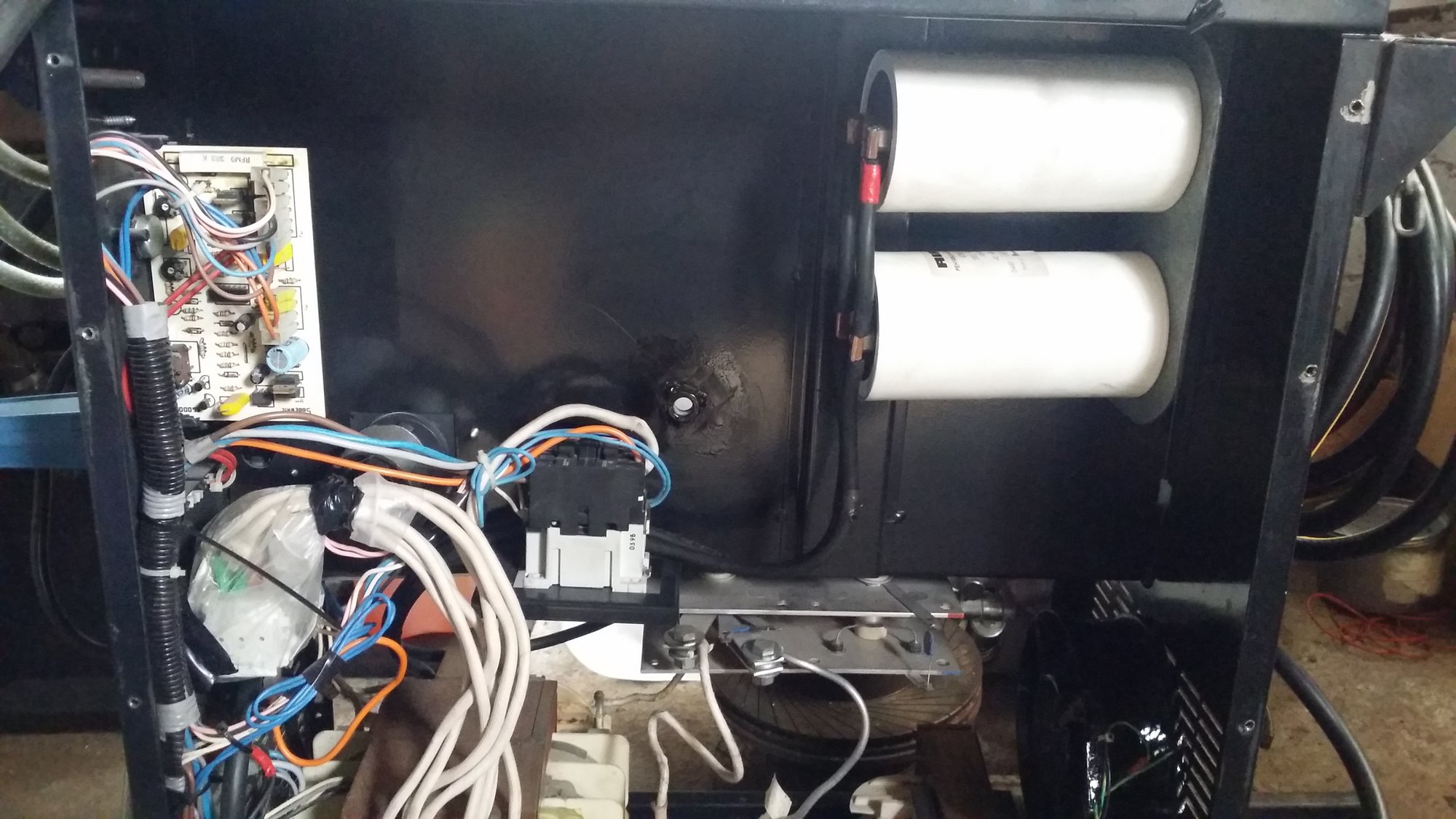

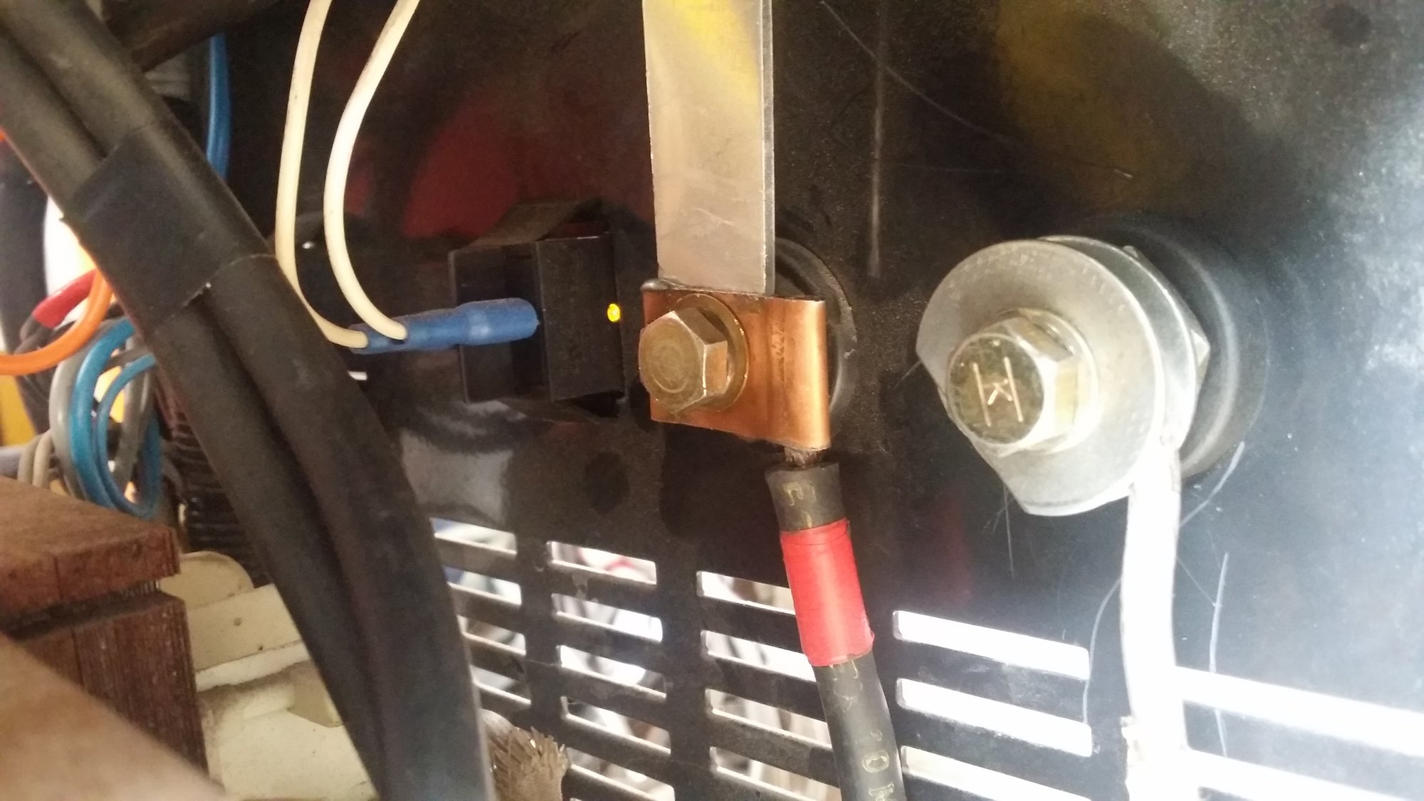

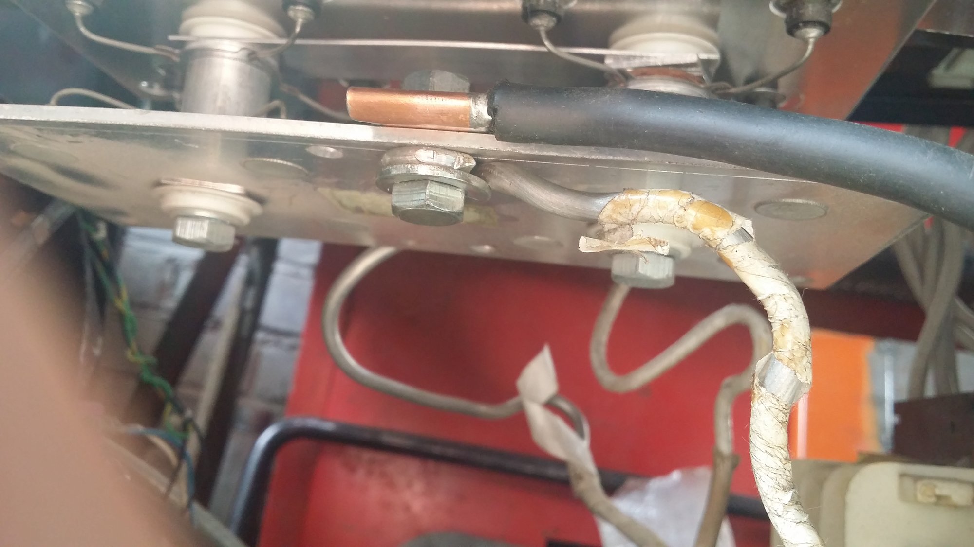

Hi all just wondering if anyone has added capacitors to a mig welder that didn't have them designed into them before hand.i know it will add a bit of heat to the weld.and some will say sell it and buy a better welder but I bought this mig spares or repairs so not much to lose fixed it's problems and now running OK but starts welding cold then the weld flattens out as you go using mixed gas.
