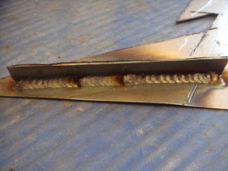

Of the two the one on the left as each dimple along with the more sharply stepped freeze line on the right is a massive stress riser
What are you practicing, overlapping spot welds or trying to make MIG look like TIG? The former has it's place with things like bodywork on French cars (tissue paper thick steel), i don't really get 'MIG like TIG' personally- doesn't add any useful properties to the joint, can reduce them and kinda defeats the point of MIG. Speed
Looks good.

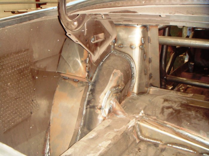

How are you going to close the blanking panels wheel arch to wing for fire proofing If you are having internal tank?
