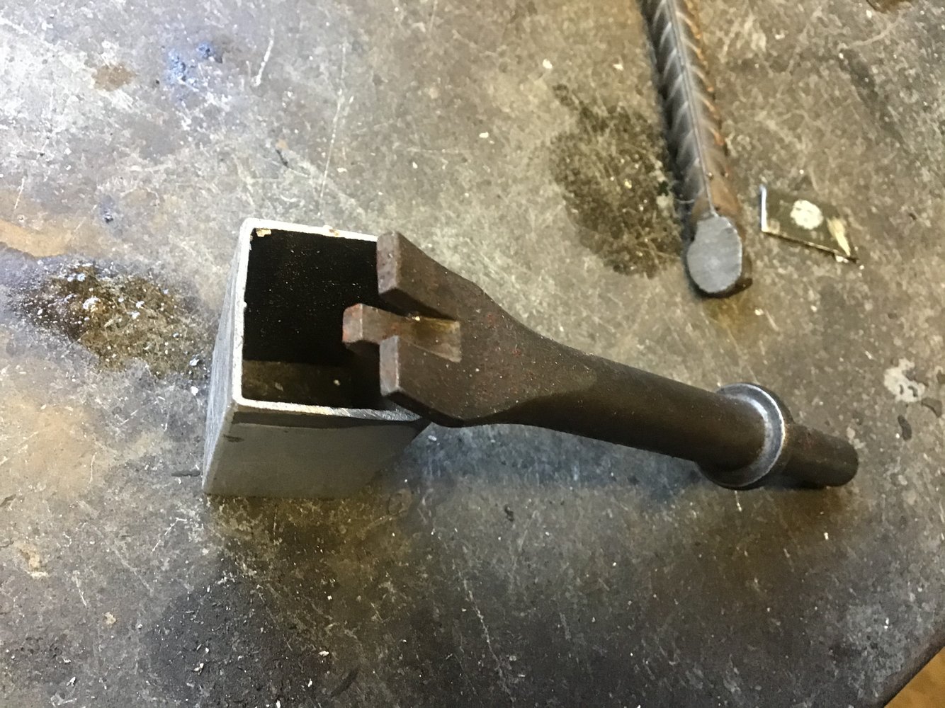

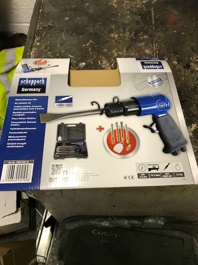

They use them on the race rescue units as there is no spark danger. I’ve used the one that came with mine a few times. It’s very good at what it does but not something I use a lotThere is also a chisel that isn’t normally supplied for cutting panels, a chisel with a little slot & a hook like blade out of it. It cuts a slot coiling up a strip rather like a Monodex does. I’ll see if I can find it & post a picture in a bit.
brilliant for cutting up in to car wings and thin steel sheet without distortion. just drill a hole to start it off in the middle of a sheetThere you are, got a picture for you, cost me 50p from an auto jumble, not sure if I’ve used more than once or twice

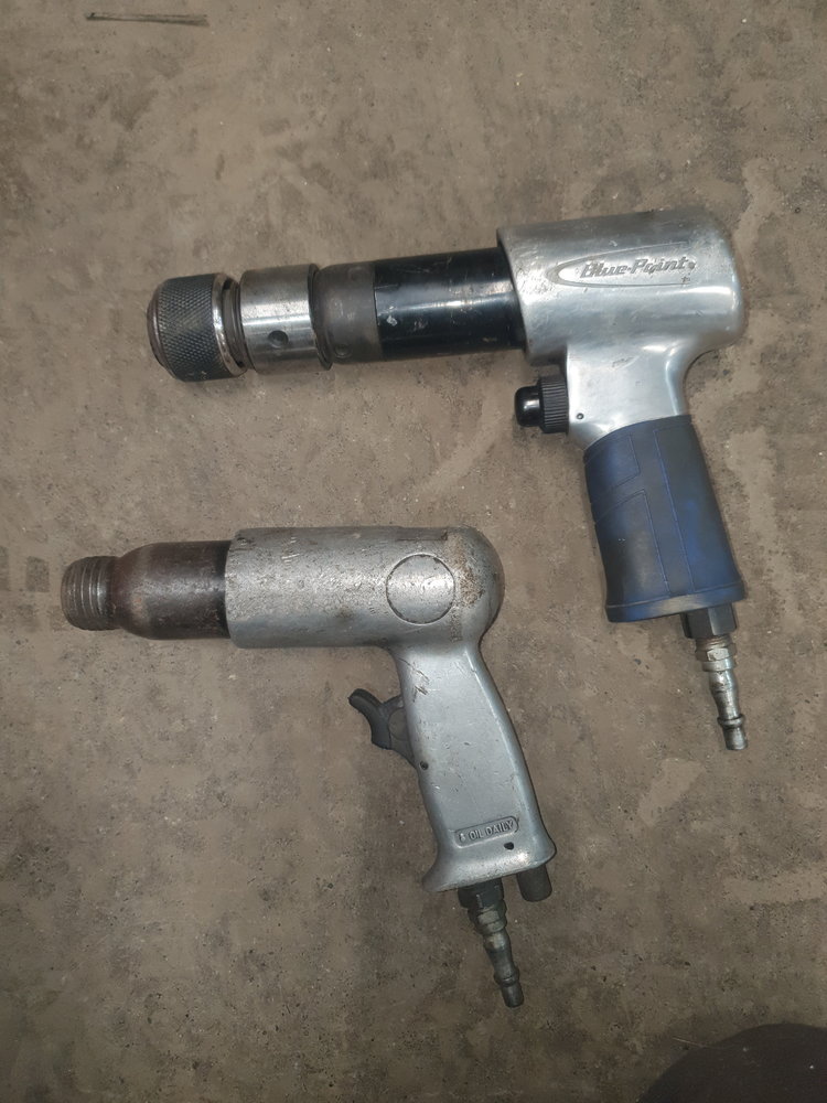

a compressed air slide hammerAwesome tool for car work. I have an identical gun I bought in lidl years ago and a heavy duty blue point version.

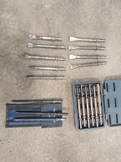

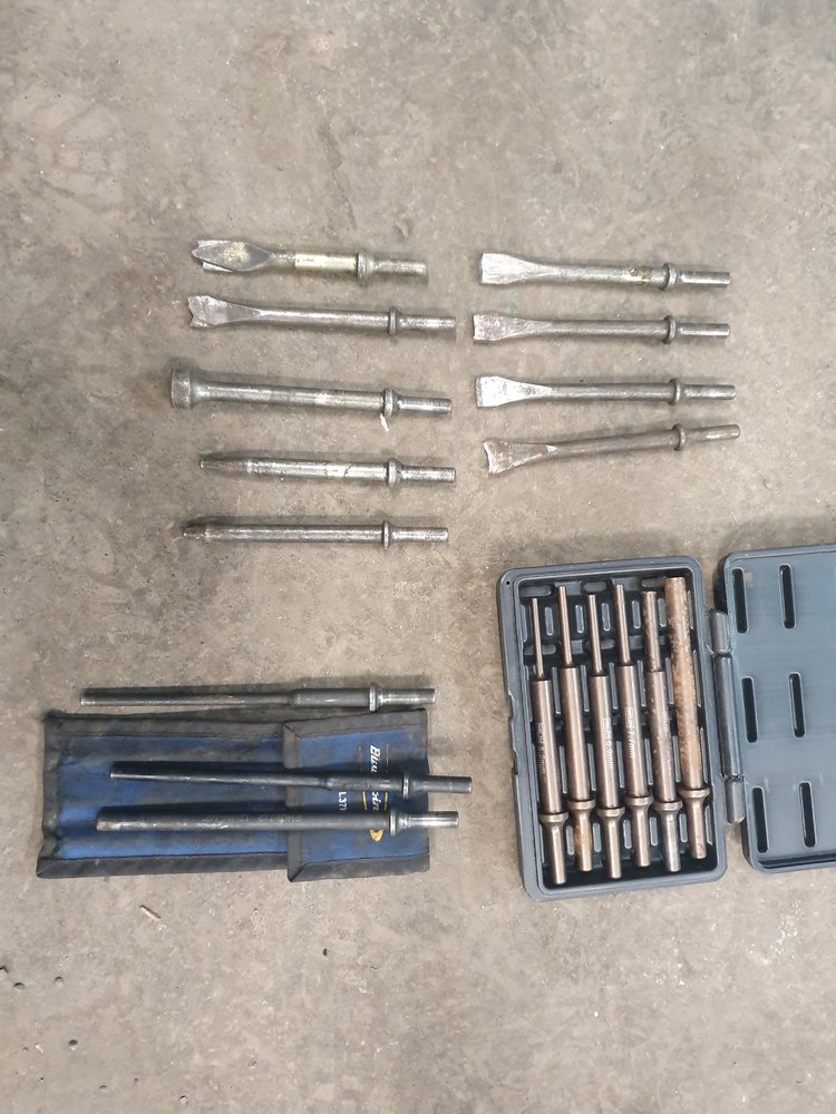

The parallel punches, the pointed ones and the hammer head are the ones I use the most.

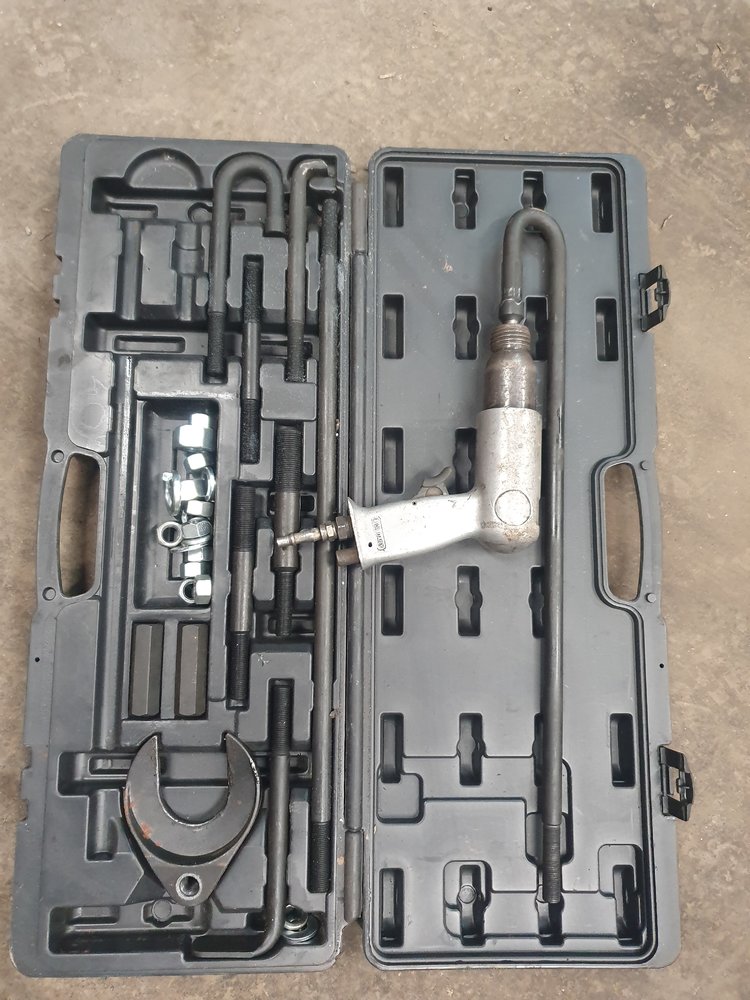

I have one of these sets to go with it too, it allows it to be used as a puller.

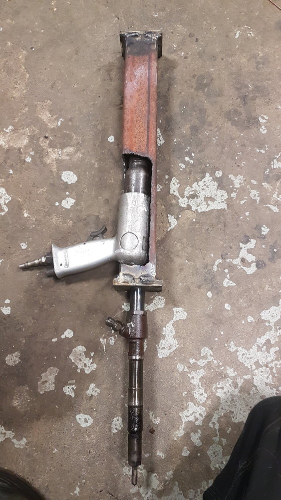

I made this up to use it for removing seized VW injectors
