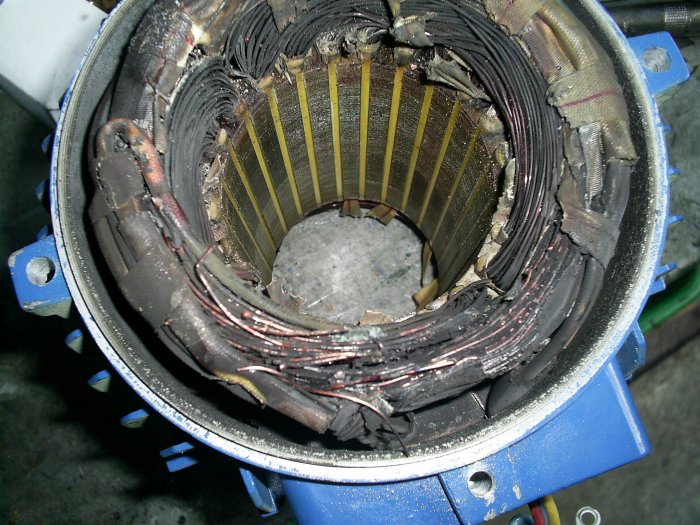

Ford34/2, that is what I am asking, what is the recommended speed of the particular pump that I have got. Its a Fiac pump , I am told it is a 14cfm unit and the pulleys, I think ,are the original ones. I got it from an auction and it came with the safety cage and belt. The motor has been found to be dead. Hence I need to ensure I get the correct motor.
sticking my neck out, but I think if you say this is a 14 cu Ft pump then, 500-700 RPM might well be right, but sadly this is a gut feeling and not based on any manufacturers data. Fiac pumps may well be totally different to Ingersoll Rand.
It may be possible to establish if the knackered motor is 2 pole or 4 pole, by pulling it to bits, but I realy dont know. Maybe an Electrician member can help.
