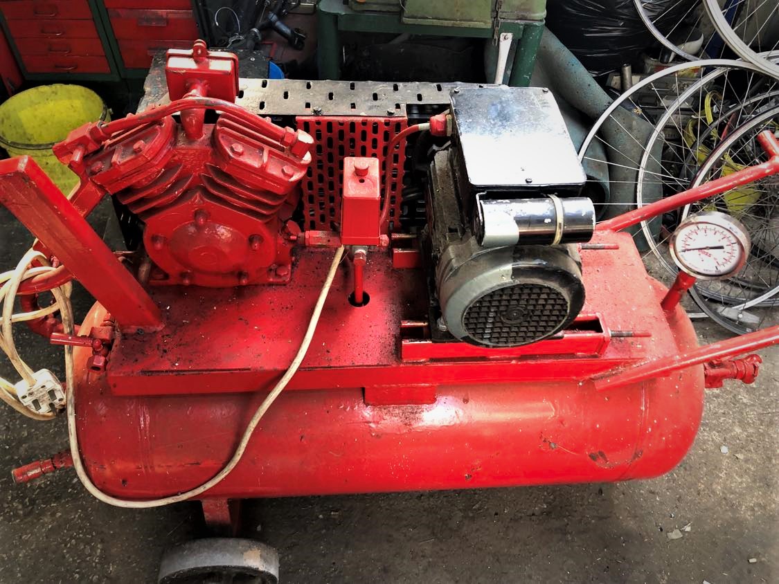

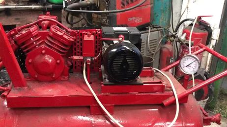

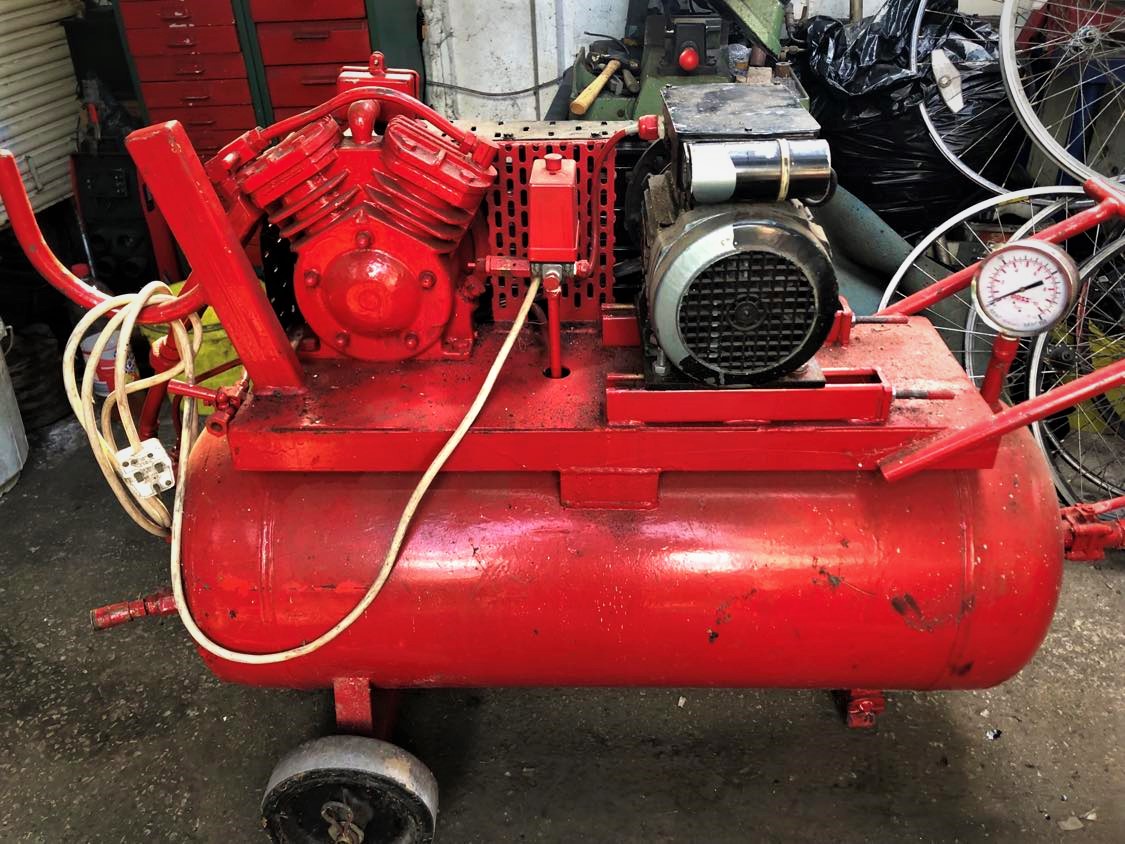

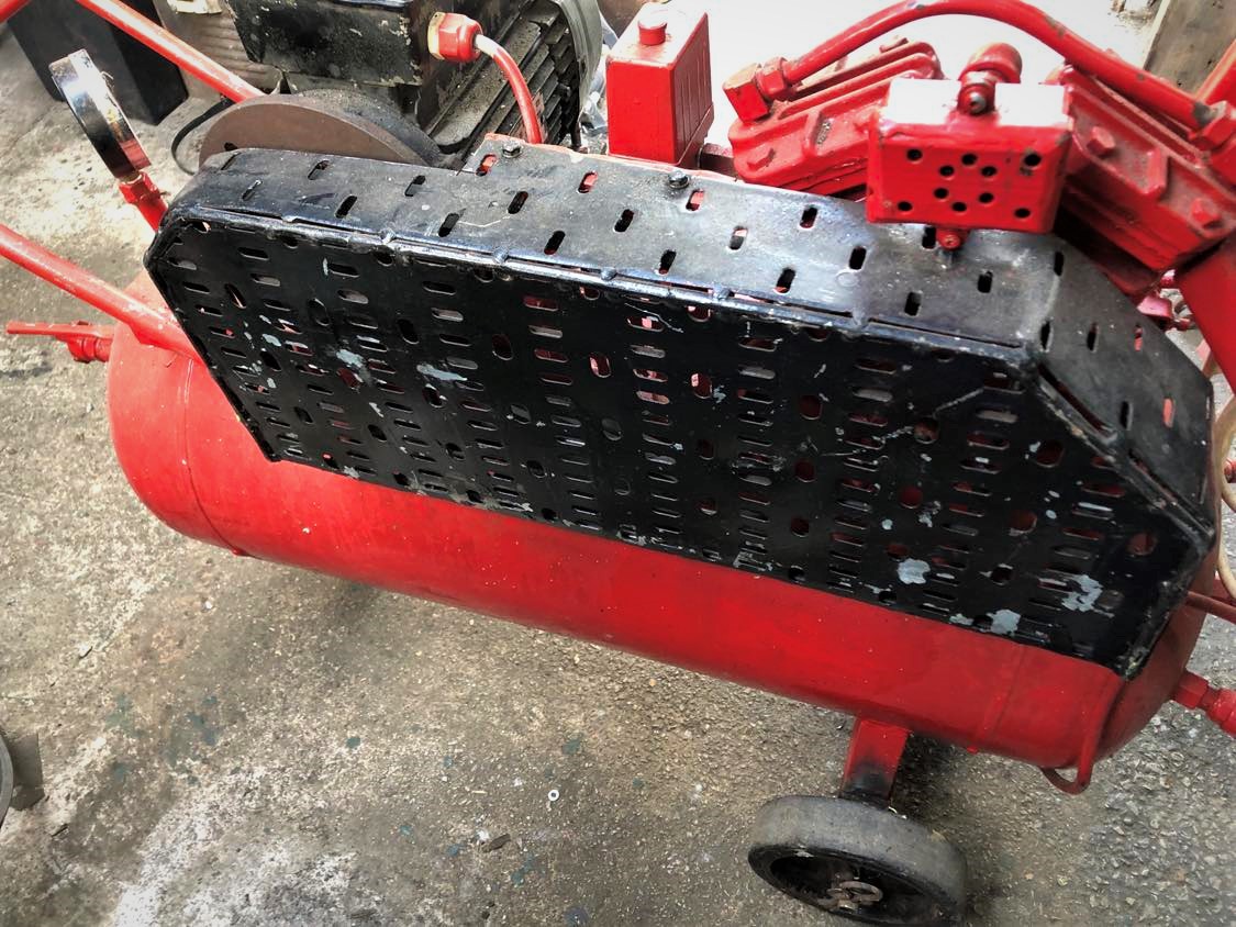

I built it about 8 years ago, used and works well.
Tank is a large size propane cylinder so around 100ltrs.
240 volt single phase.
3 horse power motor.
Auto start / stop.
Runs off a 13a plug.
Wheels on one end, handle on the other.
Tank outlets are pcl female + 1/2 bsp ball valve and condensate drain valve.
