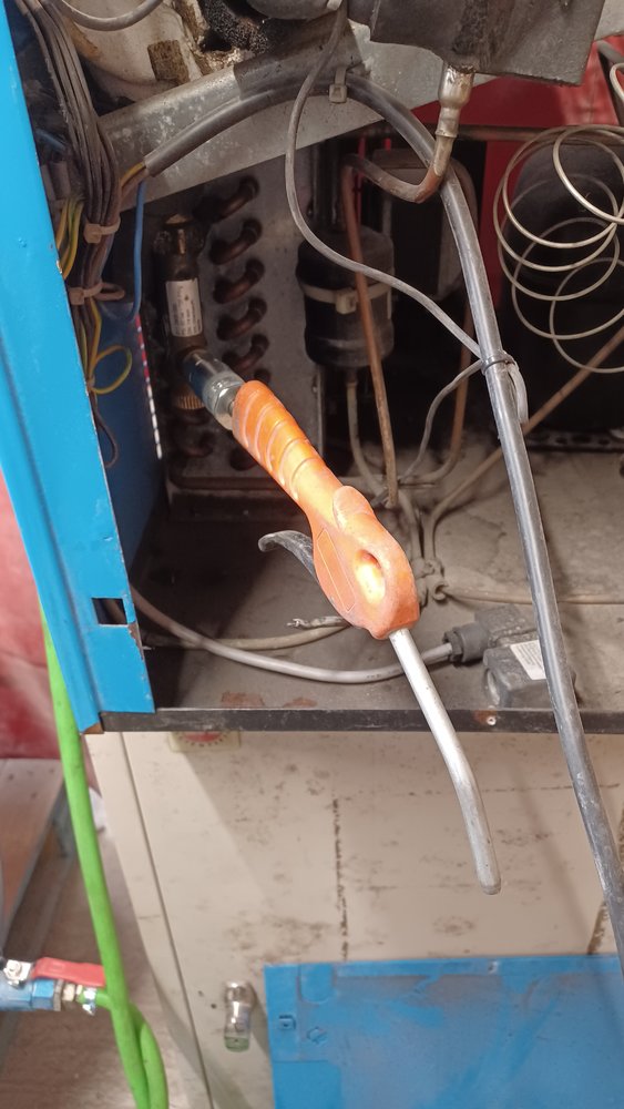

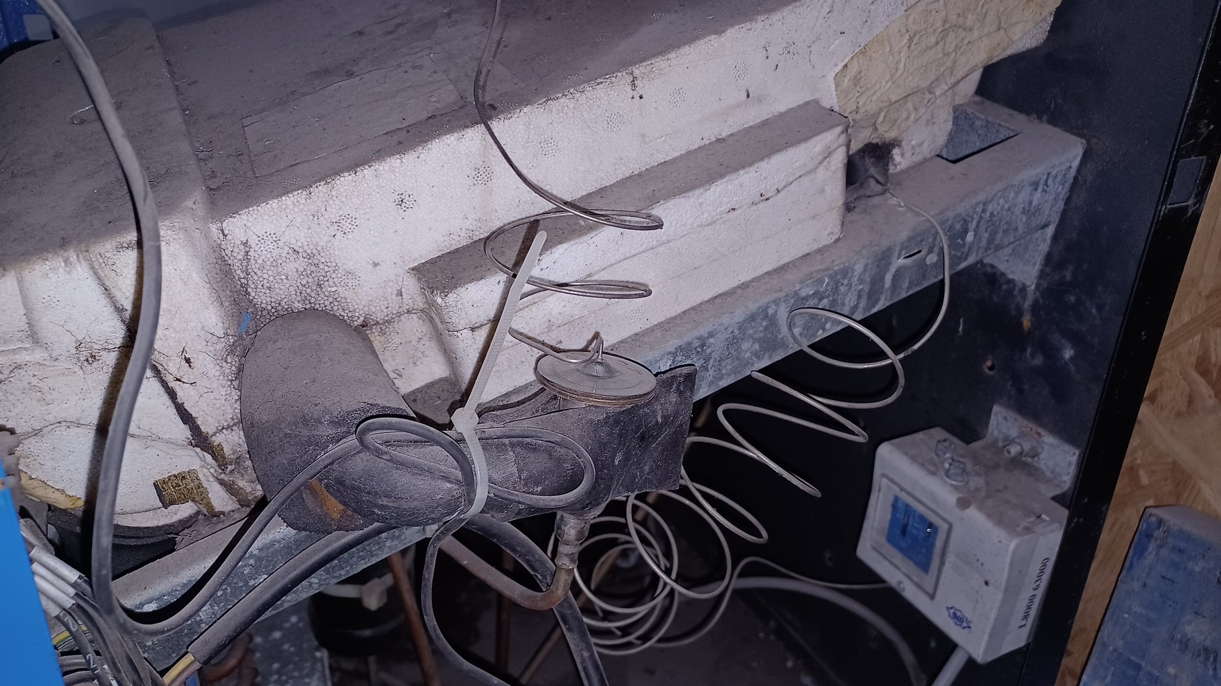

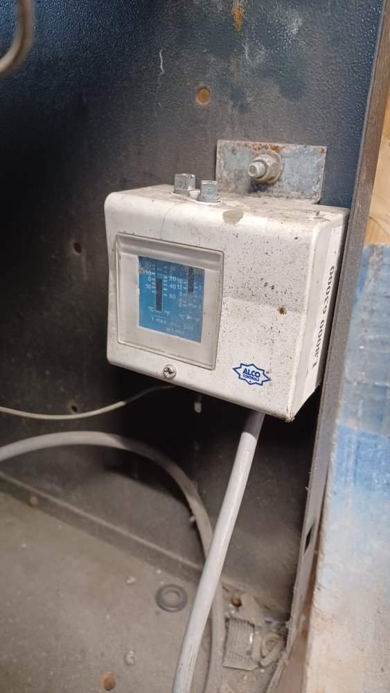

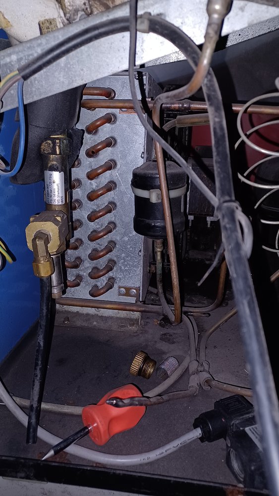

I've got an old'ish Boge air drier that doesn't seem to be able to dry air. Today I turned it upside down and used brake cleaner to get any left over oil/water out and made sure the drain is clear and dry.
The fan comes on straight away and the cooling system seems to be getting cold
But it can't get the air moisture down. At the moment it's disconnected from the compressor and is at 96%humidity.
Is there anything I can do or as its so old is it best to buy a new one.
Thanks
Darren
