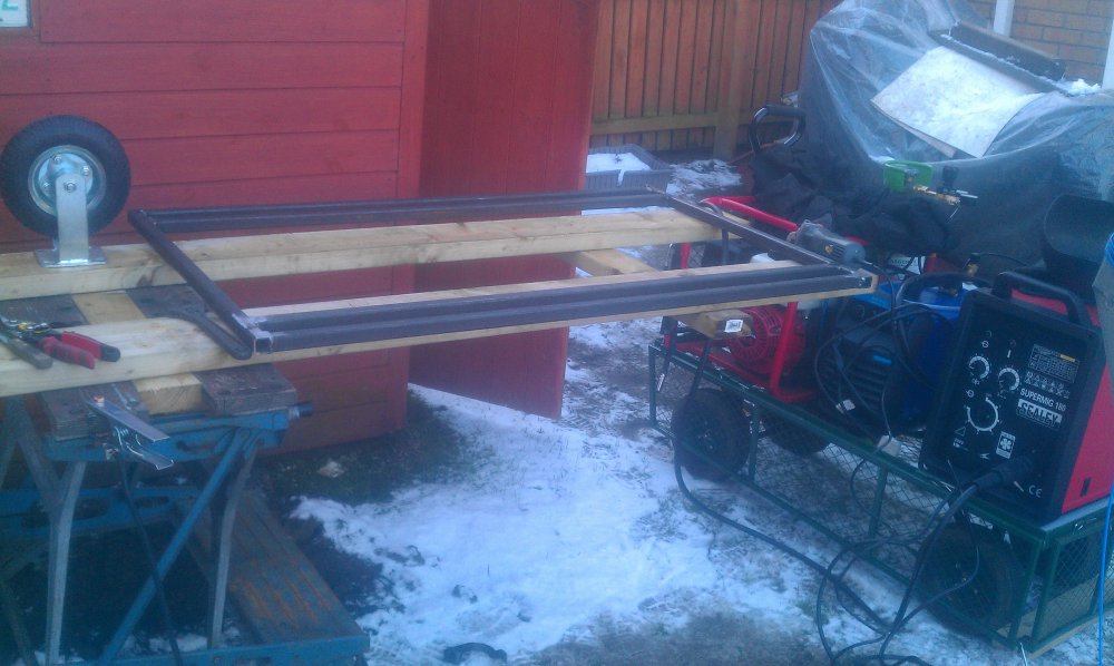

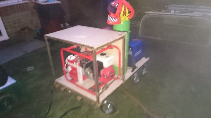

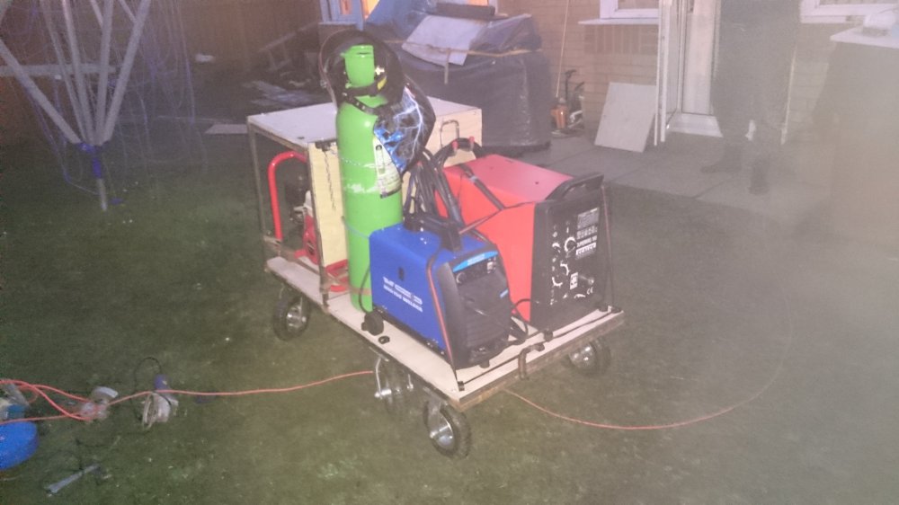

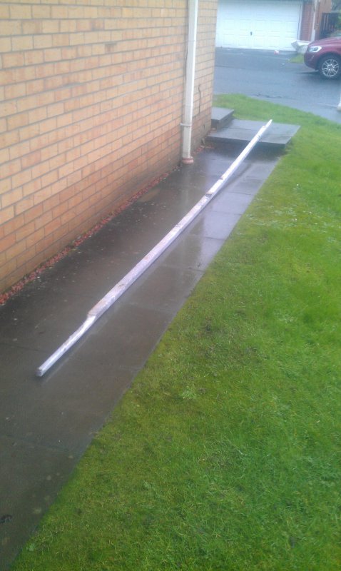

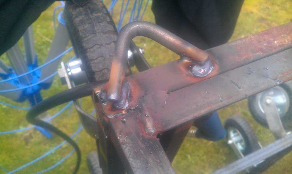

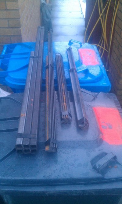

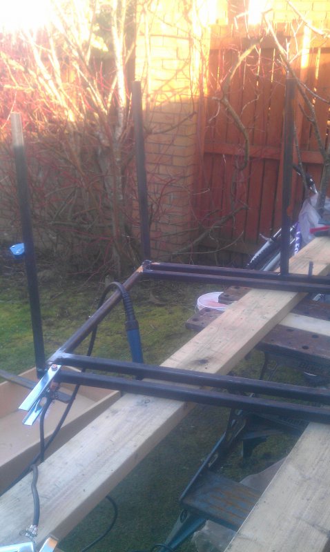

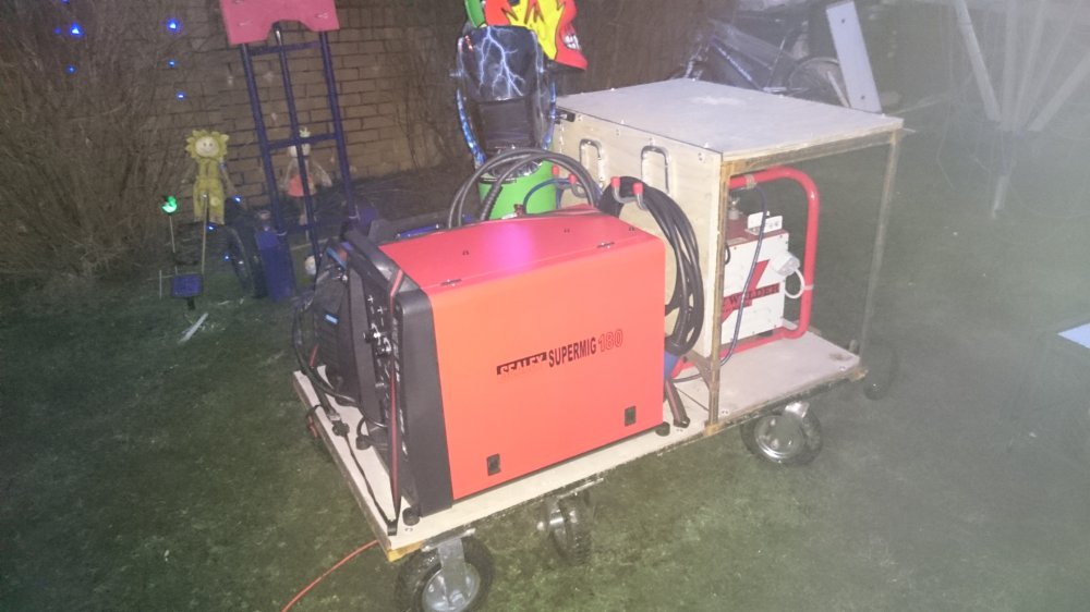

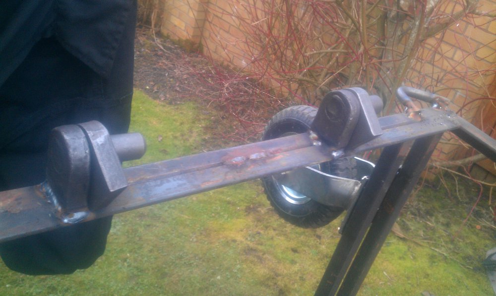

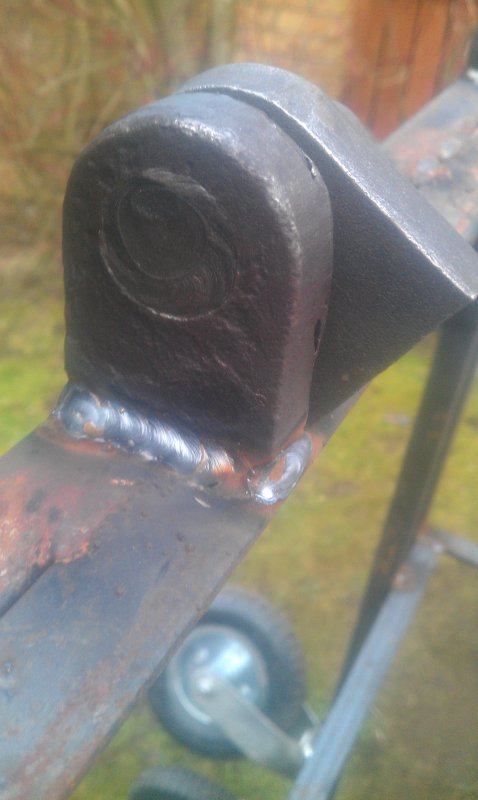

Hi Guys and Gals, thought you may be interested in this, I'm building a 6 wheeled rough ground welding cart to transport my welding gear wherever I need it

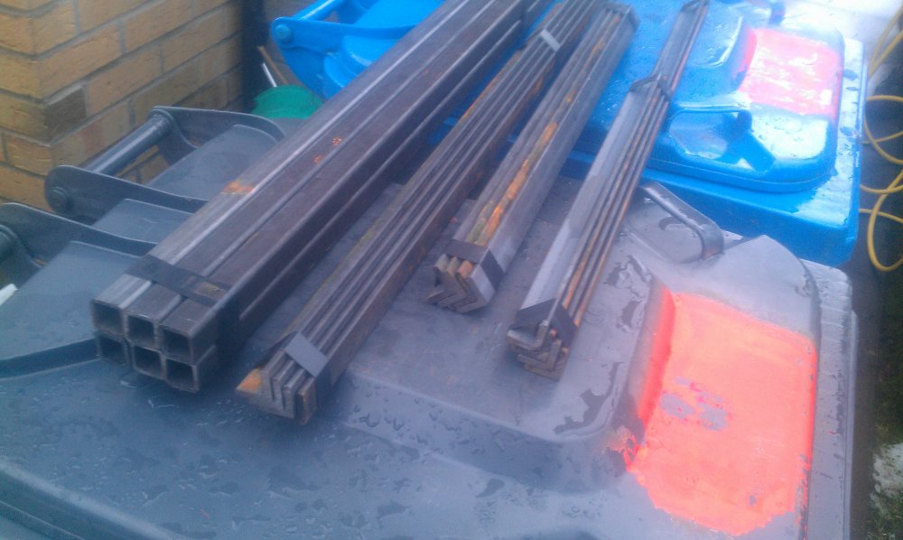

Materials I bought were:
6m x 25mm x 3mm box section
10m x 25mm x25mm x 5mm angle iron
10m x 50mm x 5mm flat bar
4 x 8inch swivel castors
2 x 8inch fixed castors
8 x trailer hooks
2 x gate hinges
And a couple eye bolts
Here's the start and will update thread on progress....

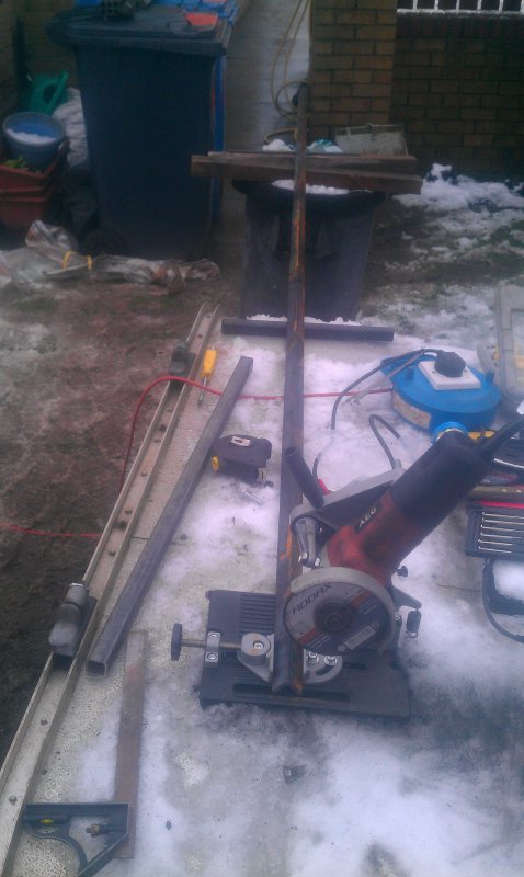

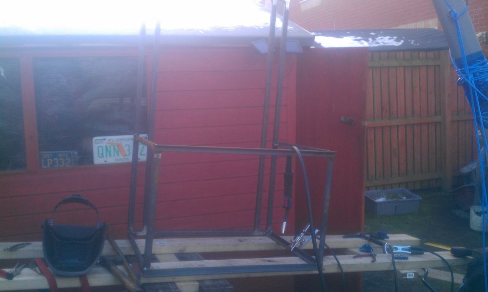

So far steel arrived and is now cut, I have all the pneumatic castors all ready for assembly, should be welding and tomorrow....
