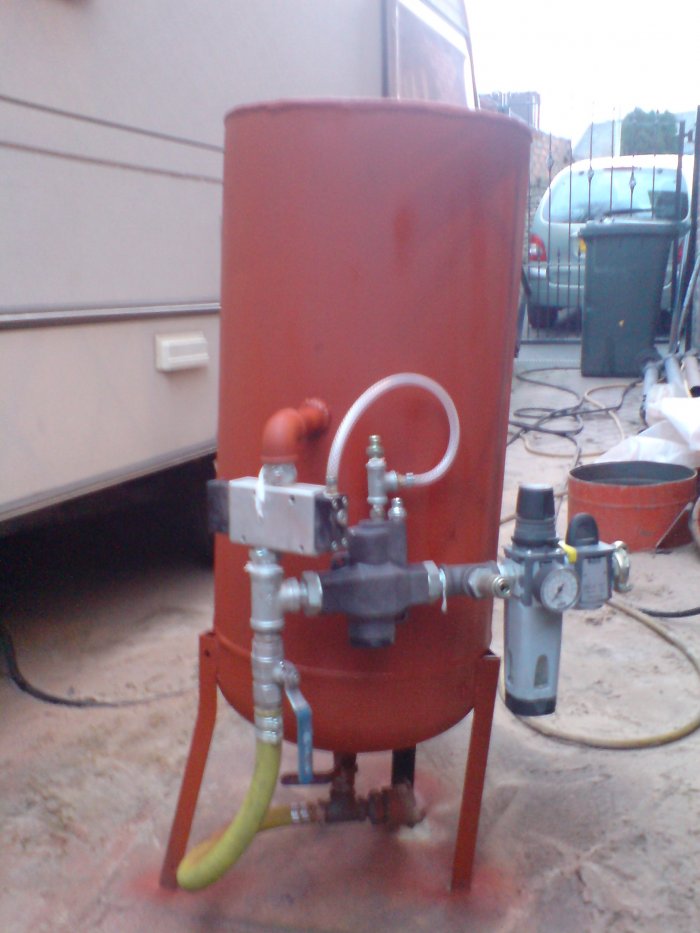

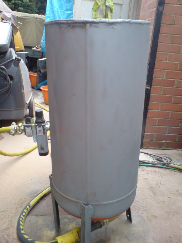

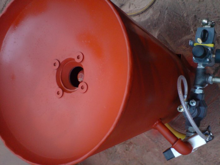

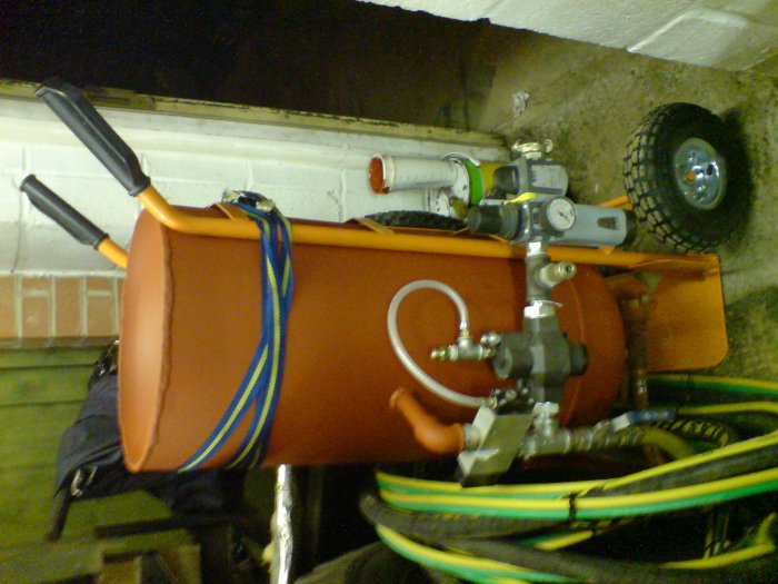

Been meaning to do this for a while. Got one of the small blast pot's of ebay and goit a bit fed up of the slow progress. Buying a road compressor helped, but gave potential for a lot more `performance'. So I worked out something on the same principals but with a few extra features and upgrades.

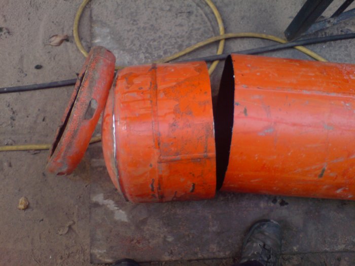

Used a 47kg propane cylinder and removed the valve. Handily it was a 3/4 bsp fitting, so this would be the bottom outlet for the sand.

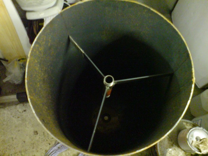

I cut the bottom off the and inverted it to create a filling hopper.

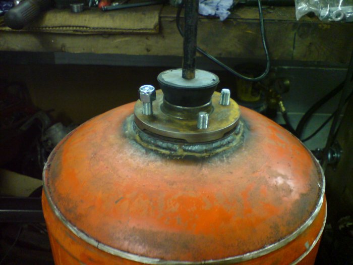

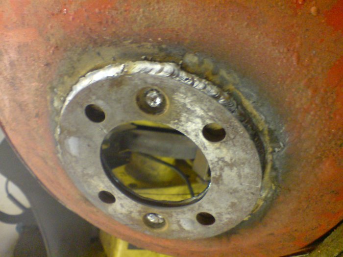

I turned up a few flanges to create a filling hole and added a pop up valve.
