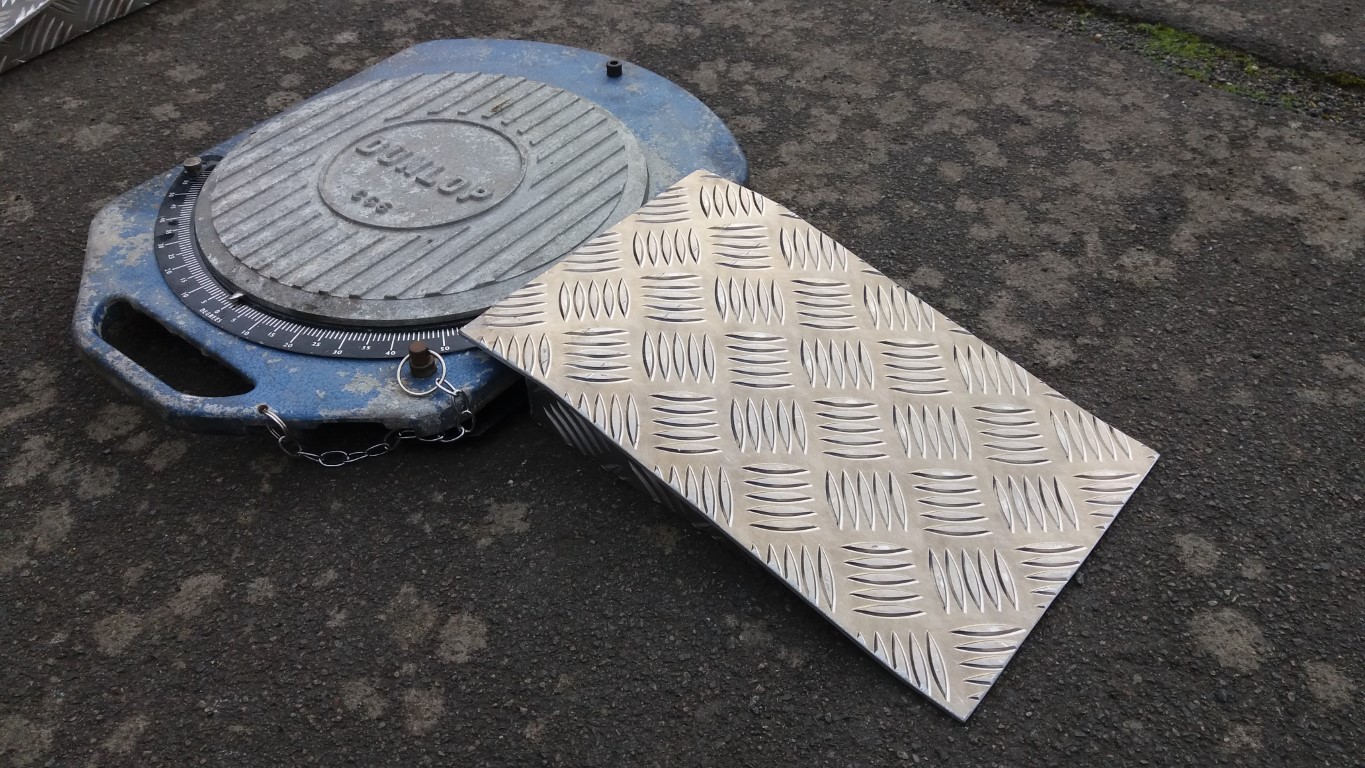

A little job for a fellow forum member, ramps to put a car onto turntable wheel alignment gauges,

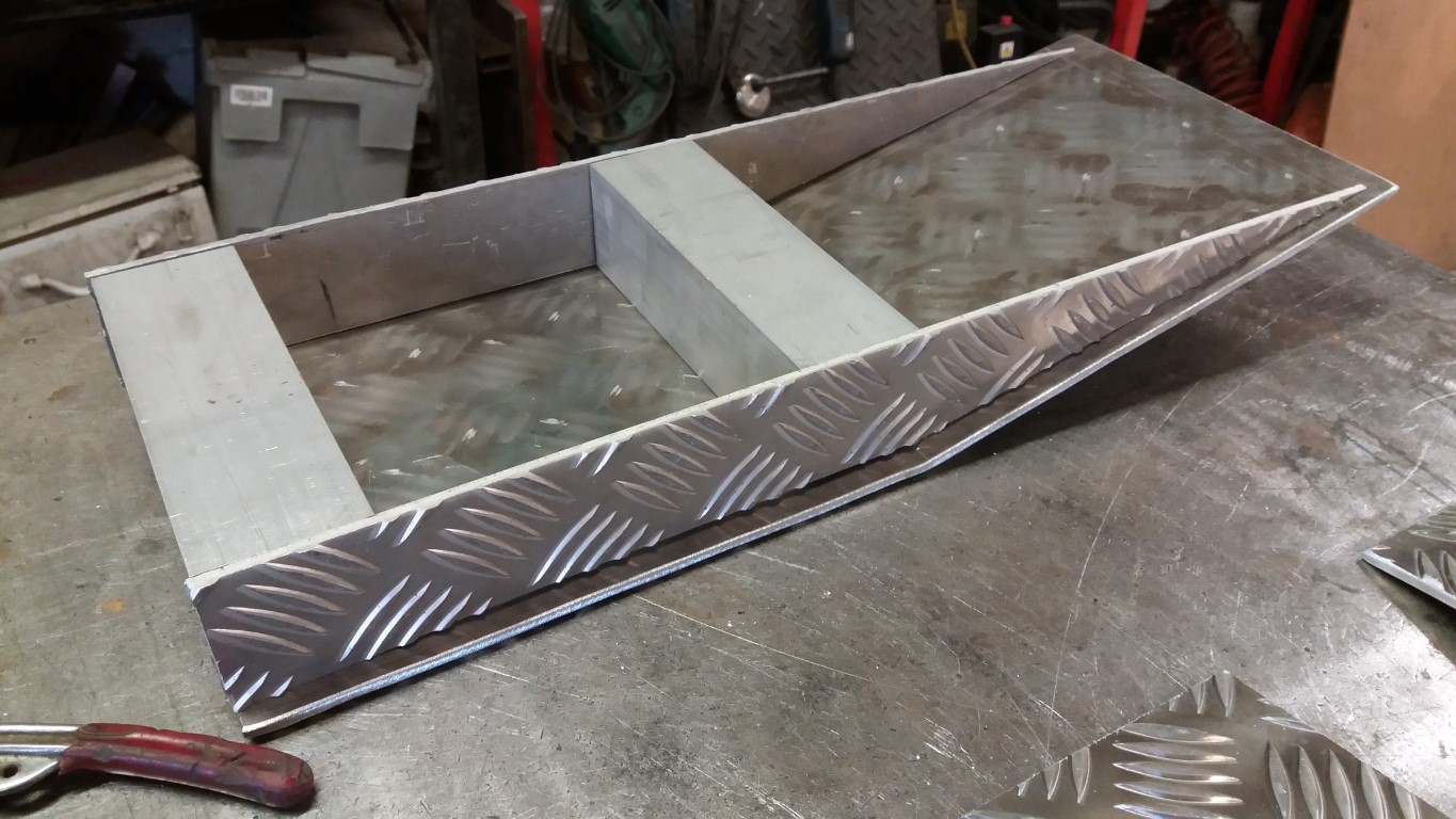

First cut some ally treadplate and put a bit of a bend in it in the press
Cut some ally channel for cross members, and treadplate for the side plates, and fab it up,

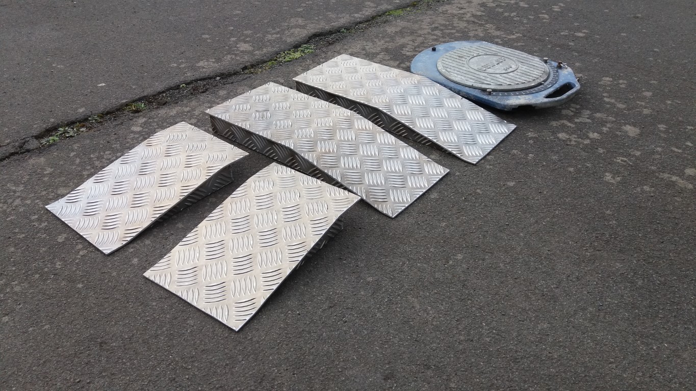

And finished, the short ones are for the turntable, the longer ones are for the back wheels to keep the car level. tested with a couple of tons of Peugeot estate and they work just fine
