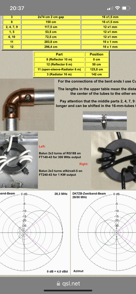

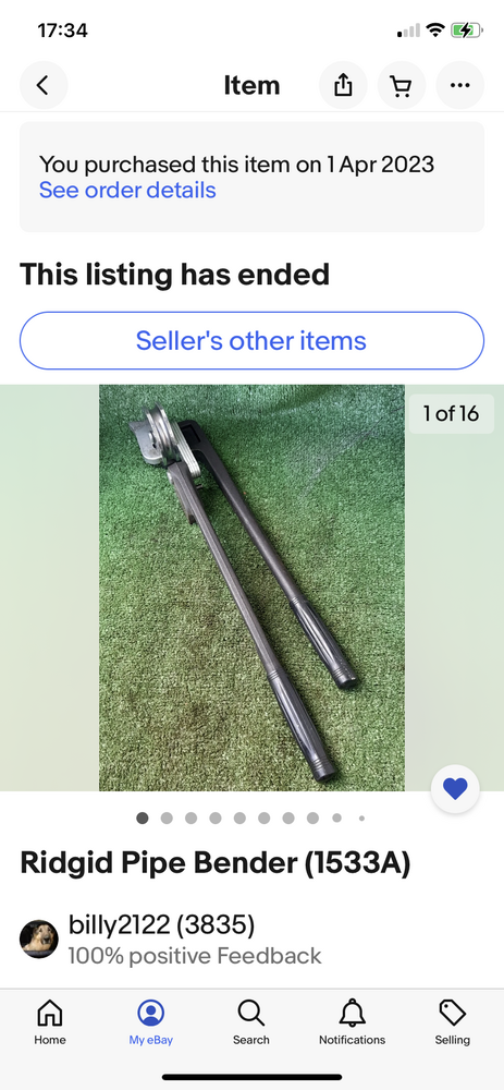

Im having a go at an antenna project that requires some 90 degree bends.
The tubing Ive ordered is good quality 6063T6 1/2” 16swg, and I dont really want to mess it up as I havent ordered enough to practice. Been looking at pipe benders, the options at reasonable cost are the mini copper brake pipe benders that go up to 10mm, or the 15/22mm plumbing type pipe benders.
Would one of these be the best option, or can i bend it successfully by hand round a suitable former, I have various diameters of ally or steel bar that I could stand vertically in a vice to form the bends around, or will I kink it ? Thanks
