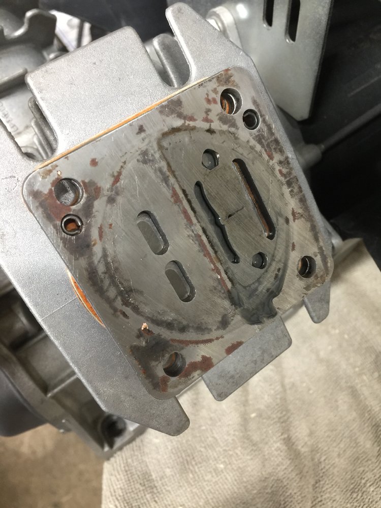

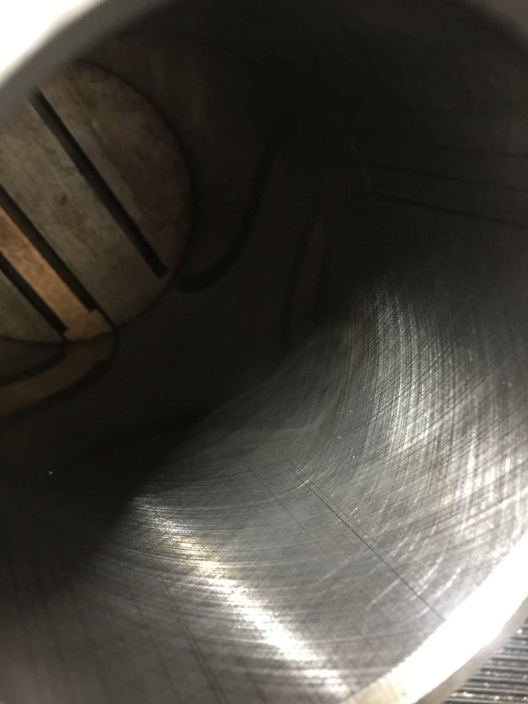

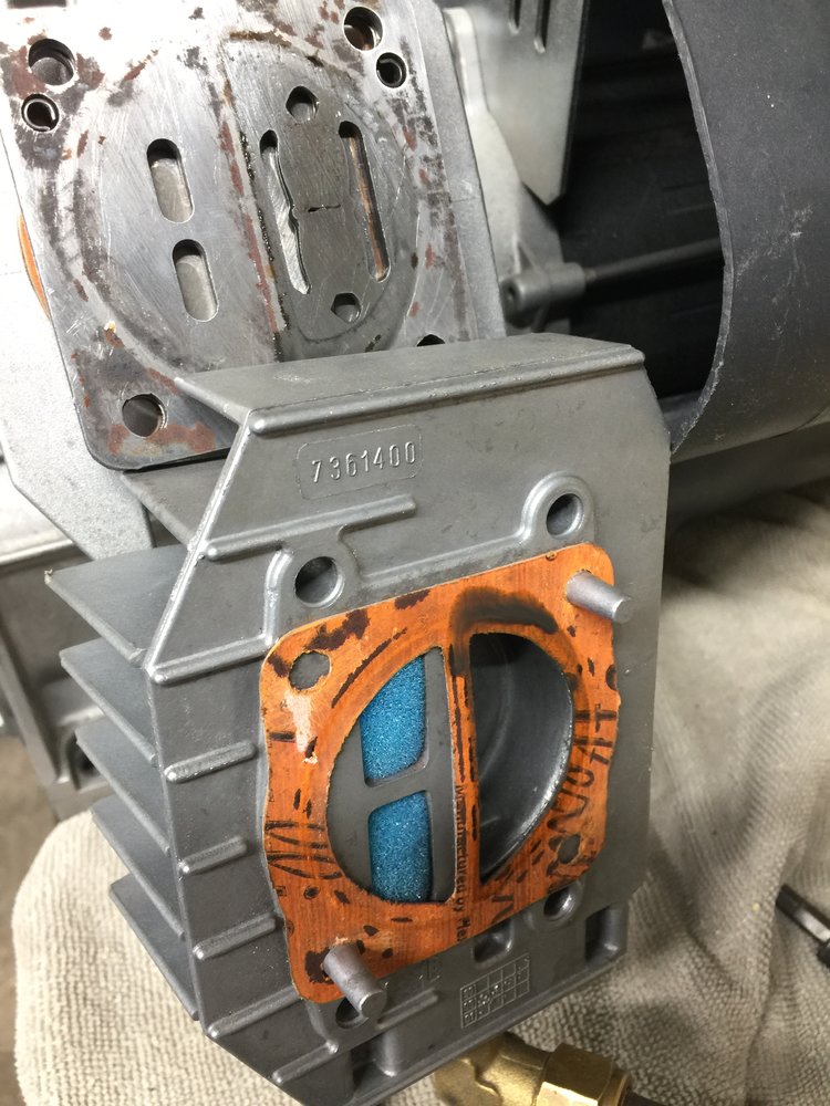

Stripped it down once again and found oil in the head with more scores on the cylinder:

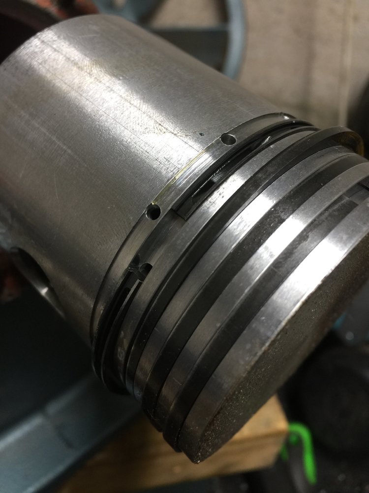

The piston looks similar to the ones you get in oil free compressors with those rubber compression rings :
I'm now trying to hypothesise as to why this is happening. I can think of two things:
1. Piston misalignment with crank. I initially assembled the piston to the crank first then placed the cylinder over the piston. I've noticed a gap between the piston end and the retaining circlip.
2. Piston seal rubbing with an imperfect cylinder wall, trapping bits of metal in the oil and scoring the bore. Allowing oil to pass through over time.
Any ideas on where to go from here?
