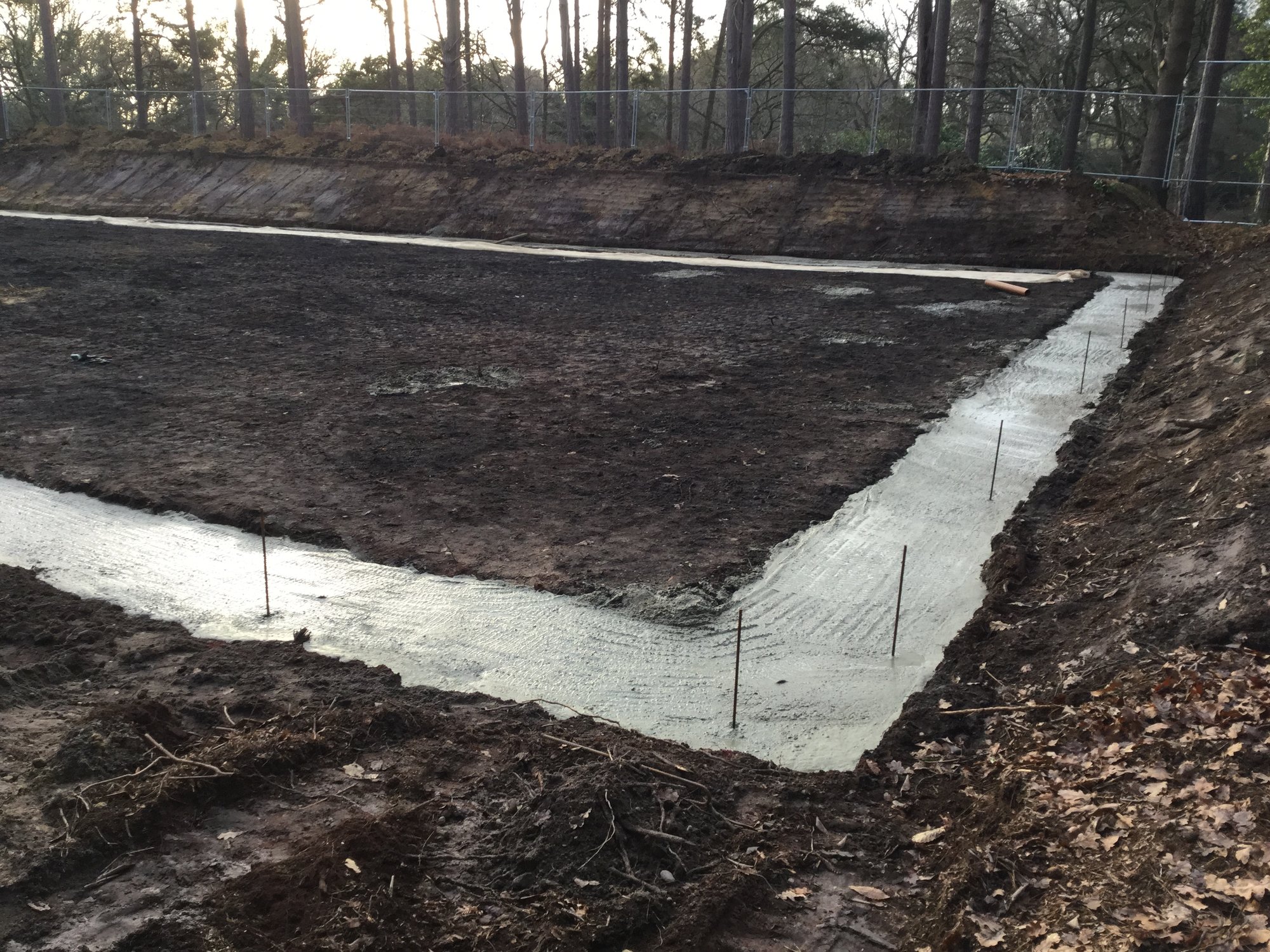

Has anyone used ground anchors or retaining wall anchors ? How do they work and where to get them , i know the concept just need to know where and how ? Thanks in advance

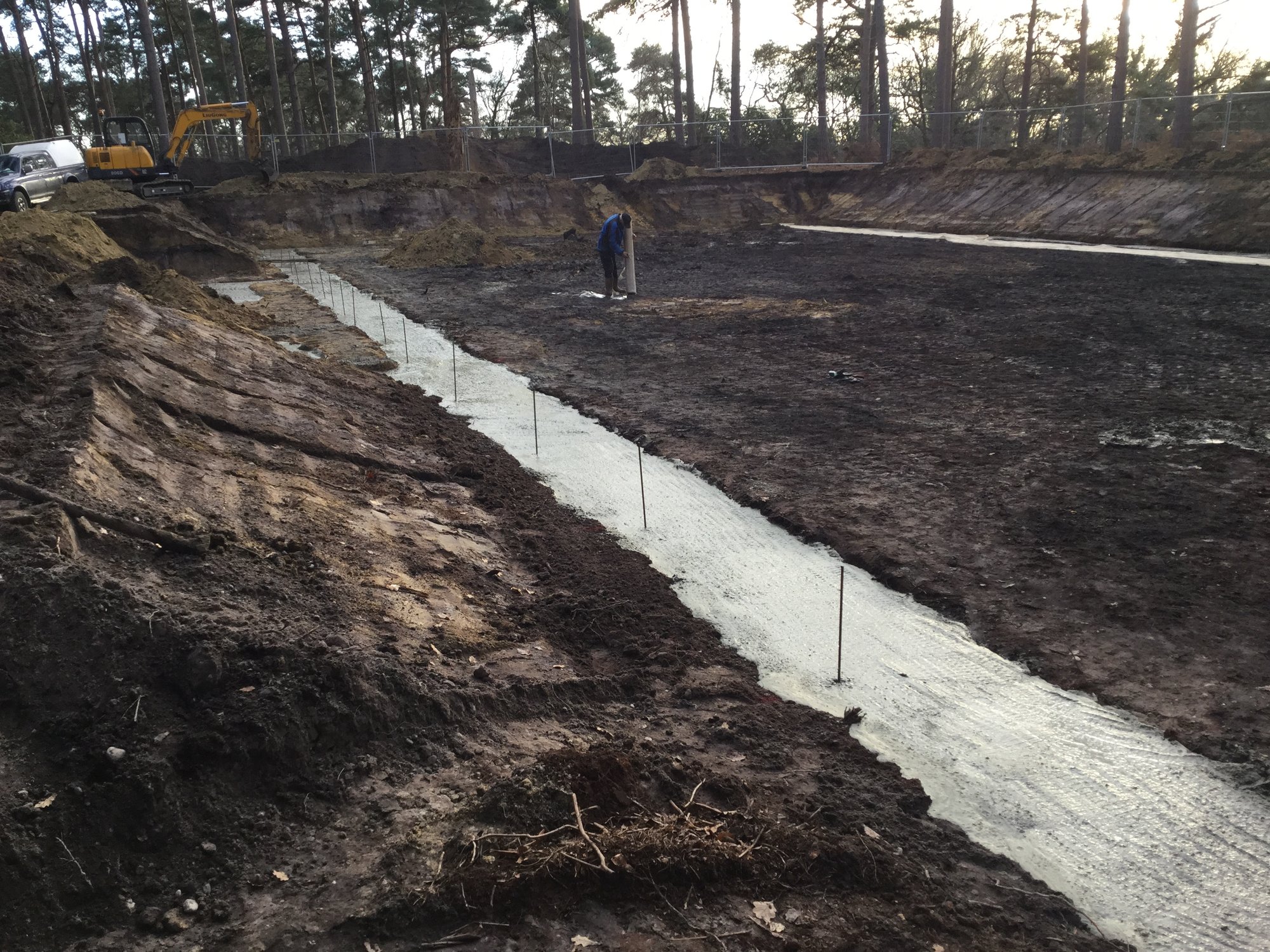

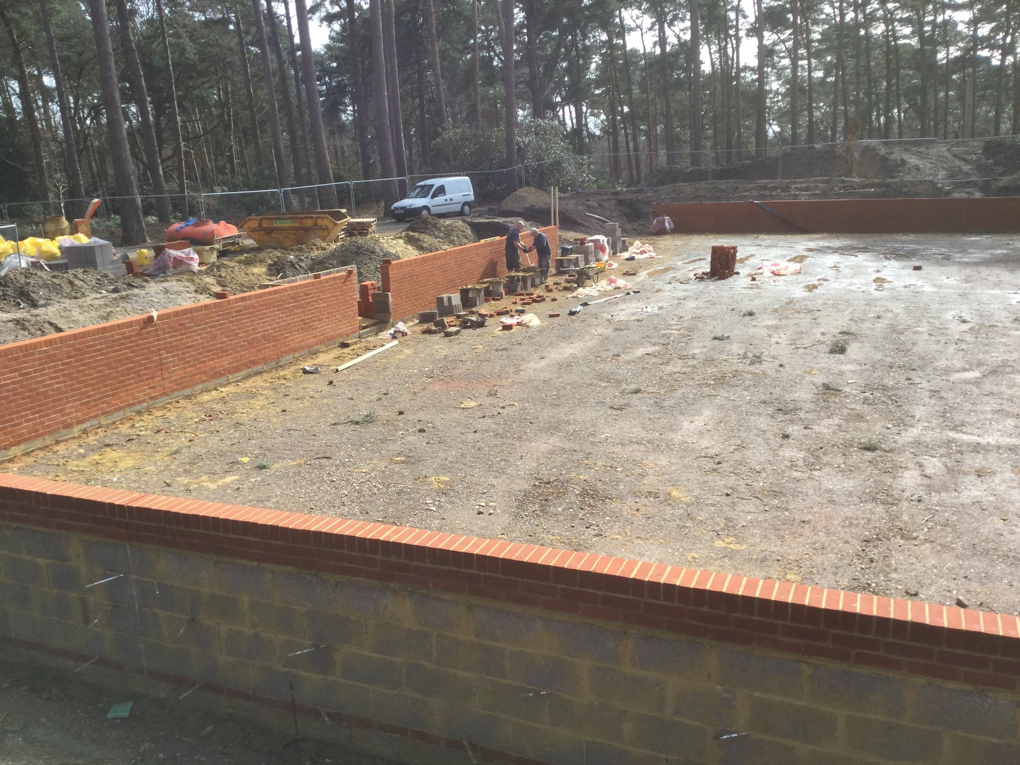

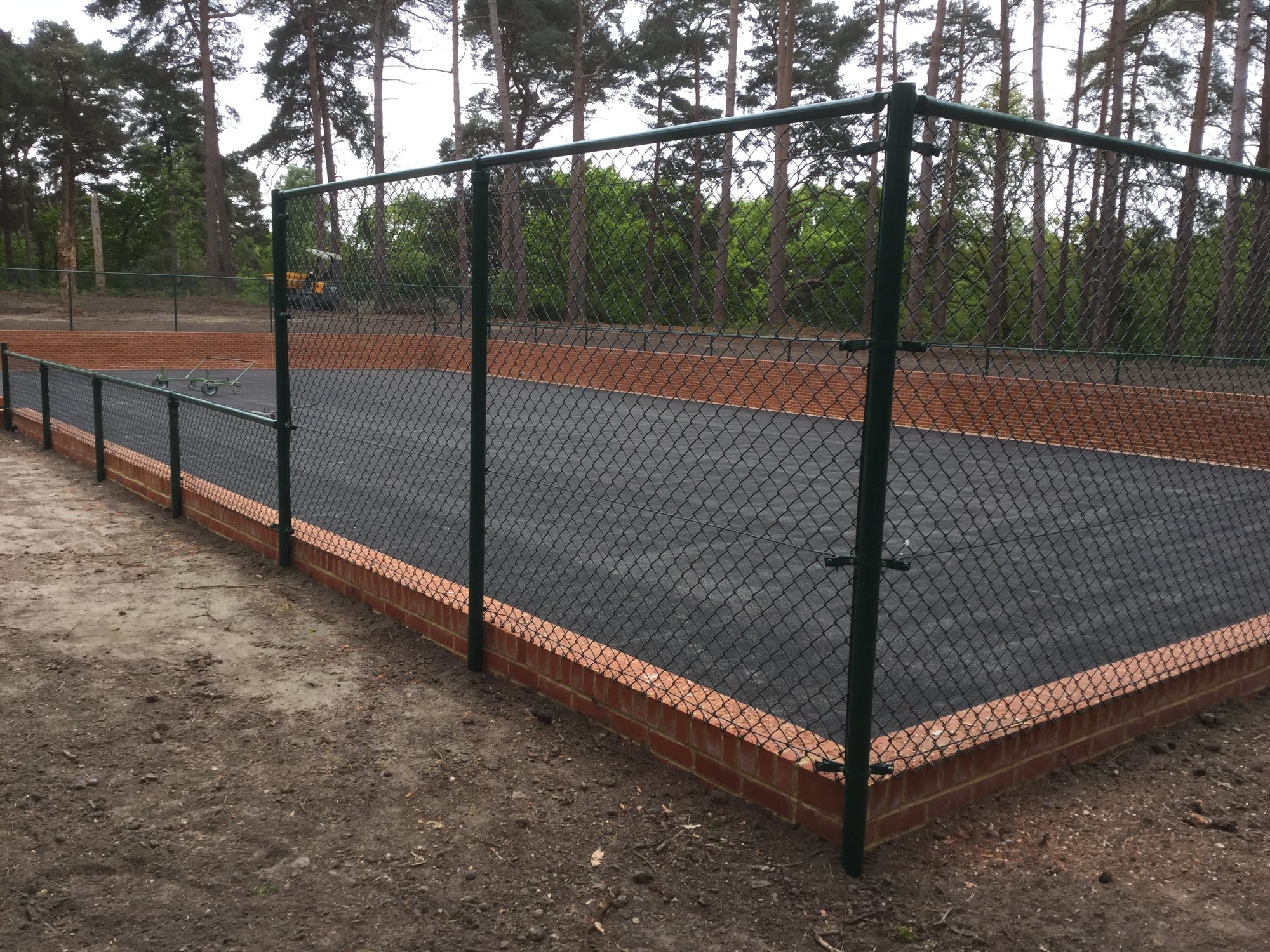

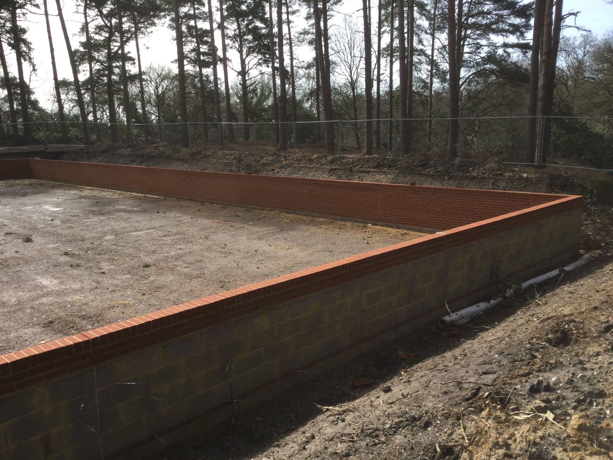

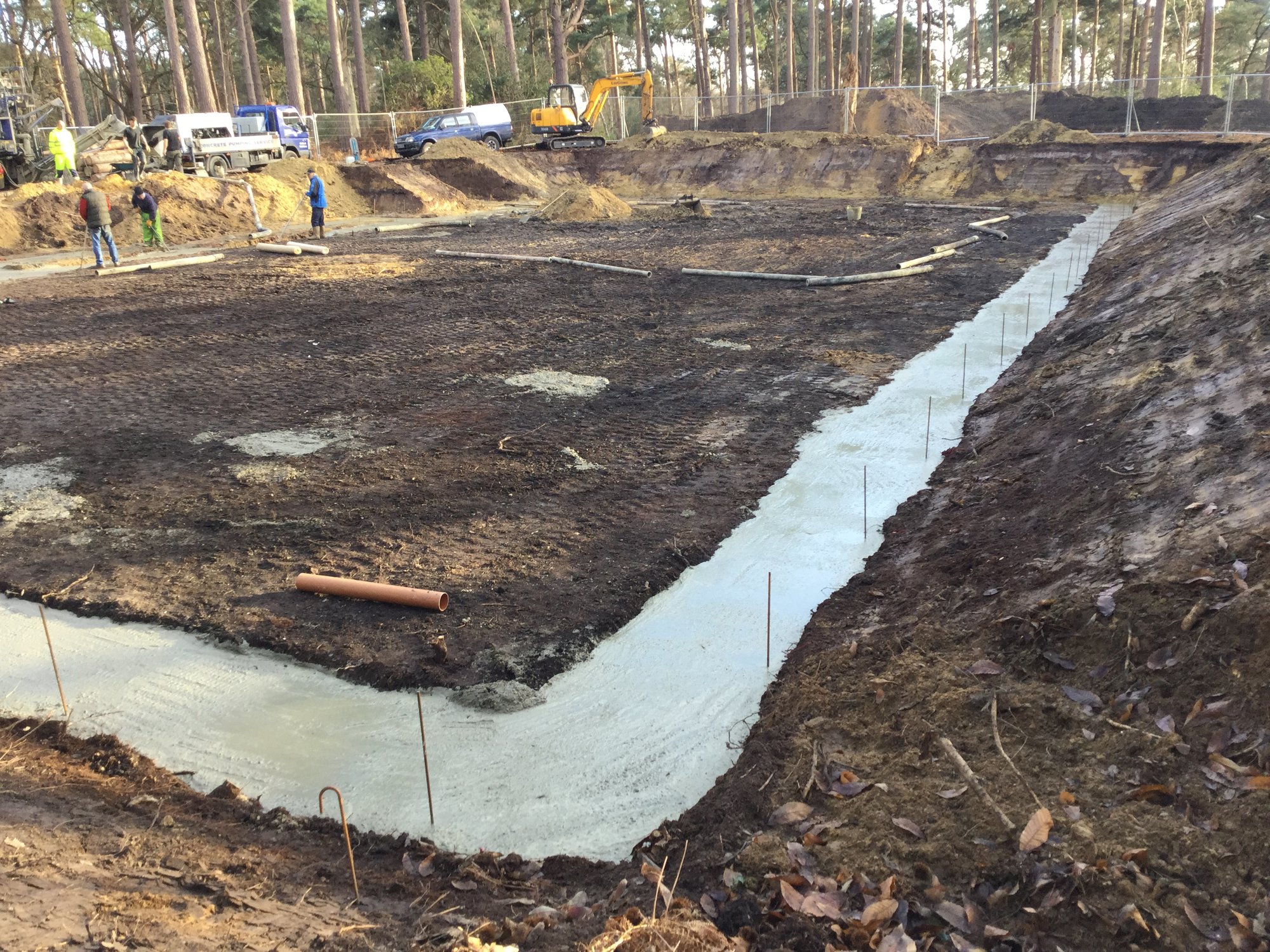

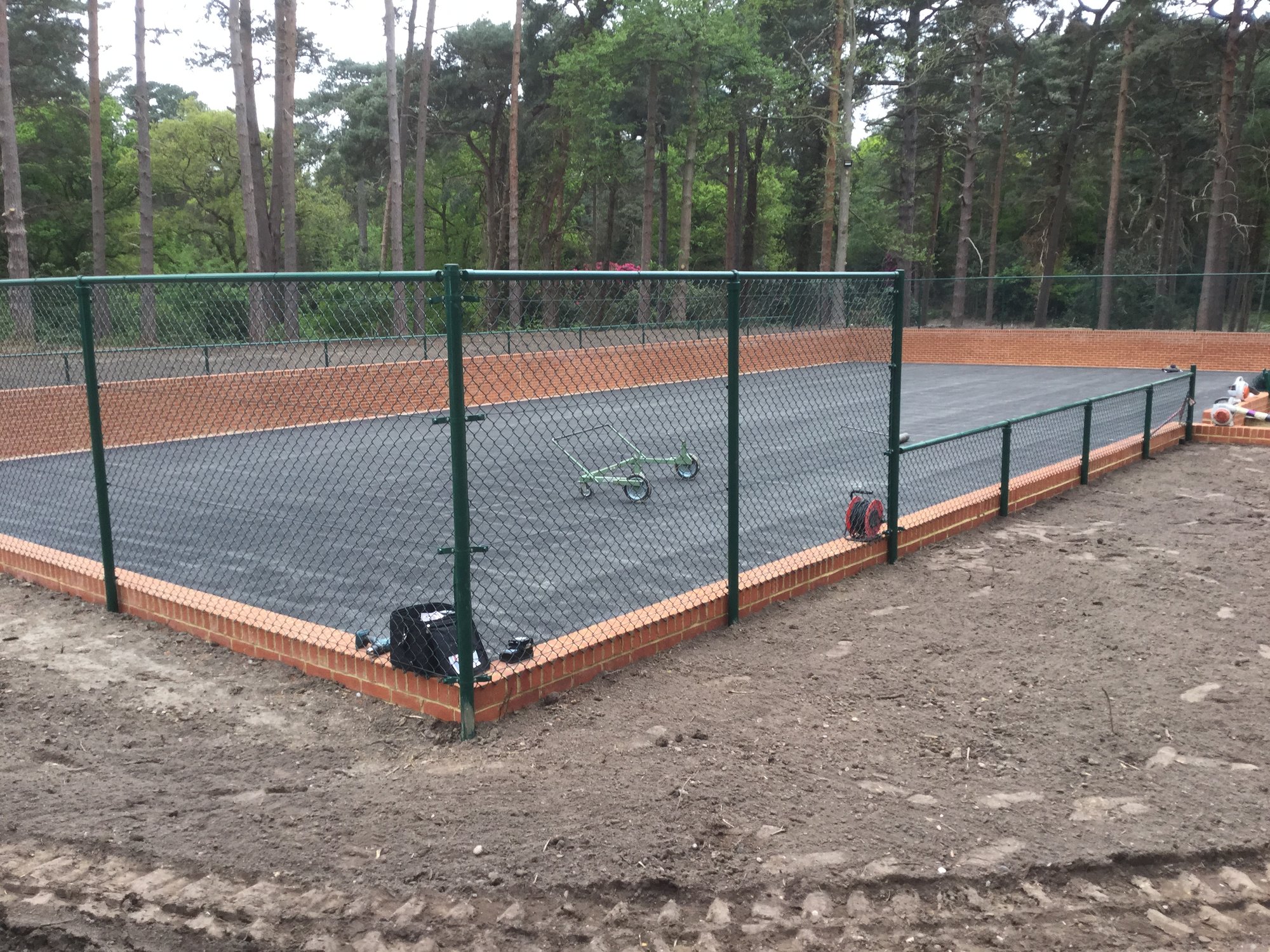

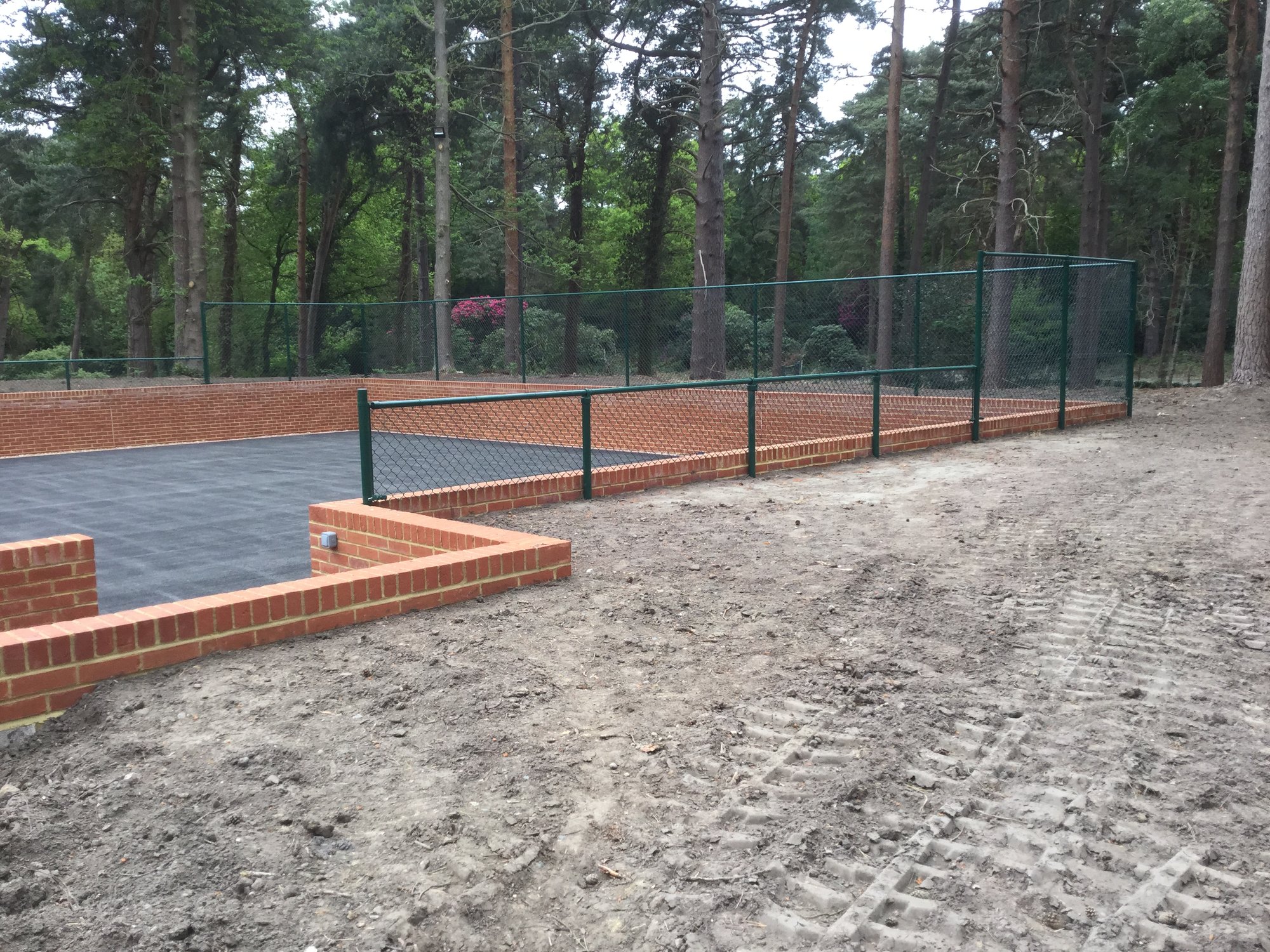

We built quite a large retaining wall around a tennis court, there were starter bars sticking out of the concrete behind the wall, as the wall was built wall ties were dropped over the bars into the cement bed of the brickwork, the back of the brickwork was then haunched in concrete. The foundation then became part of the brickwork and haunching, hope this makes sense.
