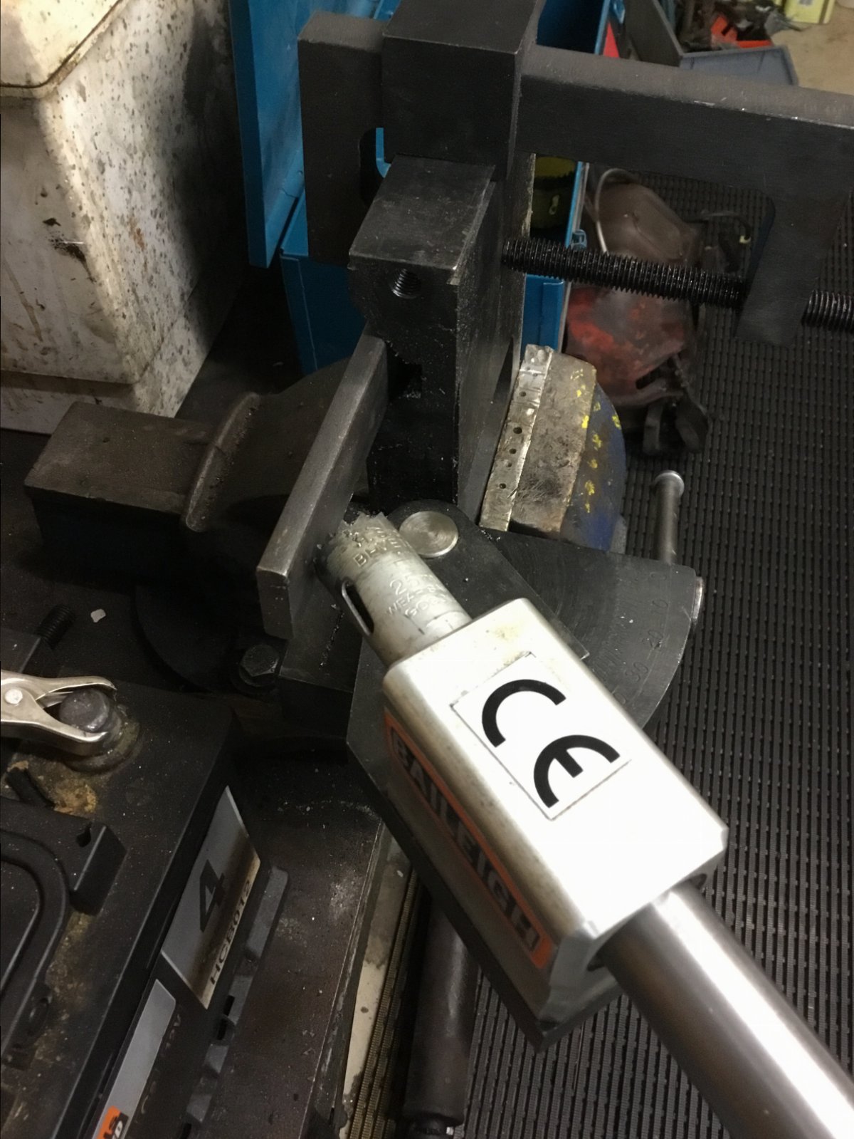

i occasionally drill 22mm holes in 40x8mm flat at an angle of anything up to 45-70 degrees off the vertical!this is very time consuming as I use home made guide blocks in conjunction with a magnetic drill!and weld the guide block in a new position for each hole?the bar i am drilling is too long to place in a m/c btw. Does anyone have a quicker more efficient method of boring this type of hole?

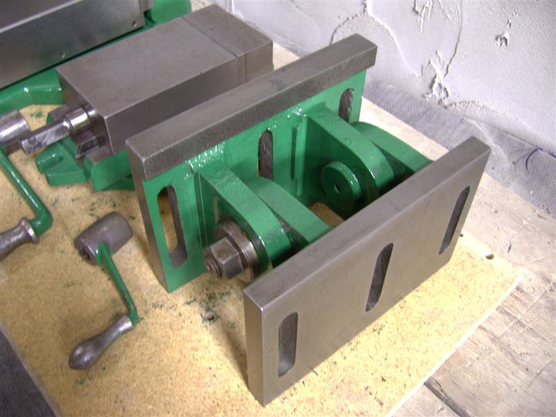

with curves, a lot depends on machine, radius of curve and where you are trying to put the hole.
You need a Geka that will punch slots
