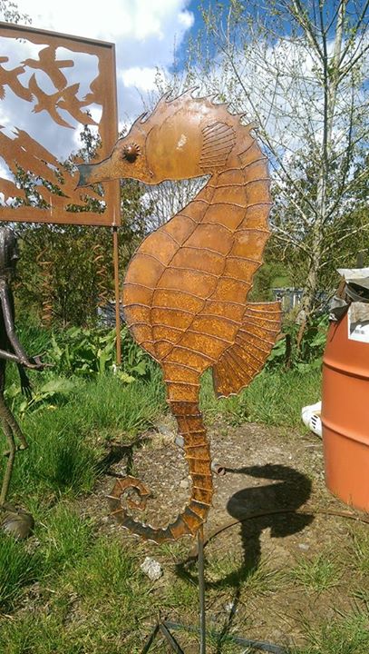

I have made this for my new friend and her Mum. Aaaah.

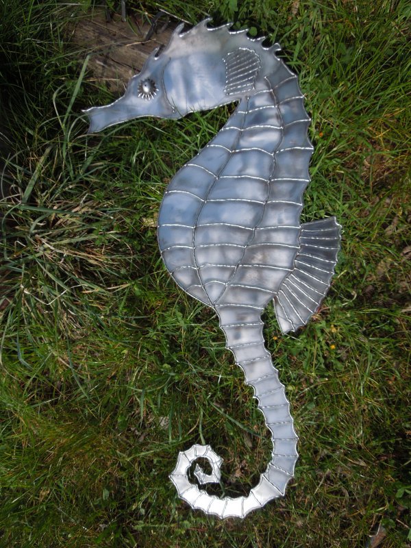

A simple but fiddly process, draw it on the sheet metal, then weld over all the lines and plasma cut round the perimeter.
Today I made a simple mount and scrubbed her with Ammonium Chloride.
Photo taken about an after that was done.
Cue big big smile on my chum's face. Job done.
