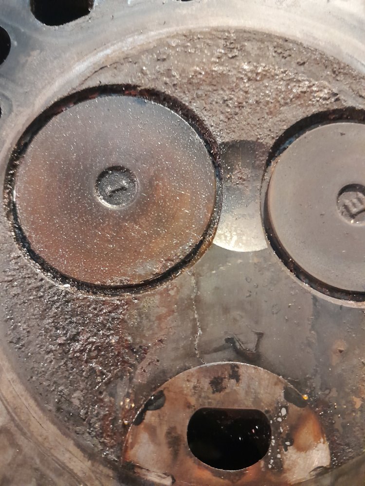

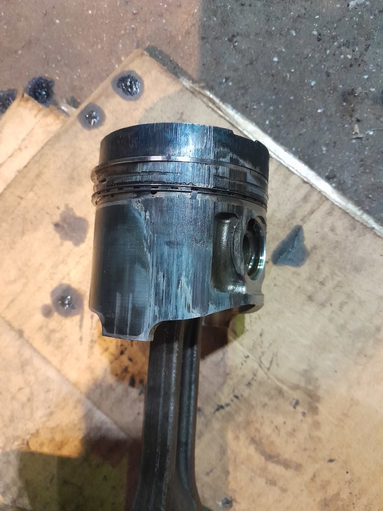

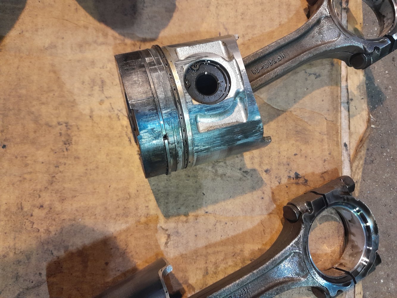

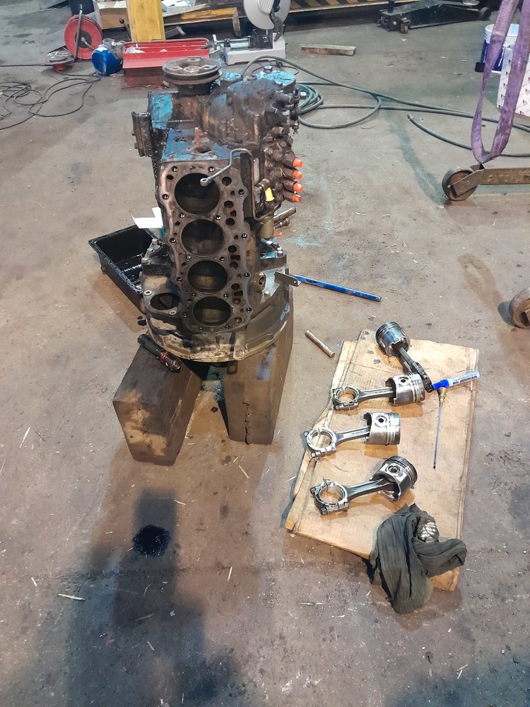

He must be a silly billy.Perkins 404-22
Great little engine's but they don't run for long without coolant. The operator said it was pouring steam out of the radiator cap for 10 minutes then it stopped steaming and started smoking and then it stopped. After cooling down it actually restarted. View attachment 428461View attachment 428462View attachment 428463View attachment 428464

Keeps me in work. And fortunately I love rebuilding engines this one will be rebored 0.5mm oversize. Bottom end is perfect,big end and mains still in tolerance not bad for nearly 10,000 hours. Got to have a new cylinder head though as it's cracked.Your fault. Machine should have been equipped with low oil pressure and high temperature trips. Even (some) small engines are equipped with safety trips. You are fully aware of the ability/mentality of these operatives - or you should be!
If he'd been ignorant of what was going on, fair enough, but he noticed and noted something very unusual happening, but chose to make it 'someone else problem'.Yes an employee but the engine is on a pressure washer. Iam sure you can imagine the type of person who spends 45 hours a week pressure washing for minimum wage.
