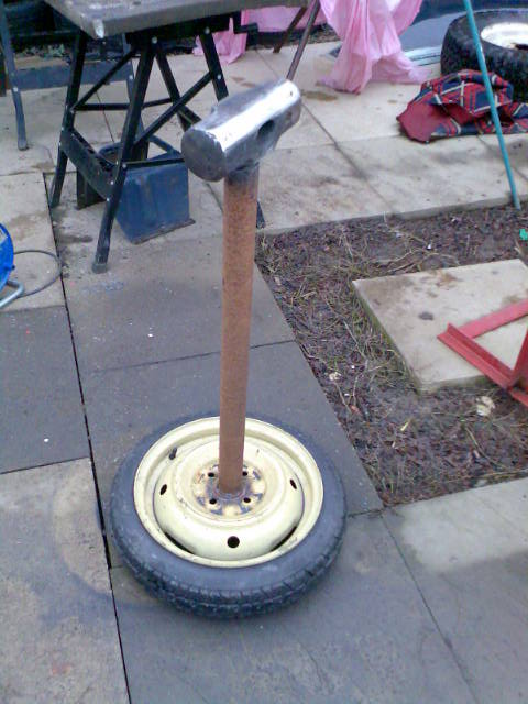

hi new on here.
thought id stick pic on of anvil i made.
i needed to shape some inner wing sections for my late dads suzuki project.
basically i made it out of what i had lying around which was
spare wheel from suzuki swift ( got car given after it hit a wall and cut roof off door skins, bonnet and what ever other steel we could )
steel tube
sledge hammer head
welded it all together with my old arc welder.
shaped one side with sanding disc on grinder.
works a treat
