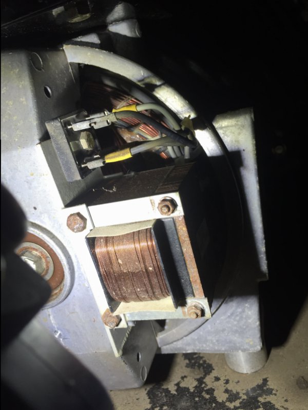

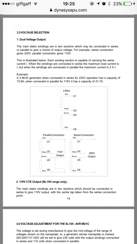

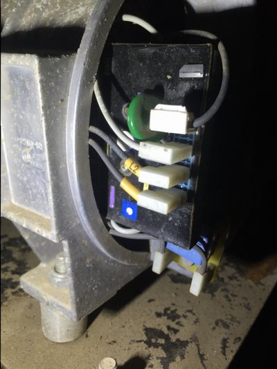

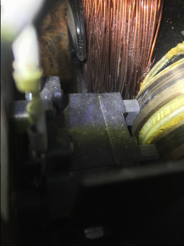

Yeah i get that but I pulled the back off and there's so many wire I'm not sure what the windings wires are will they ne of the brushes or the outside windings :-/ lol
is this a chinese 6kw alternator? If so, the excitation goes via the brushes, the power comes out of the fixed windings.
