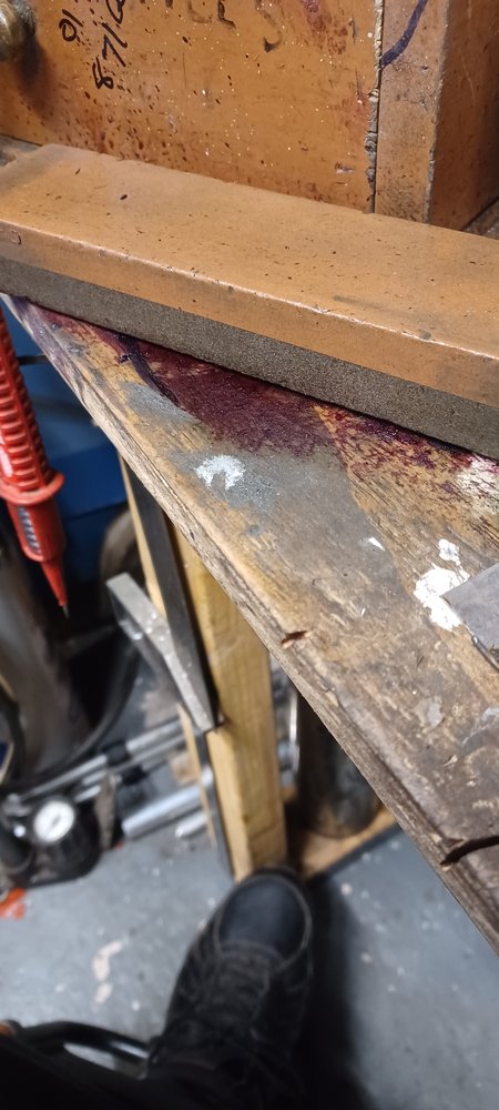

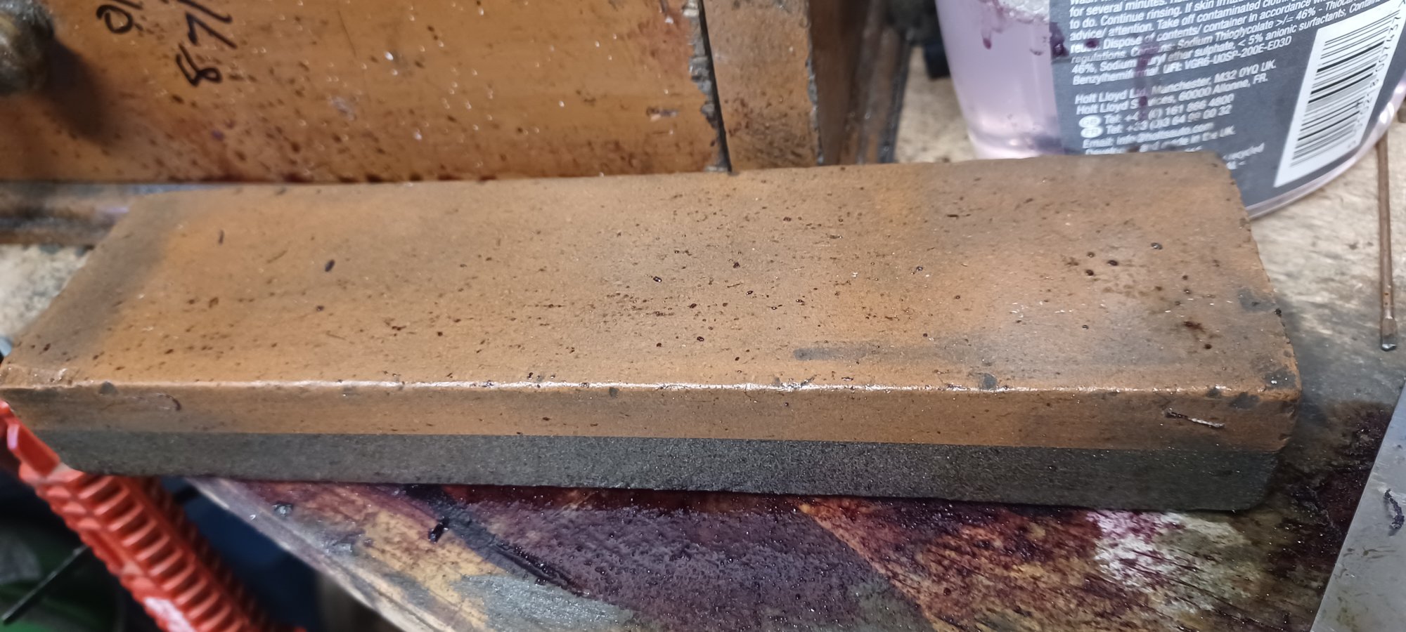

had a realy manky old oilstone that was caked with years of grime
so i gave
it a good soaking with alloy wheel cleaner "the stuff that goes red with brake fallout " absolutely amazingly it turned red probably years of blades being honed on it it loosened all the grease too and is cutting now as it should
hope this helps all you old stoners
