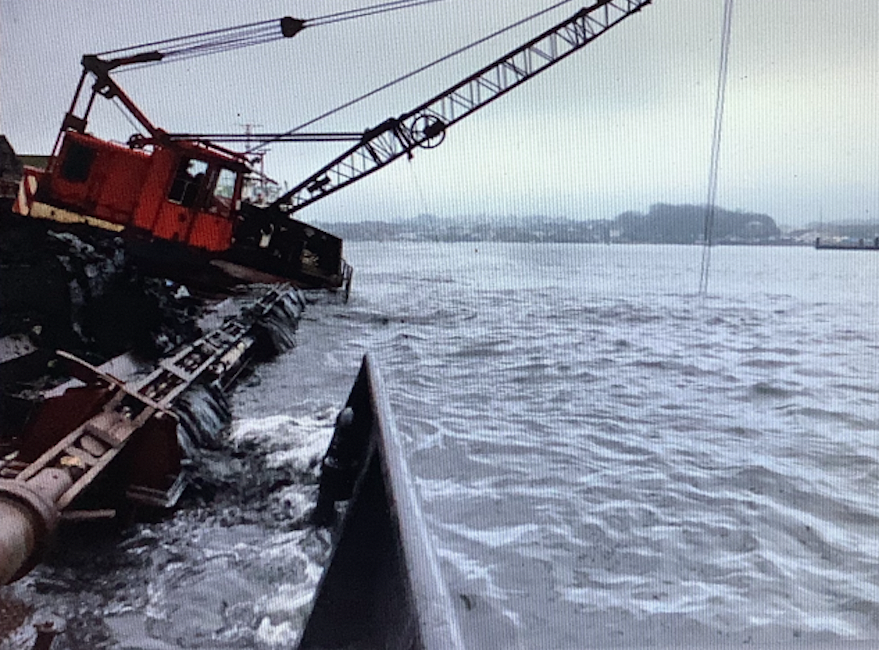

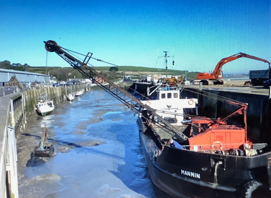

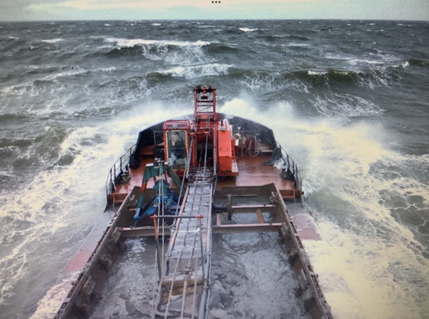

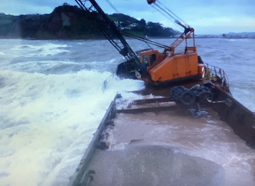

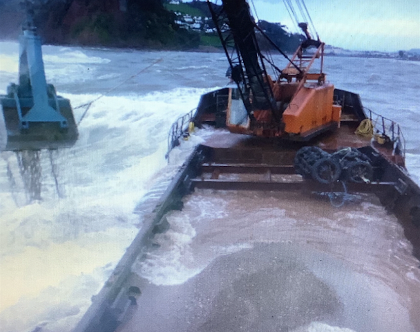

Turns out the bloke who helps me fix things down the club used to operate a crawler crane bolted to a barge, so thought you might like to see some pics of said barge.
Going by the pics I am guessing it was price work!
