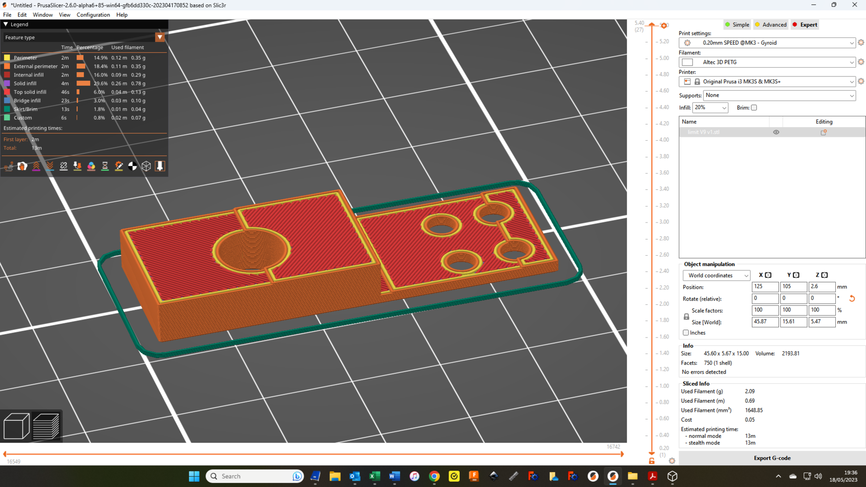

There's something fishy going on. The above was sliced with a 0.2mm layer height, I get different looking results if I slice it for 0.15mm and 0.3mm layer heights. If you want to send me a sketch I'll draw it up in FreeCAD and see what that looks like when it's sliced.

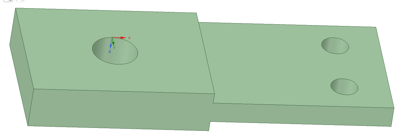

That's what it should print like. But as it turns out it does not fit like that.

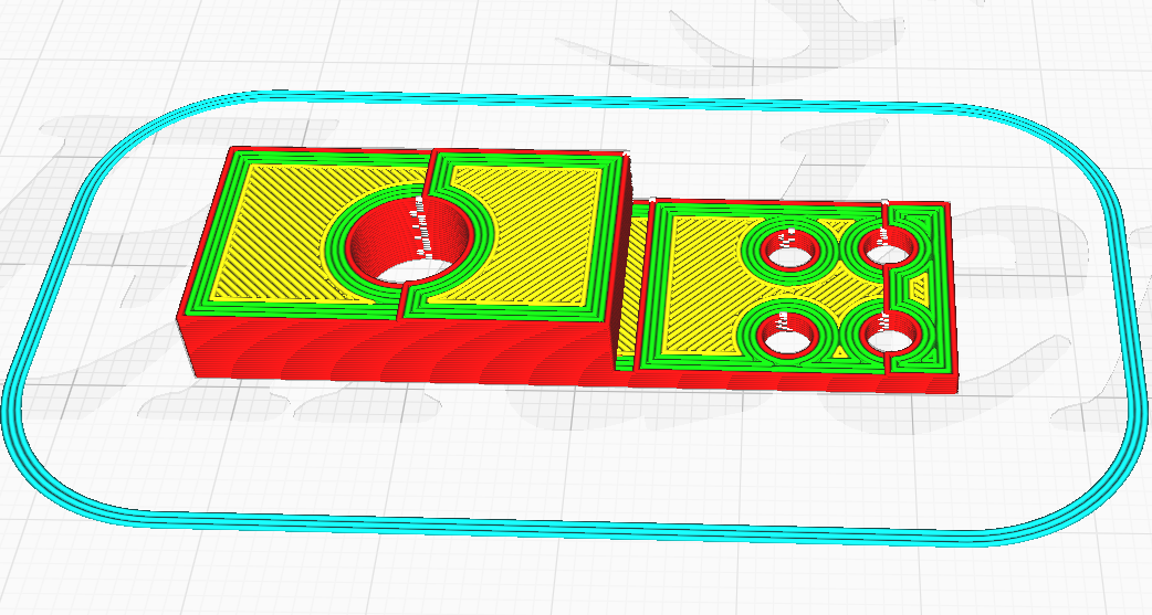

It was only putting a brim round the side with 4 holes in it. But then the first later of the other side tried to print outside of the brim.Looks OK to me in Cura, but the very last layer looks unusual, it only does half of it. It seems to be made of component parts too, rather than a solid with holes.
I might be using the wrong term....lolI downloaded the .rar file and in it was an .stl file which I then loaded onto Prusa Slicer. It all looks good with a flat bottom on the bed, so in my opinion no need for a brim. Is this what you were expecting or hoping for?

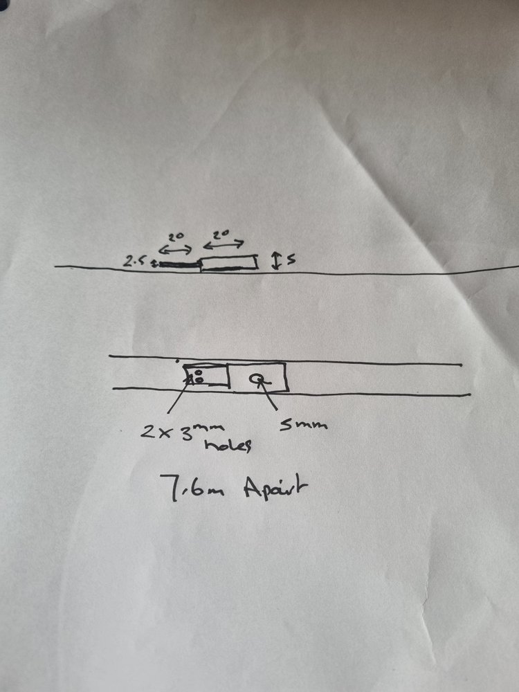

I will try and sort one tomorrow. Cheers.There's something fishy going on. The above was sliced with a 0.2mm layer height, I get different looking results if I slice it for 0.15mm and 0.3mm layer heights. If you want to send me a sketch I'll draw it up in FreeCAD and see what that looks like when it's sliced.
I did but the skirt was still under the left part of the item. LolLooks like it is tilted on the bed. It's not lying perfectly flat, hence the very slight contouring on the top and the missing bottom section. Cura has a "lay flat on bed" button. Hit that!
Lol yeah I don't know how I managed to get tapers and slopes. I made it from 1 sketch and extruded it.Wow. Ok just looked at the .stl and it's a bit of a disaster! Tapers and slopes all over it. I'm guessing you want whatever it is to be flat and square at the (somewhat odd) dimensions of the stl?

I had to guess at the width (15mm) and the offset of the 3mm holes (15mm from the chamfer). If you want to ring me in the office, I will tweak it while you wait. 01452 311031 Andy
The extrusion it's fitting on is 20/20 so I think 15mm width with be fine.What is the part width?
