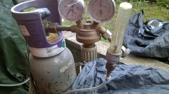

How do you deal with regulators where the flow rate alters with the pressure in the tank?
I have a wescol argon regulator which I put it on a brand new 9L hobbyweld bottle today and its now under half full. I checked it when I started getting bubbles during a weld to find that the pressure had dropped by half and the flow had more than doubled.
To adjust the flow, I open the gas bottle valve a little bit, press the welder purge button and then adjust the regulator valve until I get about 10cfm. The strange thing is when the welder is idle (and is not purging), the flow rate valve still shows a flow rate even thought there is no gas being used - I cannot hear any gas leaks!! Is this normal for regulators to do this?
So, how do you deal with a drop in pressure effecting the flow rate? Is it normal to keep having to check because as the pressure drops and the flow increases, it empties the tank quite quickly.

and .10cfm is about 3lpm, which is too low
