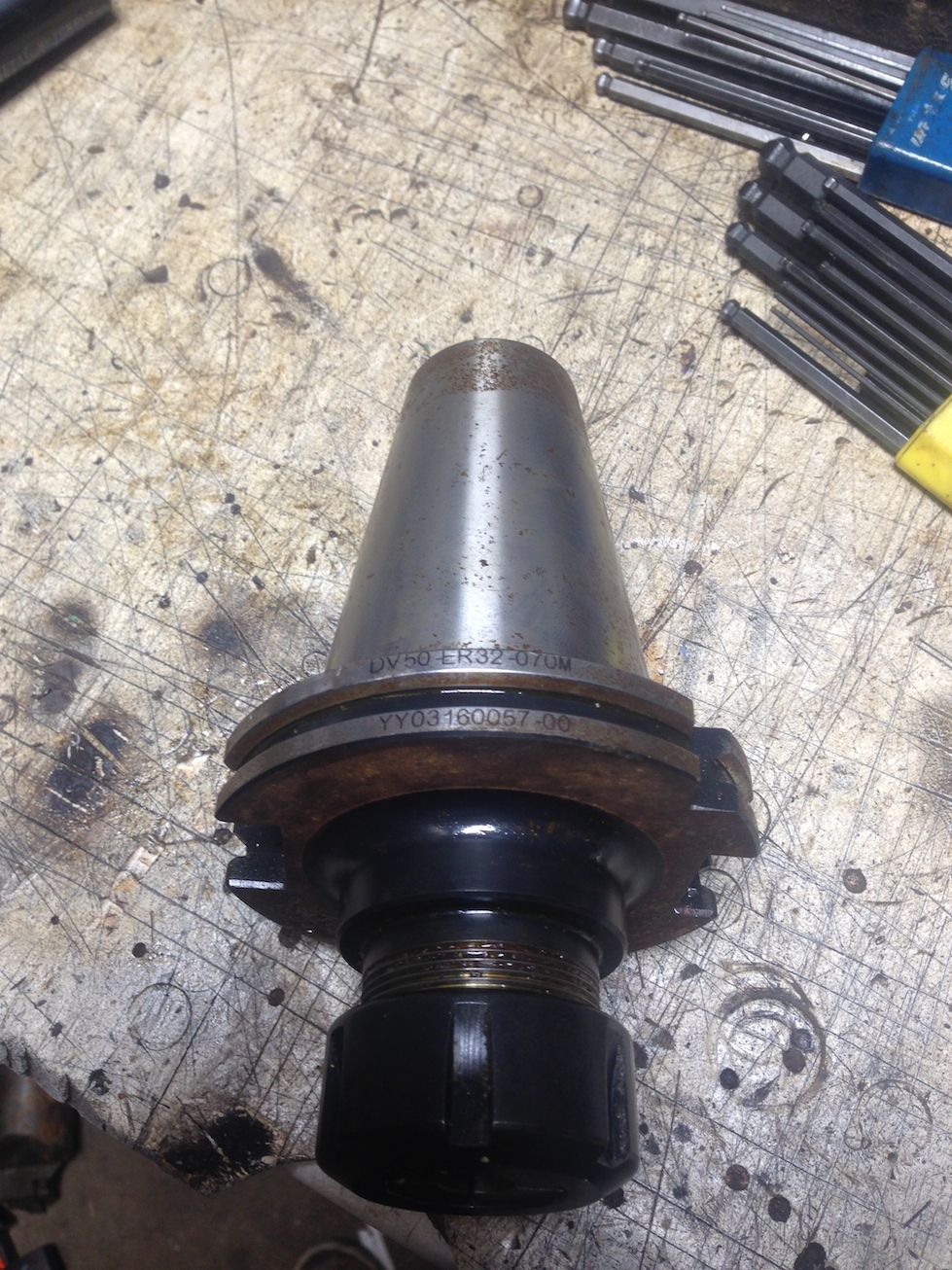

That first one's a DV50 taper, it says on it.
Yes but I think SK and DV are the same, could be wrong though as there are just so many variables around, even ones specific to machines such as the ones I have for the Chiron, they are a modified SK I believe.quite possibly. Same tapers but different flange patterns. I think my mill is designed for INT30, but I happily use BT30's with a thread insert I machine myself to fit my machine.

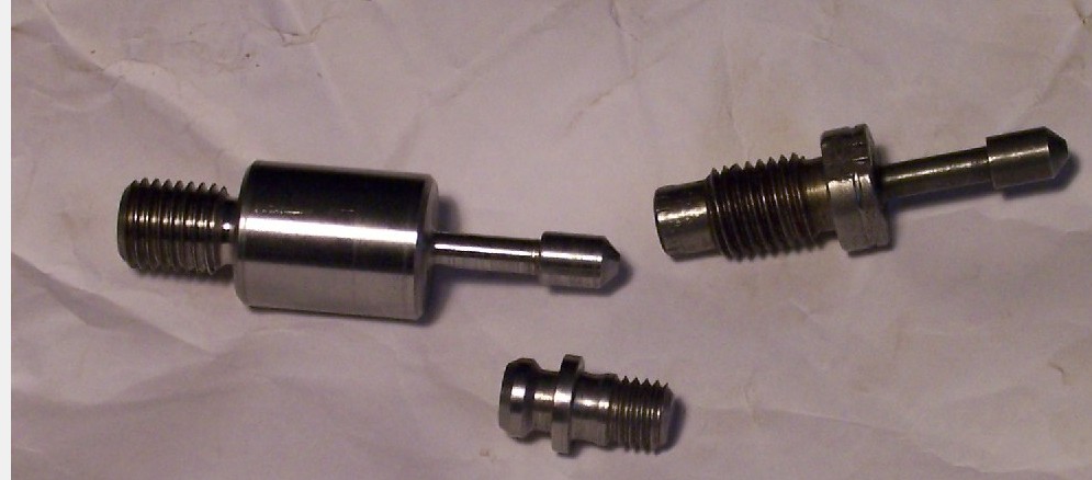

.... I think my mill is designed for INT30, but I happily use BT30's with a thread insert I machine myself to fit my machine and drawbar.
