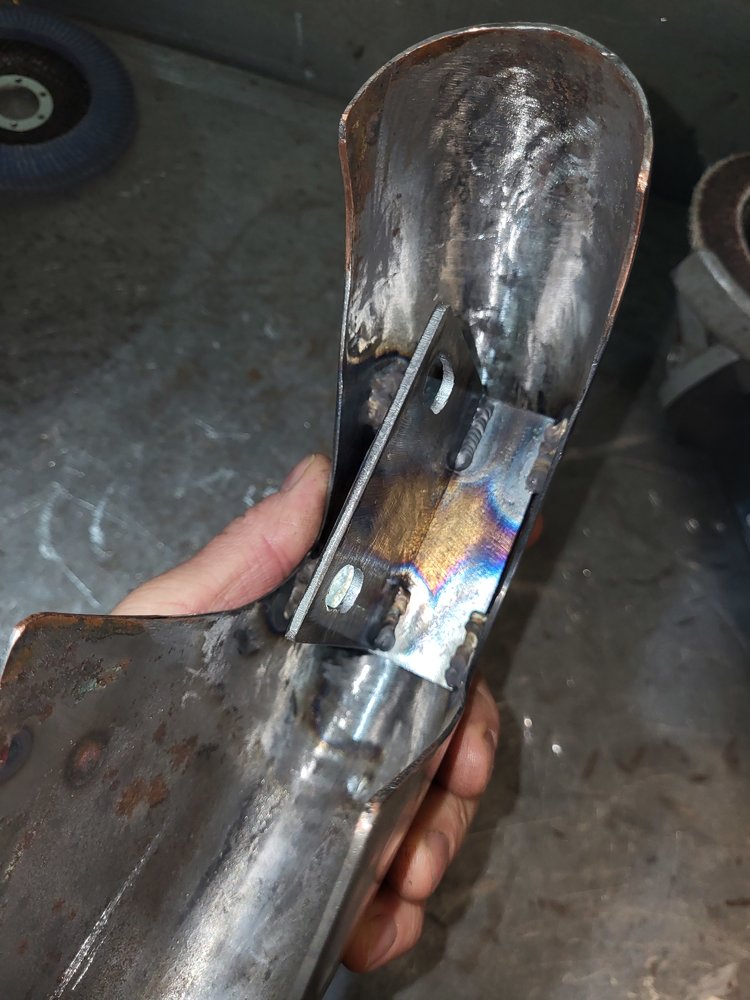

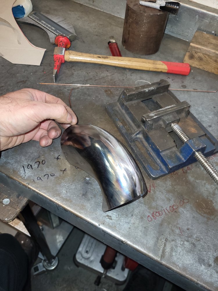

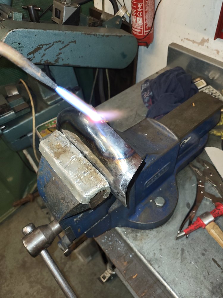

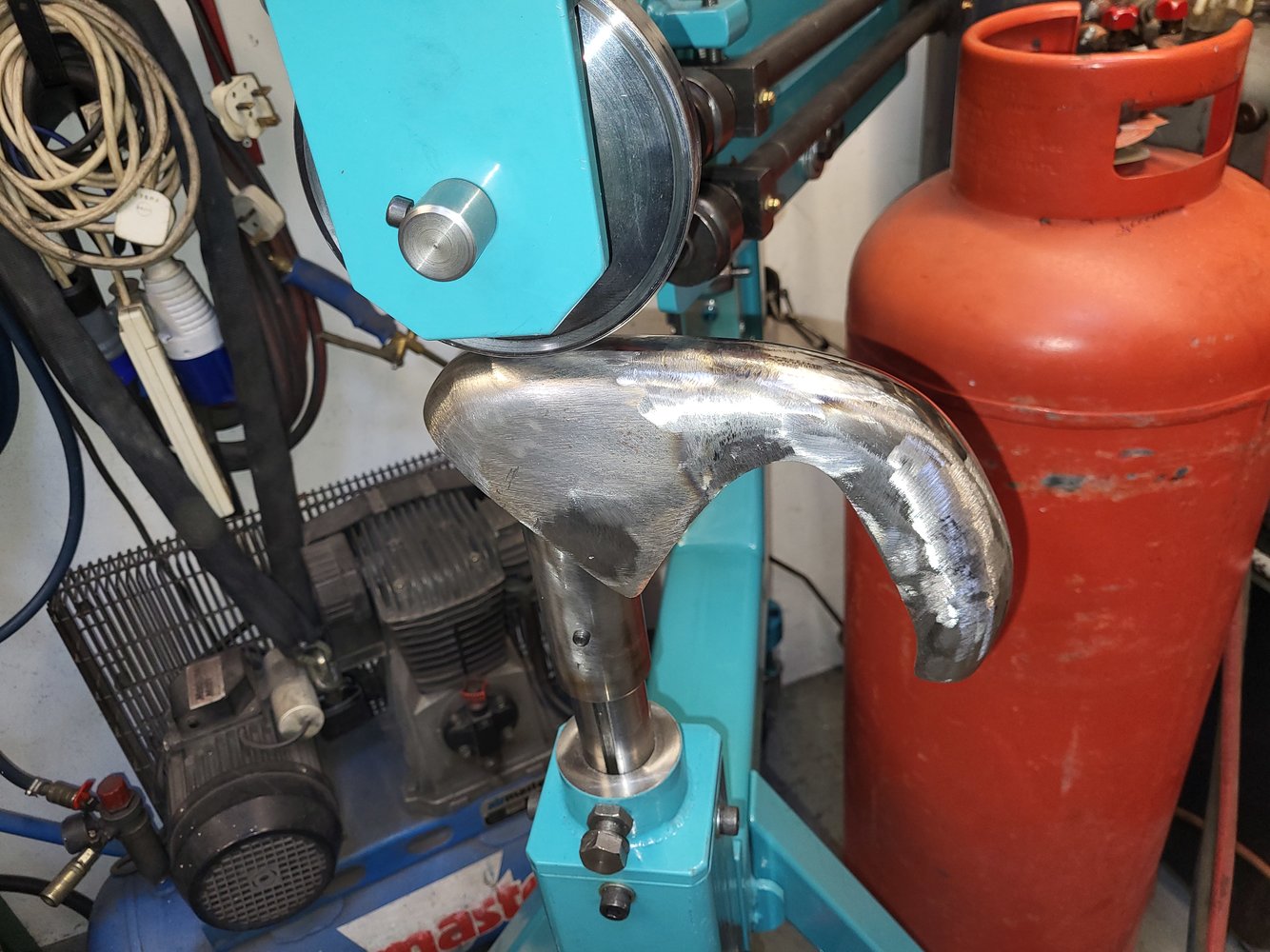

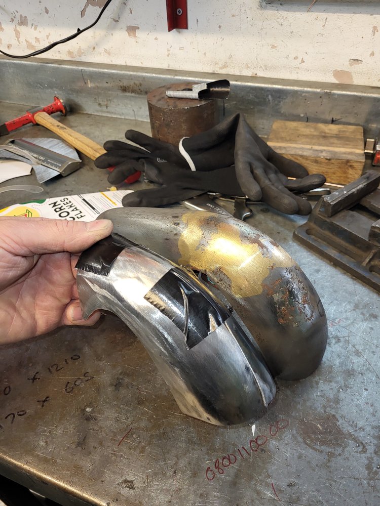

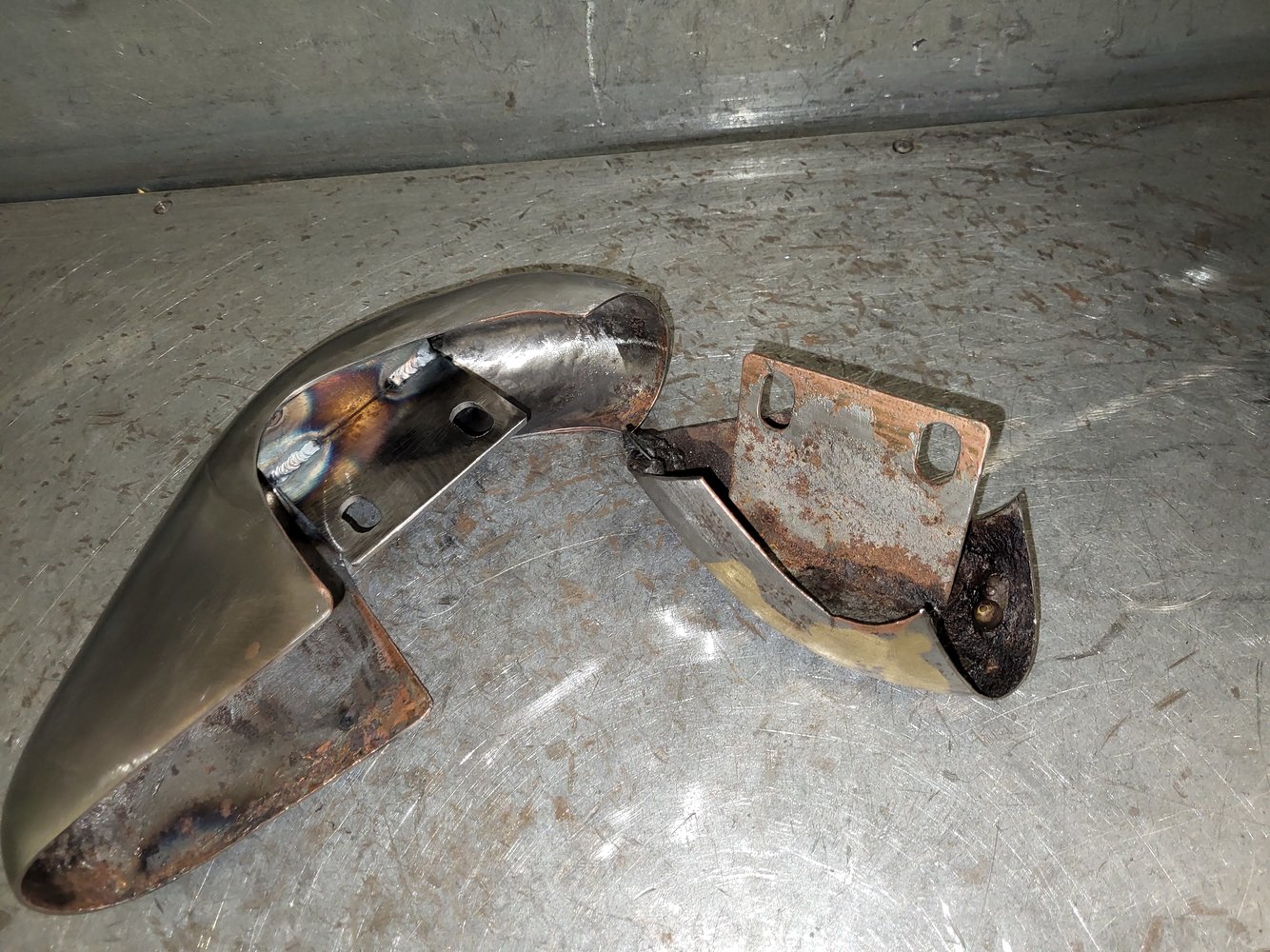

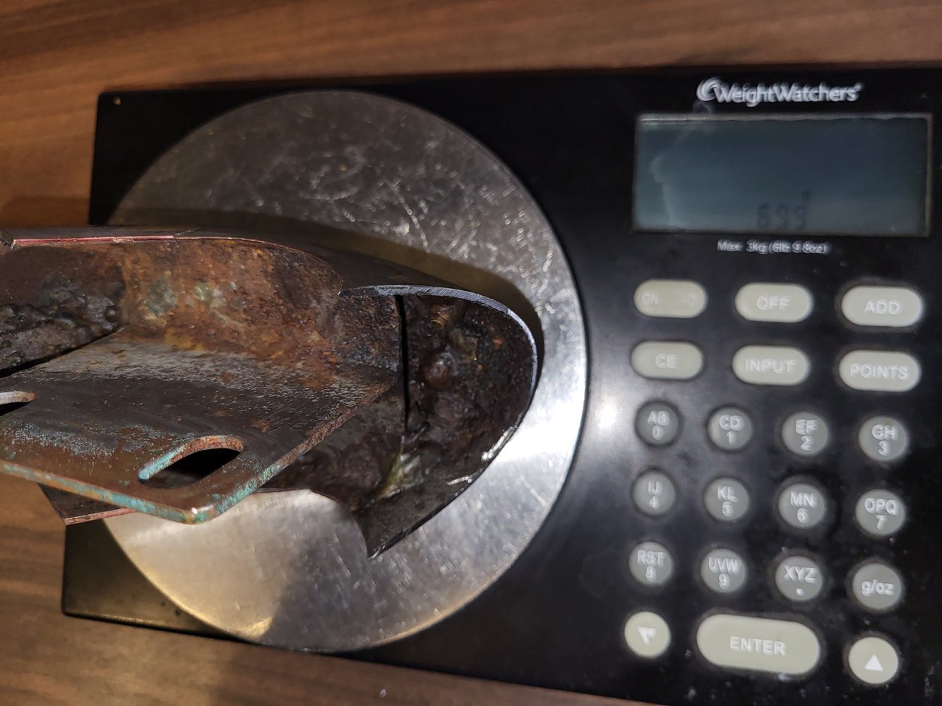

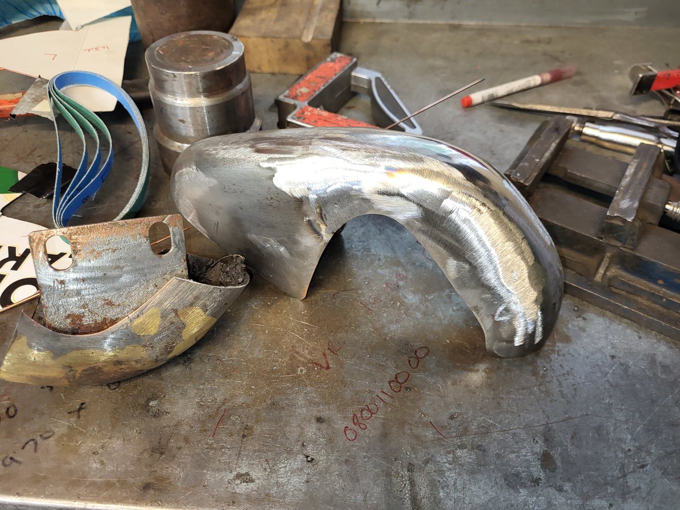

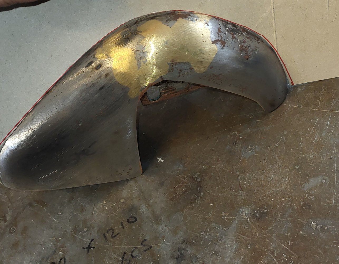

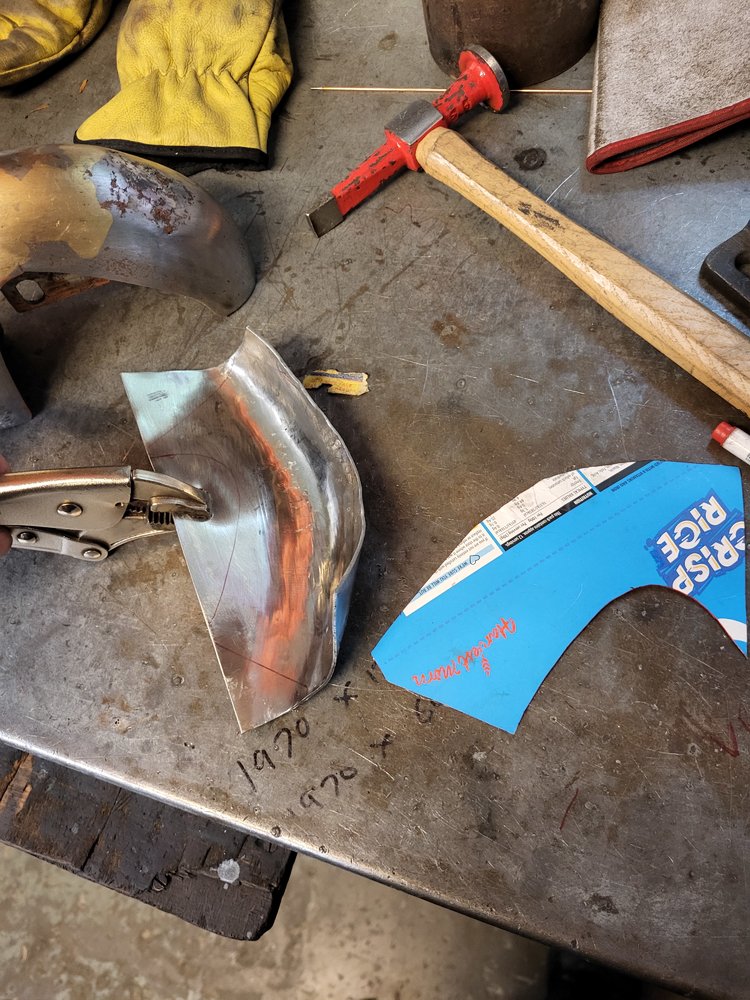

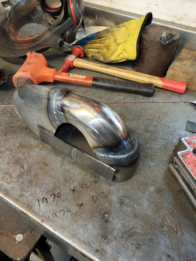

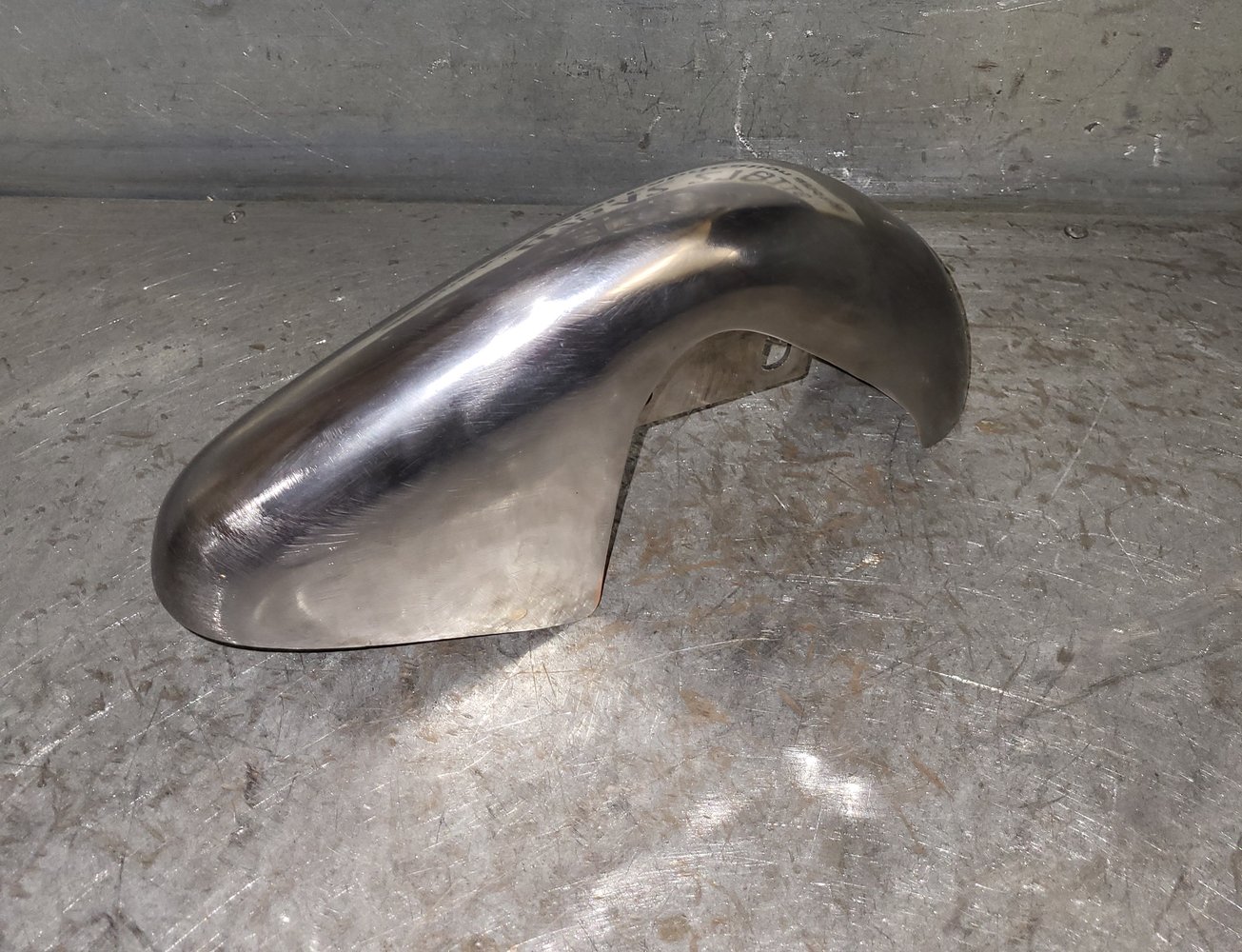

Here are some photos of a recent repair I did. It's for an Austin Princess. It a Vanda Plas with a factory fitted 4 litre Rolls Royce engine.

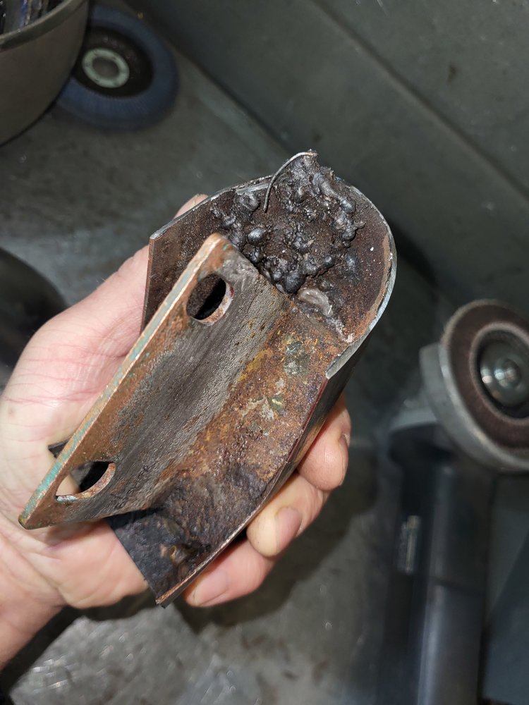

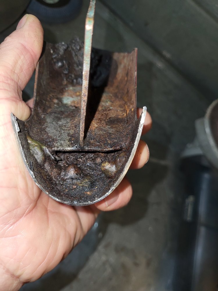

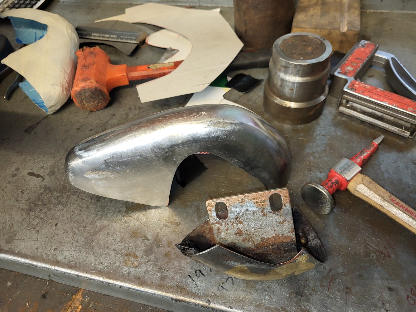

The overrider had been badly bodged in the past with tons of brazing rods used to fill the giant rust holes.

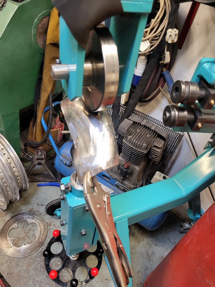

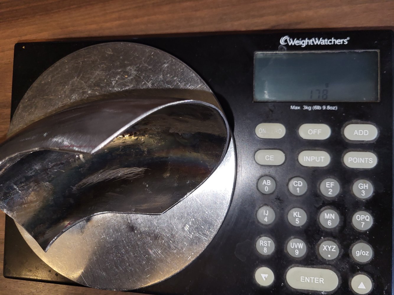

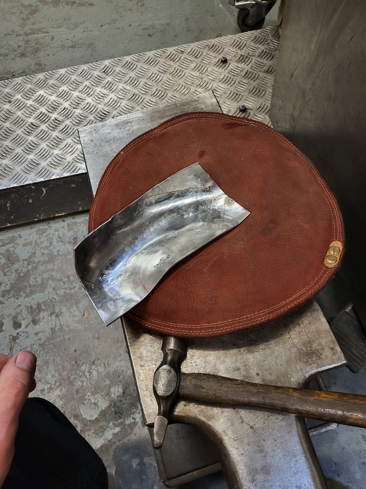

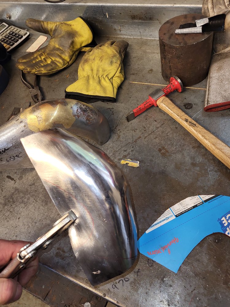

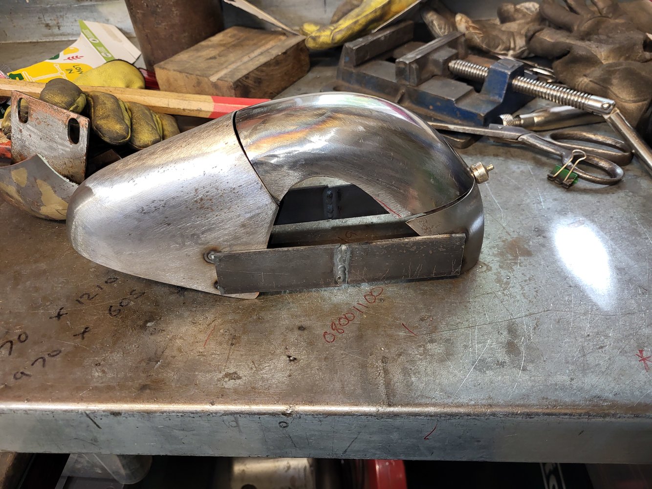

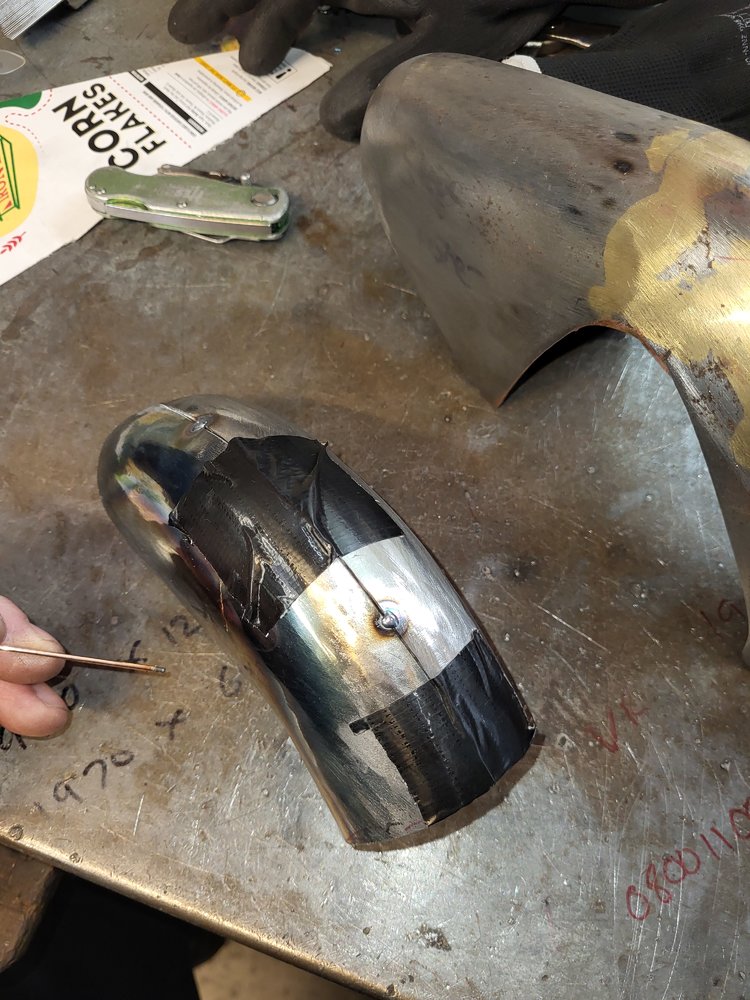

I cut out all the crap and made a new repair piece out of 2mm steel sheet. It took some fighting to shape the tight compound curves but I got there in the end
