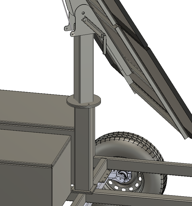

What's the bet way of doing the axial bearing in the photo below?
It's basically a solar panel mounted on a trailer, and needs to be able to rotate by 180 degrees.
The total weight of the panel will be about 100kg.
Ideas so far cosidered:

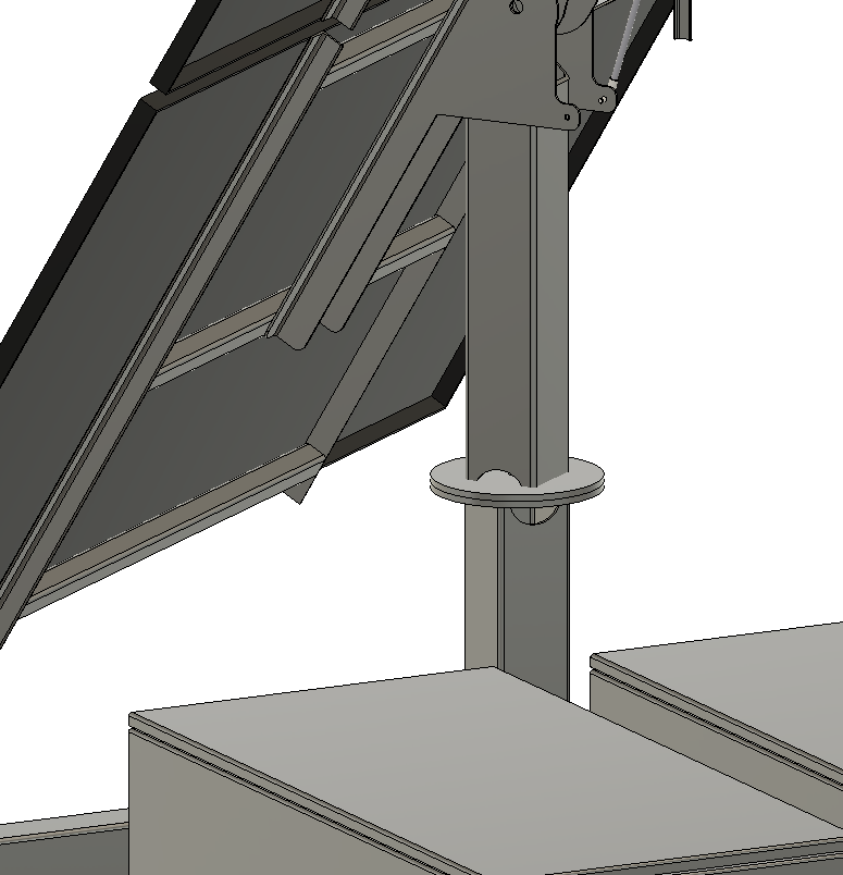

a) just have to plates as in the drawing below, with a large bolt holding them together (not done up too tight). And have a grease nipple.
b) have some sort of bearing (either a tapered wheel bearing type thing or a thrust bearing) between the two plates, again with a big bolt.
c) use two bits of tube that fit inside each other in combination with either a) or b)
Ideas? Trying to keep it simple but also easy(ish) to rotate.
