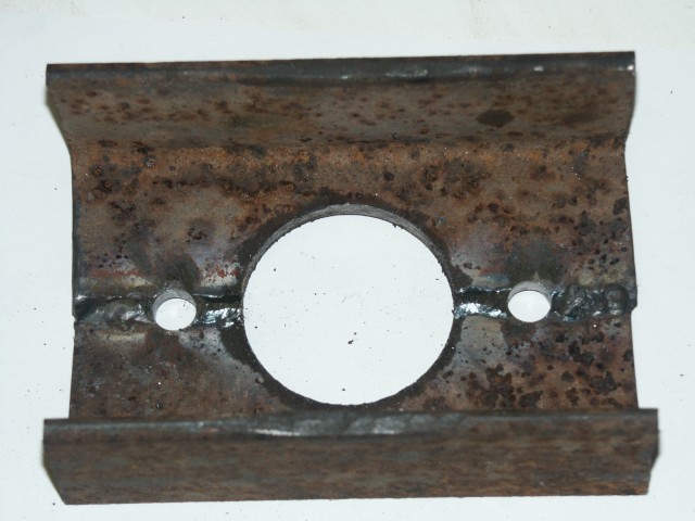

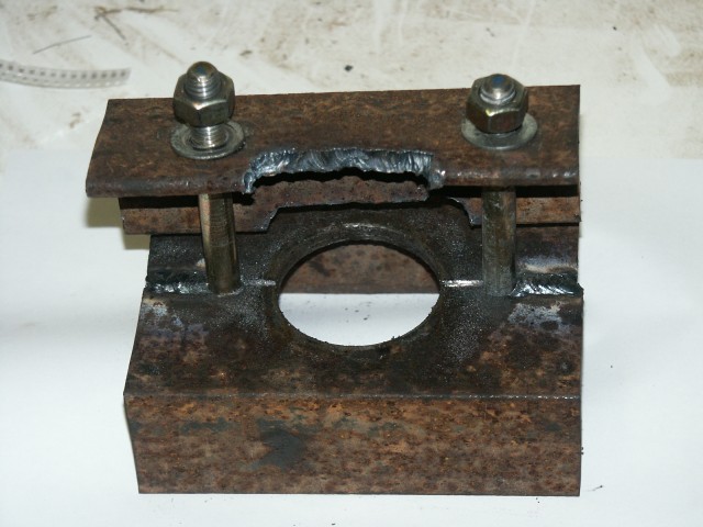

This is where having a welder has changed the way I do things. Would have cost me special tools for one job.
1990 Jeep Cherokee with 220k miles. Bought new ball joints about 2 years ago and never put them in.
Royal pain in the butt. Really the proper way to do them is to remove entire axles and install them/remove them using probably at least a 10 ton press.
Replacing one of them was a 6-hour job. C-Clamps, pounding and heating did nothing to get them loose.
So cut up some 2"x2"x1/4" angle, some 6013 rods and hacked this together:
Thought the weld was horrid until I knocked the slag off. Came out well but cut out the best part of it for the center hole and the ends had starts/stops and tacks. The two notches were done with my 25A plasma cutter. Freehand and ragged as more than the plasma can handle.
Here's the opposite side:

Now I see why. Took the puller cranked as hard as I could over top and spindle bolt, wedged a cold chisel under the bottom an pounded it until I could actually see the cast iron spindle flex. Then beat to the top.
Typical, it moves a few thousandths. Retighten, pound some more; repeat ad nausium.
