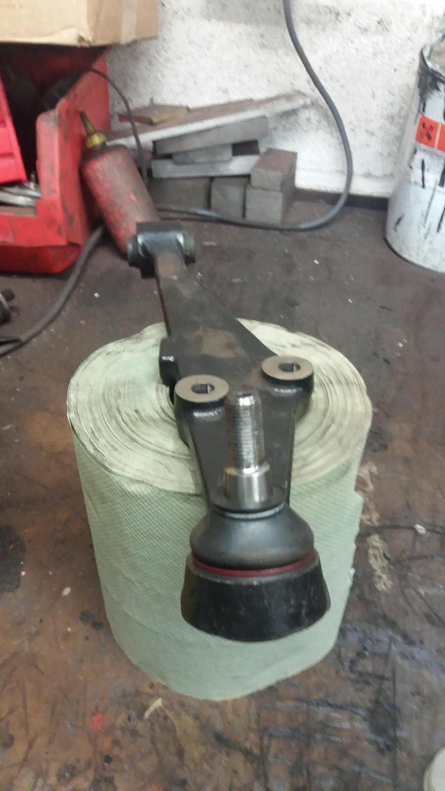

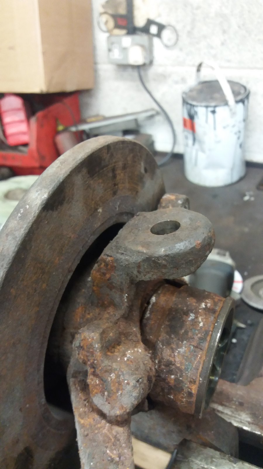

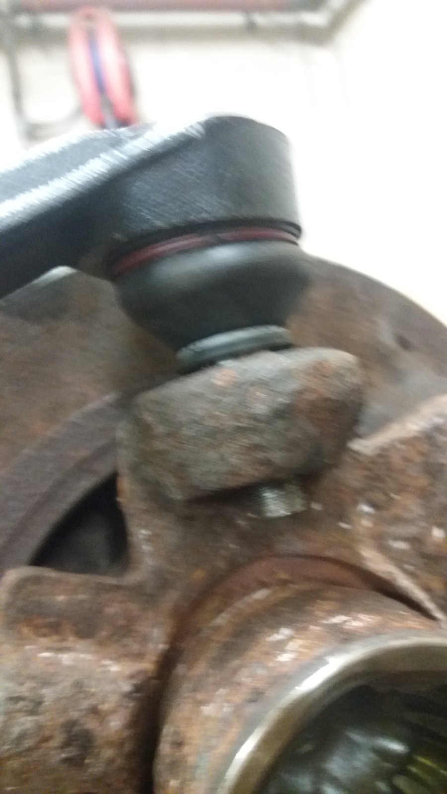

Thanks for the offer Bob but I'd sooner buy one as it's a job I'll need to do a few times, the balljoint is rover 25 and the hub is micra, the taper seems right but not big/deep enough
15mm to 16.5mm over 15mm so that's 1mm in every 10mm of length.
I'm not sure ? How is it 0.75mm over 15mm? Sorry if I'm being daft.So on the radius that is 0.75mm over a 15mm length
The angle is given by arctan (0.75/15) = 2.86deg
Edit: half of the taper?
How easy does it remove material if I put it in the mill?90% of these joints are 7.15 degree taper Woody, some oddball ones are 10degree, Yanks measure them in inches to the foot, in this case 11/2" to the foot. They cost a fortune but you could get a 7 or 8 degree reamer reground and you will save money. Happened across mine on Ebay, no one else bid because it never registered with anyone what they are used forLangy was the last person to use my one.
Bob
Edit
Or get this type https://www.amazon.com/Allstar-ALL11170-Degree-Reamer-T-Handle/dp/B006K8GNPW, mine goes in the gut buster so you have to take it very steady or you will overbore, no going back from that![]()
If that is correct then it is a 1:10 taper like you say and that is a standard taper, at least it is for metric prop shafts taper for boats and this 5.7248 degrees included angle.On re measuring it's more like 15mm to 16.5mm over 15mm so that's 1mm in every 10mm of length.
Got a reamer?If that is correct then it is a 1:10 taper like you say and that is a standard taper, at least it is for metric prop shafts taper for boats and this 5.7248 degrees included angle.
