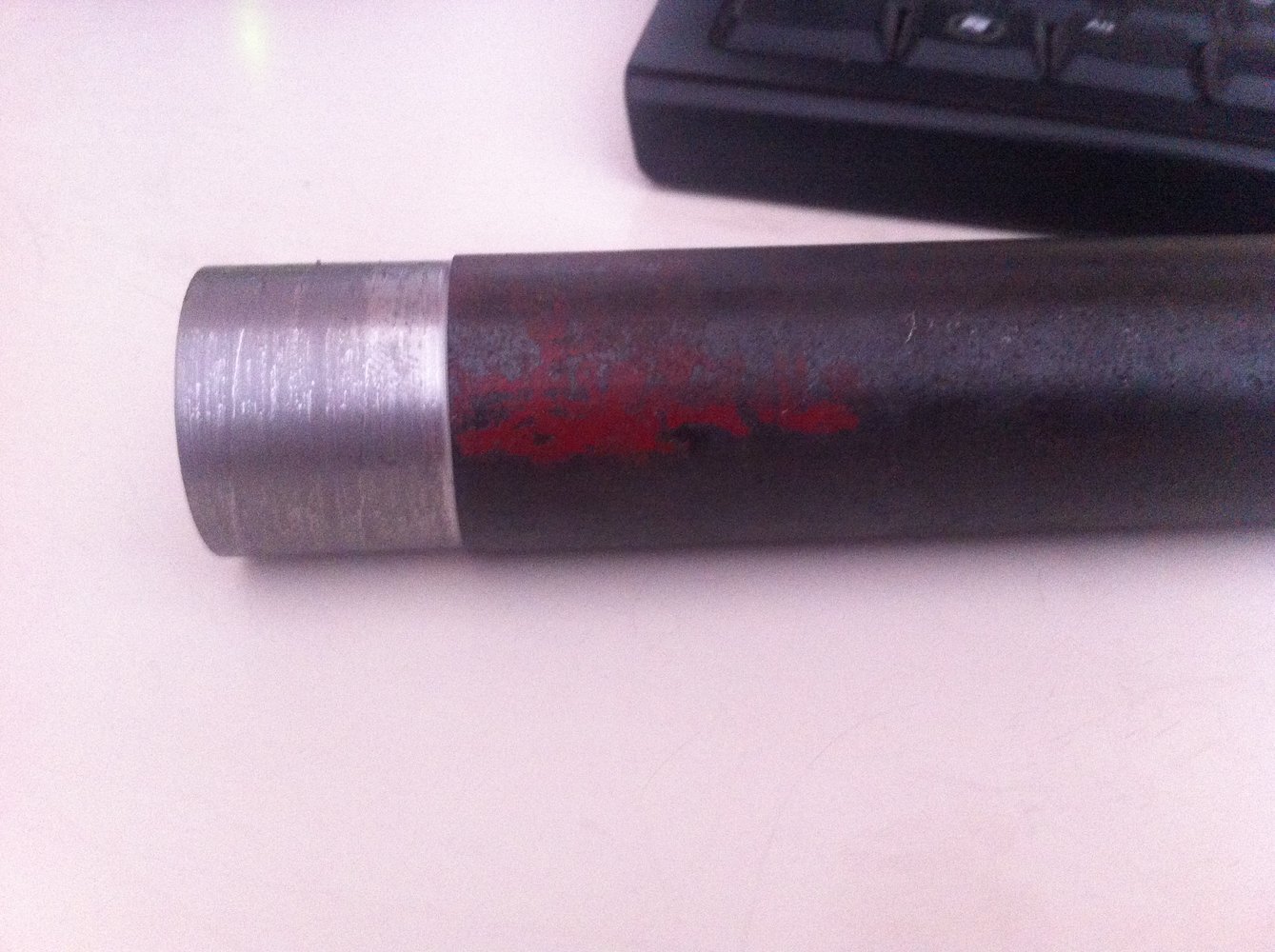

I am turning a bit of bar i have that i thought was cast Iron as its black and has a red paint streak along its length. Its not turning like CI though, long strings of swarf and not much black dust on the tool tip. Any idea what it is ?
Ni-Resist is a cast iron & nickel alloy with an austenitic structure matrix. It offers superb resistance to heat, corrosion & wear without being magnetic.
